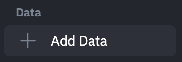

Use the Add Data portal in the product to get the Observe Agent installed in your environment.
Add Data portal
