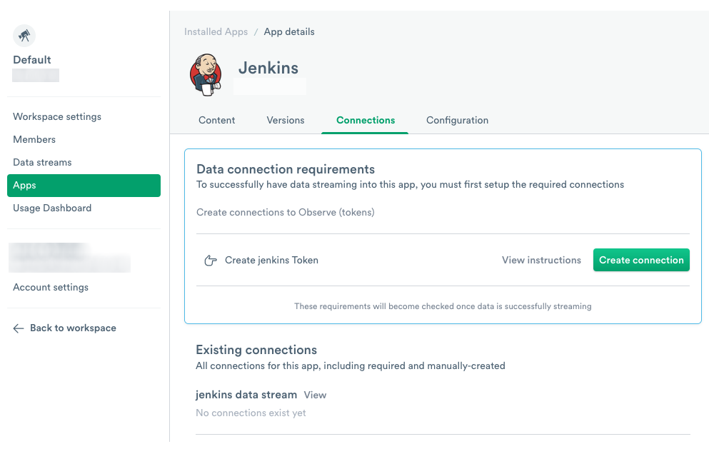

Install the Jenkins App for Observe using the App section under Workspace Setting.
Figure 1 - Jenkins app card

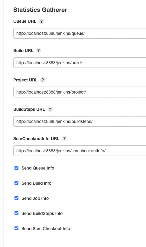

- Configure the following fields, using the URLs below:   - Figure 2 - Jenkins URLs - Queue URL: http://localhost:8888/jenkins/queue/ Build URL: http://localhost:8888/jenkins/build/ Project URL: http://localhost:8888/jenkins/project/ BuildSteps URL: http://localhost:8888/jenkins/buildsteps/ ScmCheckoutInfo URL: http://localhost:8888/jenkins/scmcheckoutInfo/

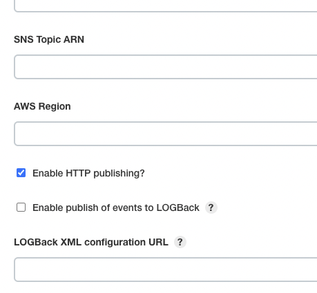

- Select Advanced Settings and enable HTTP publishing
Figure 3 - Configured Statistics Gatherer Advanced Section Example
