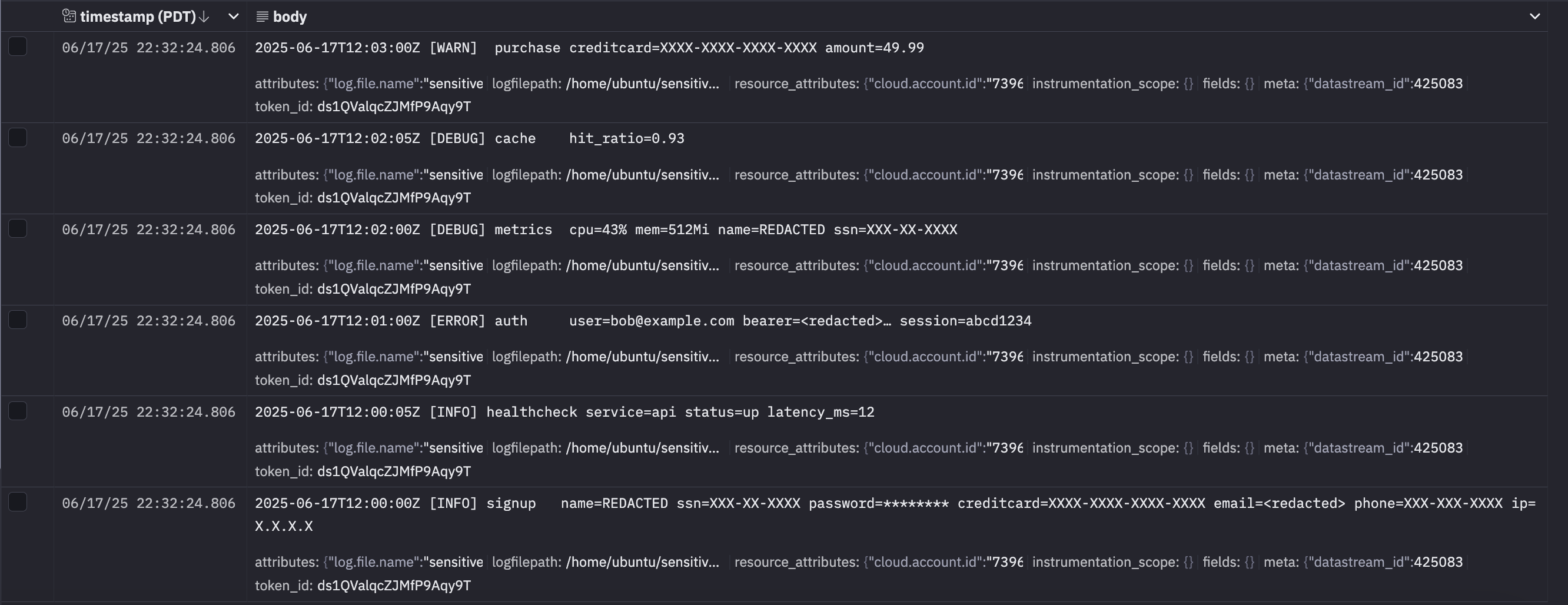

Start or reload the Observe Agent with this override and any sensitive fields will appear masked in Observe.
