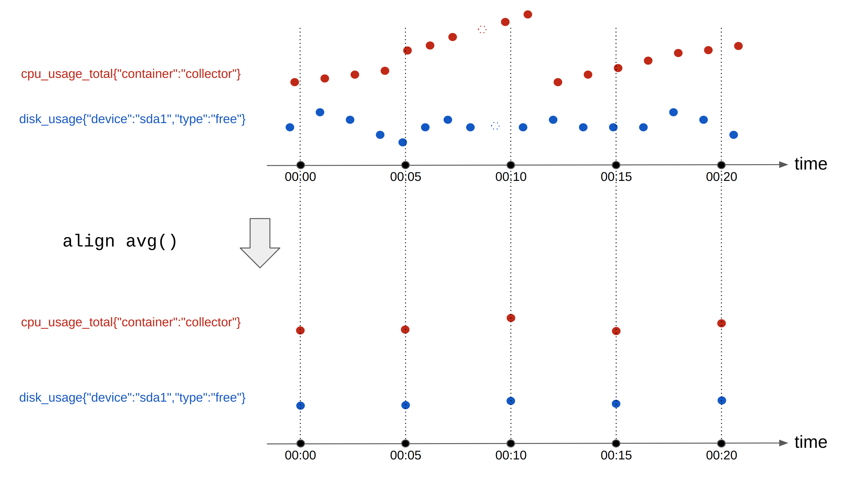

Aggregation along the time dimension (alignment)
Metrics are usually very dense (contain lots of measurements at a high frequency). It is often useful to visualize a metric over time at more user friendly intervals. For example, disk usage metrics might have one value every 5 seconds, and we might want to plot such usage over the Black Friday week. Therefore, the ideal plotting format would be to have disk usage summaries every 10 minutes.
A typical alignment operation looks like this:
You can see that each cpu_usage_total point is not exactly vertically aligned with each disk_usage point. Before we can aggregate the data, we take the three red points between 00:00 and 00:05 and average them on the 00:05 line, then take the four blue points between 00:00 and 00:05 and average them on the 00:05 line. This is repeated for each interval, so we now have alignment on the average values.
In addition to using avg() for alignment, you can also use other functions, such as the following:

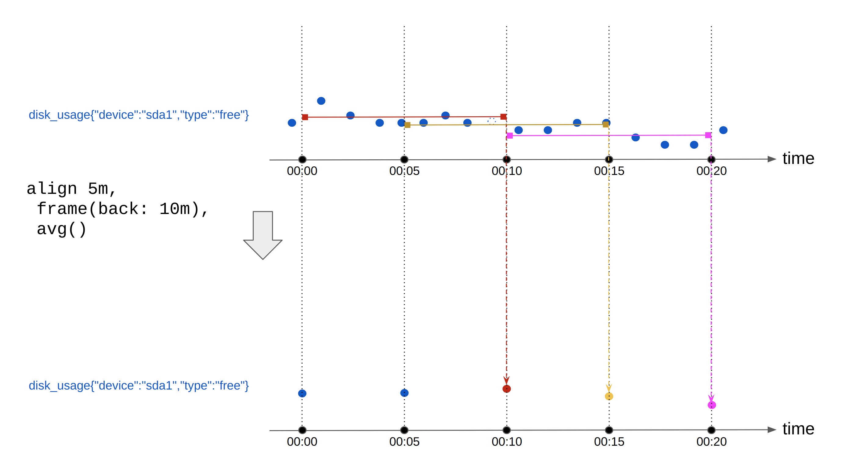

A more advanced version of alignment is sliding window alignment, also known as hopping window alignment. It is used for computations like “rolling average”. In this query, for each time-series, we generate one output point every 5 minutes, by computing the average of the input points in the prior 10 minutes. For example:

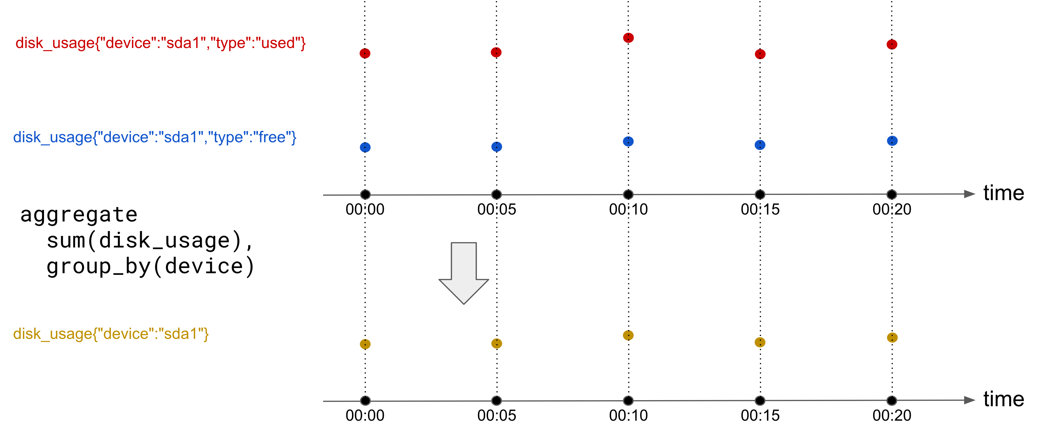

Aggregation along other dimensions
Time series can be aggregated across tags. For instance, consider the same metric disk_usage being reported for different usage types, such as free or used. You can add them up to get the total disk space.
To accomplish this, use a tag-dimension aggregation operation that aggregates multiple (already aligned) time series into one. Tag-dimension aggregation takes in regularly aligned time series, and keeps the timestamps unchanged. Aggregation across tags also requires an aggregation function to be specified.
Conceptually, tag-dimension aggregation looks like this:
