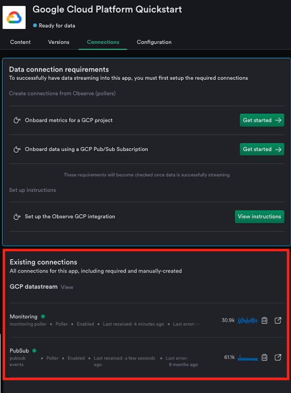

- In Observe by Snowflake, open the Google Cloud Platform Quickstart app.
- Click the Connections tab.

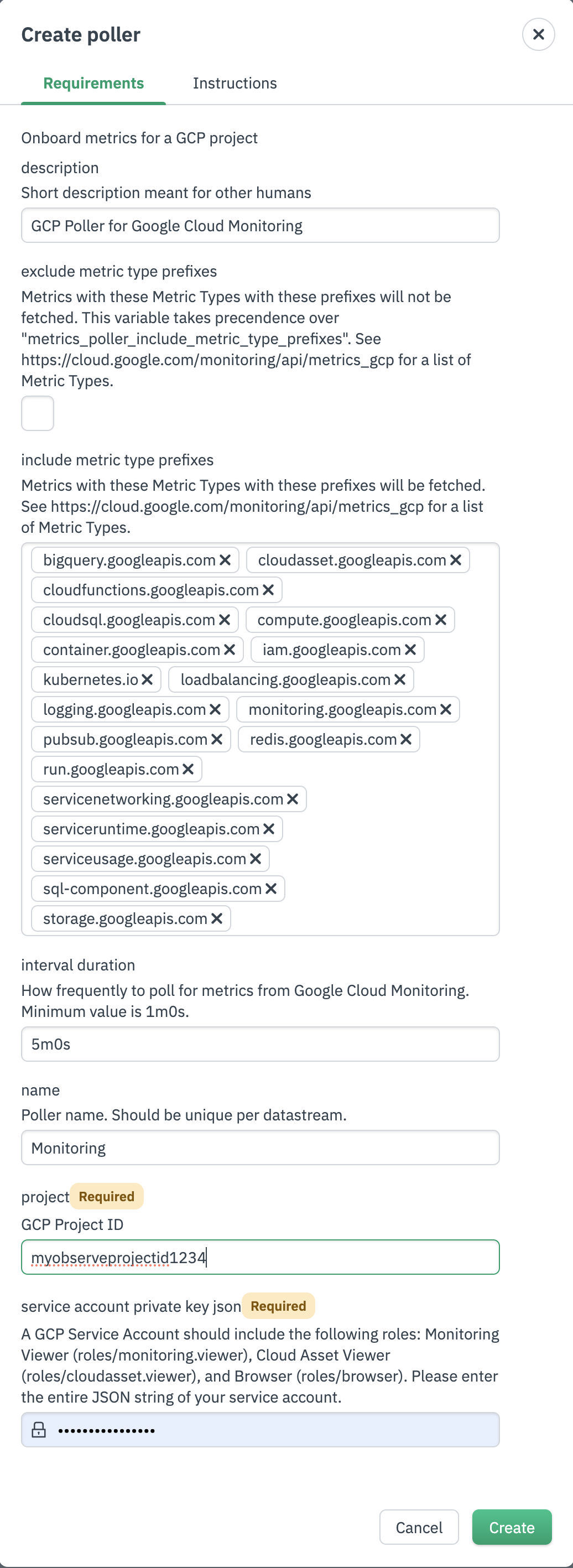

- Click Get started next to Onboard metrics for a GCP project to begin creating a poller.
- Enter your Google Project ID in the GCP Project ID field.
- In the Service Account Private Key JSON field, enter the entire JSON string you either generated with Terraform or downloaded from the GCP Console.
- Click Create.

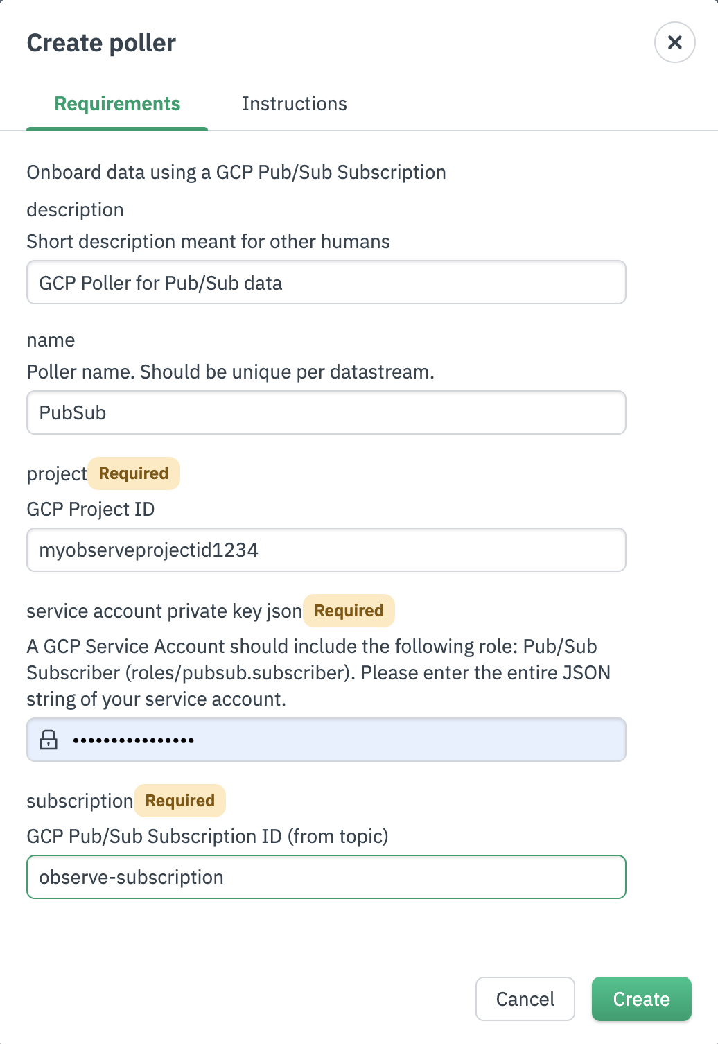

- From the Connections tab in the Google Cloud Platform Quickstart app, click Get started next to Onboard data using a GCP Pub/Sub Subscription.
- In the GCP Pub/Sub Subscription field, enter the subscription name you saved in your configuration with Terraform or downloaded from the GCP Console.
- Click Create.
- Return to the app and look under Existing connections to verify that Observe by Snowflake is receiving data from Google Cloud Platform.
