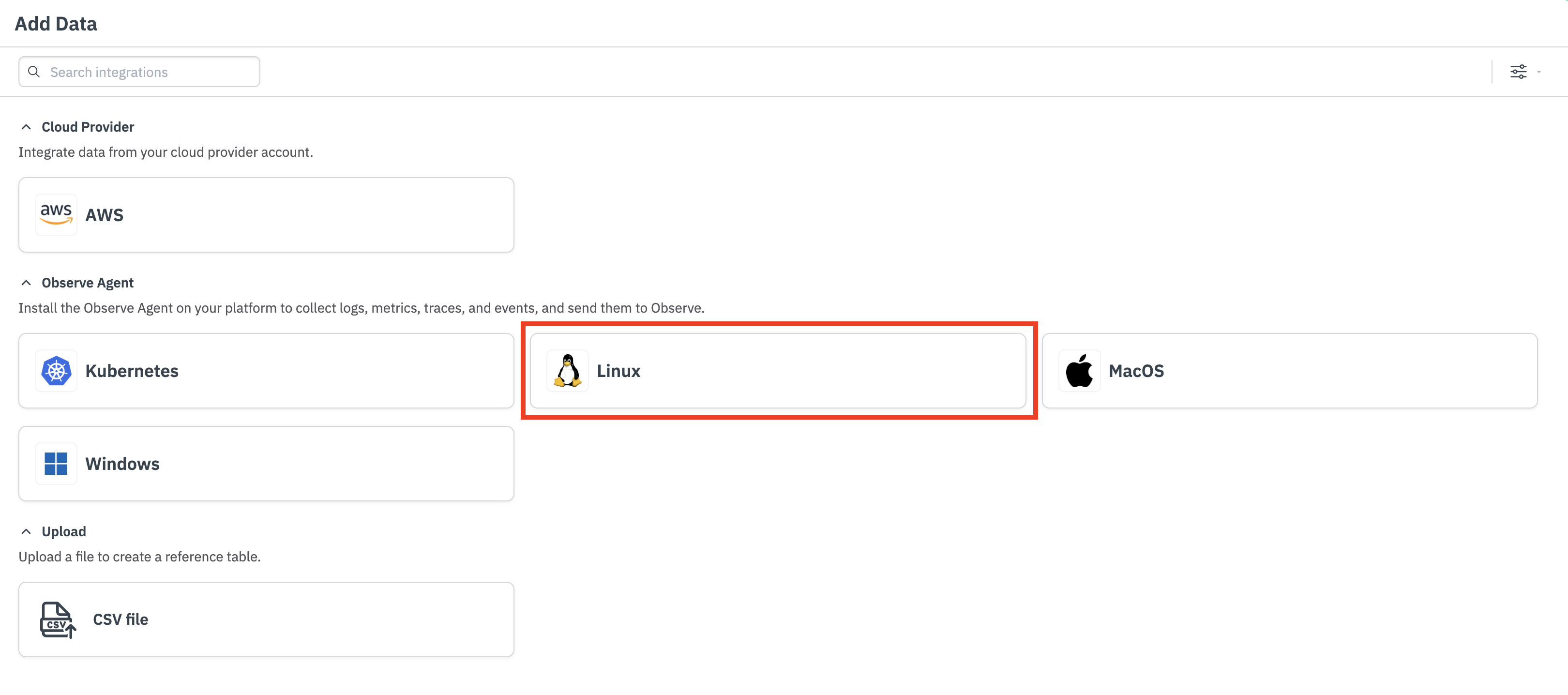

OBSERVE_URLmust point tohttps://<OBSERVE_CUSTOMER>.collect.observeinc.com.TOKENmust point to an ingest token created through the Add Data portal.
NoteThere is no Docker option in the Add Data portal, so choose Linux in order to create your data ingest token.
