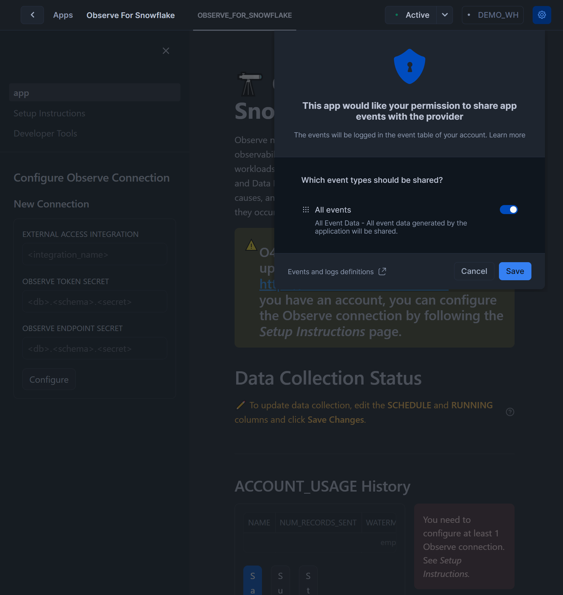

- Log into your Snowflake instance in Snowsight console.
- Change to the ACCOUNTADMIN role.
- Navigate to Data Products\Apps.
- Click the Observe for Snowflake app.
- Click the Settings gear icon.

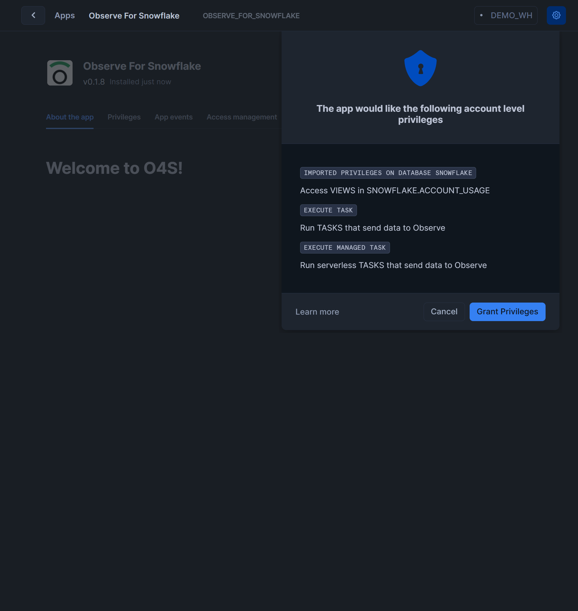

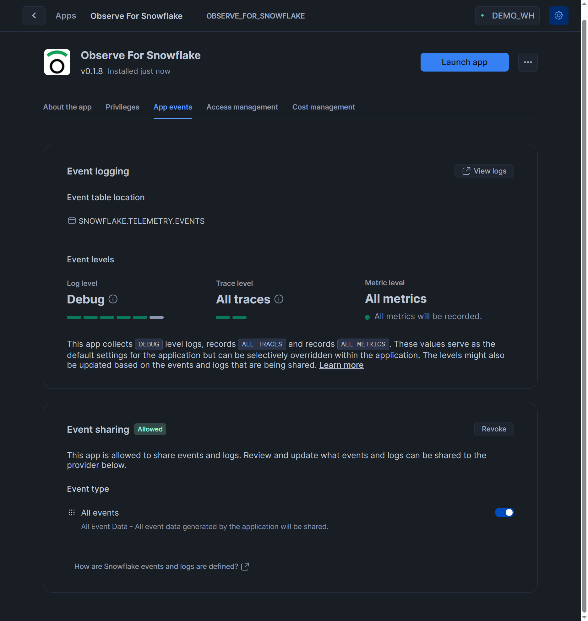

- If prompted, turn on All events to be shared with application provider and click Save.
- If prompted, grant requested IMPORTED PRIVILEGES ON DATABASE SNOWFLAKE, EXECUTE TASK and EXECUTE MANAGED TASK privileges by clicking Grant Privileges:

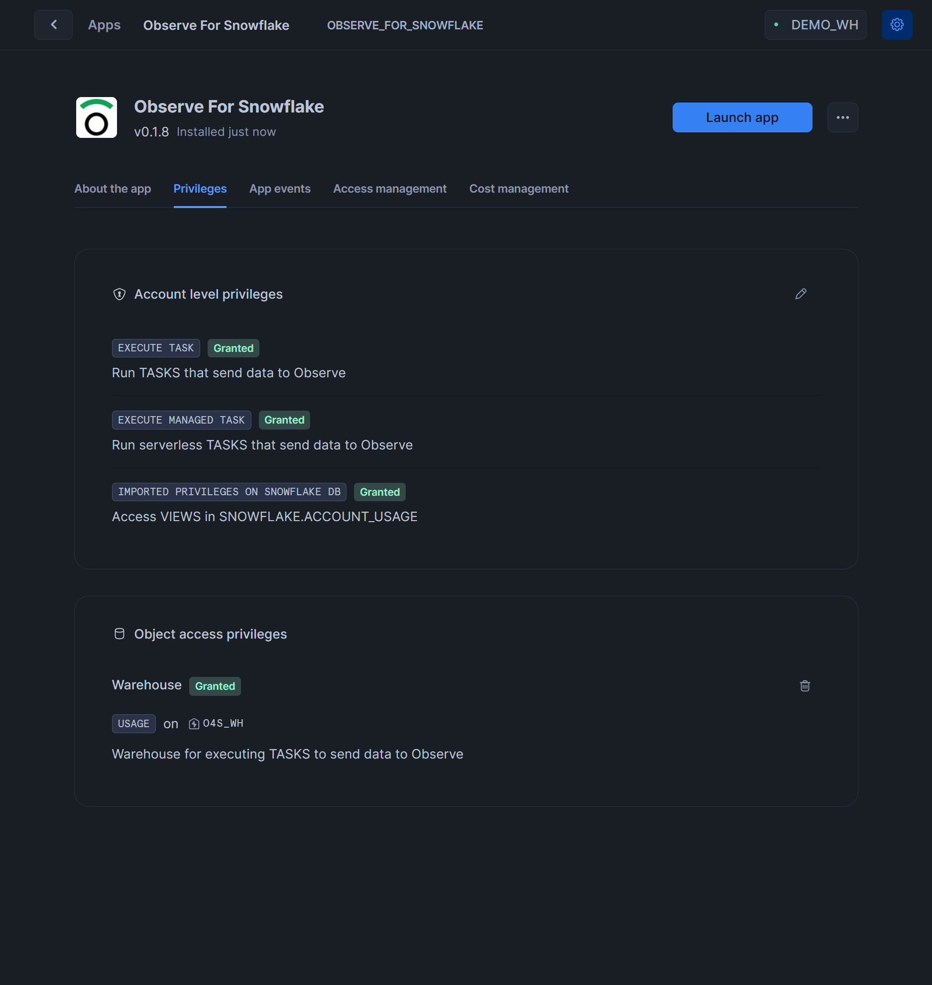

- Click the Privileges tab.

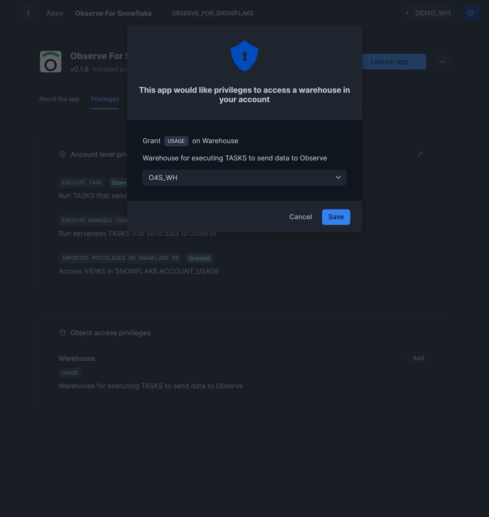

- Under Object access privileges, click Add.
- Select virtual warehouse you’ve created before (O4S_WH).
- Click Save.
- The final configuration on Privileges tab should look like the following:
- The final configuration on App Events tab should look like the following:

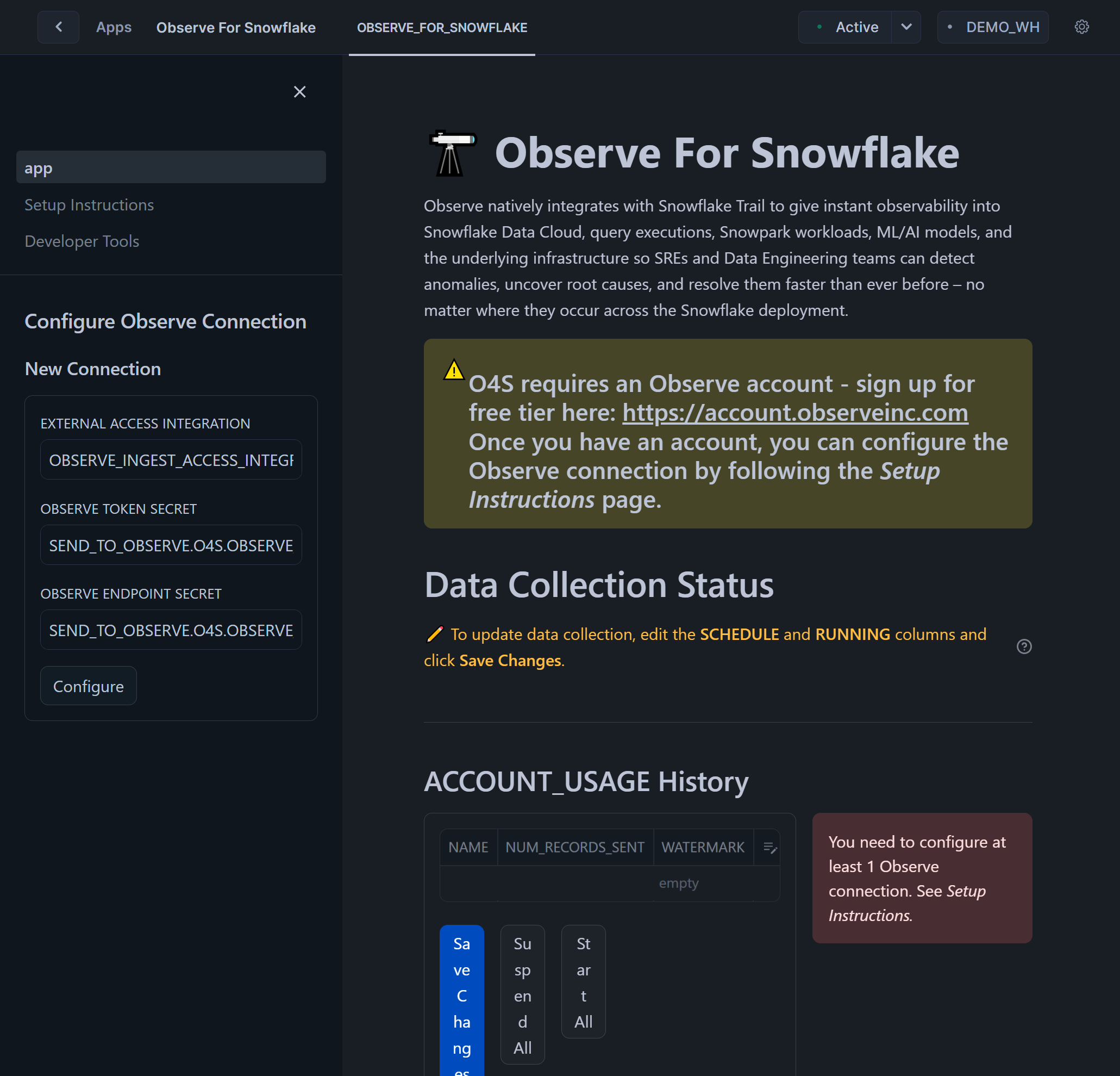

- In Configure Observe Connection on the left, specify the previously created objects:
OBSERVE_INGEST_ACCESS_INTEGRATIONfor EXTERNAL ACCESS INTEGRATIONSEND_TO_OBSERVE.O4S.OBSERVE_TOKENfor OBSERVE TOKEN SECRETSEND_TO_OBSERVE.O4S.OBSERVE_ENDPOINTfor OBSERVE ENDPOINT SECRET
- Click Configure:

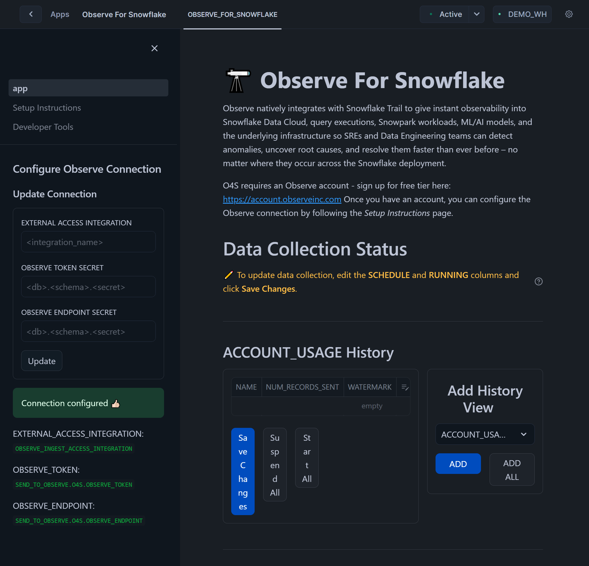

- Results of successful configuration should look like the following:

-- [ Streamlit UI ]
-- Step 8: Configure the connection to send to observe via external access integration
-- variables to replace below: <secret_db>, <secret_schema>, <token_string>, <endpoint_string>
USE ROLE ACCOUNTADMIN;
USE APPLICATION OBSERVE_FOR_SNOWFLAKE;
CALL OBSERVE_FOR_SNOWFLAKE.PUBLIC.PROVISION_CONNECTOR(
PARSE_JSON('{"observe_token": "<secret_db>.<secret_schema>.OBSERVE_TOKEN",
"observe_endpoint": "<secret_db>.<secret_schema>.OBSERVE_ENDPOINT",
"external_access_integration": "OBSERVE_INGEST_ACCESS_INTEGRATION"}')
);Updated 9 months ago
