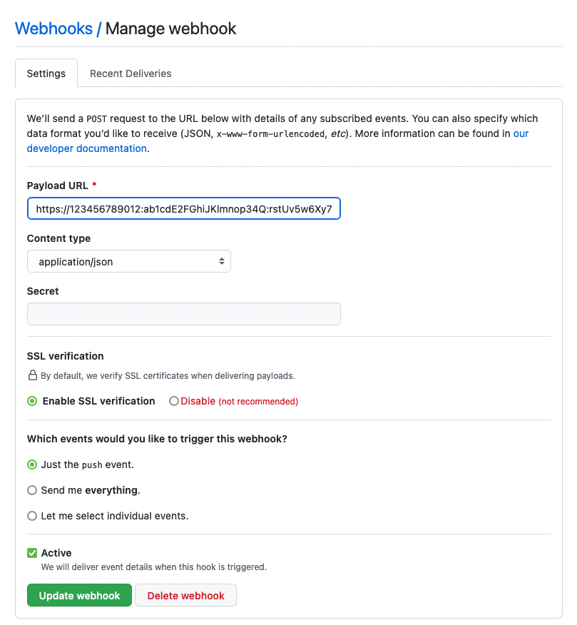

Set up the webhook
For a repository or organization, go to Settings.
Click Webhooks and then Add
Add the Payload URL to the Observe by Snowflake collector using basic authentication. Replace
${OBSERVE_CUSTOMER_ID}and${OBSERVE_TOKEN}with your Customer ID and Ingest Token respectively.https://{OBSERVE_CUSTOMER_ID}:{OBSERVE_TOKEN}@collect.observeinc.com/v1/http
Your URL should look like the following example:
`https://123456789012:ab1cdE2FGhiJKlmnop34Q:[email protected]/v1/http
Select the Content Type as
application/json. -
Leave Secret blank. Observe by Snowflake does not use this value.
Enable SSL verification.
Select the type of events you want to trigger the Webhook. Typically, you want to select Just the push event. Be sure to check with your Observe by Snowflake data engineer for any out-of-the-box content to be sent to Observe by Snowflake.
Click Add Webhook.
