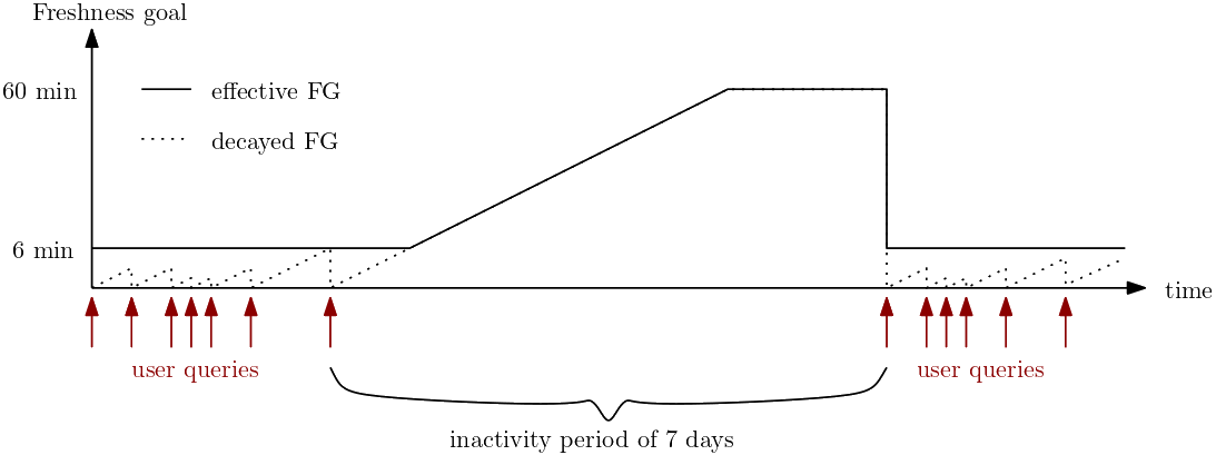

Freshness decay
Freshness decay is a cost-saving feature that gradually loosens the freshness goal to 1 hour whenever a Dataset isn't queried for a while. Freshness decay is instrumental in saving transform credits as the frequency of transform queries is one of the main drivers of their cost (see above).
When a freshness goal has decayed beyond the configured goal and a Dataset is queried, the freshness goal is immediately reset to the original value. If necessary, that triggers a catch-up transform. As a result, the very first query on a decayed Dataset may see data that can be up to one hour stale. But subsequent queries will see new data again as soon as the transform queries have finished.
This example shows where the freshness goal (solid line) changes in response to the absence of queries by users. The freshness goal, which is configured to be 6 minutes, decays at a rate of 1 minute per hour without users accessing it. The decay process starts with a freshness goal of 0, which causes the decay effect to take longer on Datasets with looser goals. In this example, the six minute configured freshness goal is tighter than the decayed goal for 6 hours after the last user query. At the 7th hour, the effective freshness goal exceeds the original freshness goal. Once an effective freshness goal of 60 minutes is reached, the goal isn’t loosened anymore, as further cost savings are generally small at this point. As soon as the Dataset is queried again, the freshness goal is tightened back to its setting, and the decay level returns to zero.
