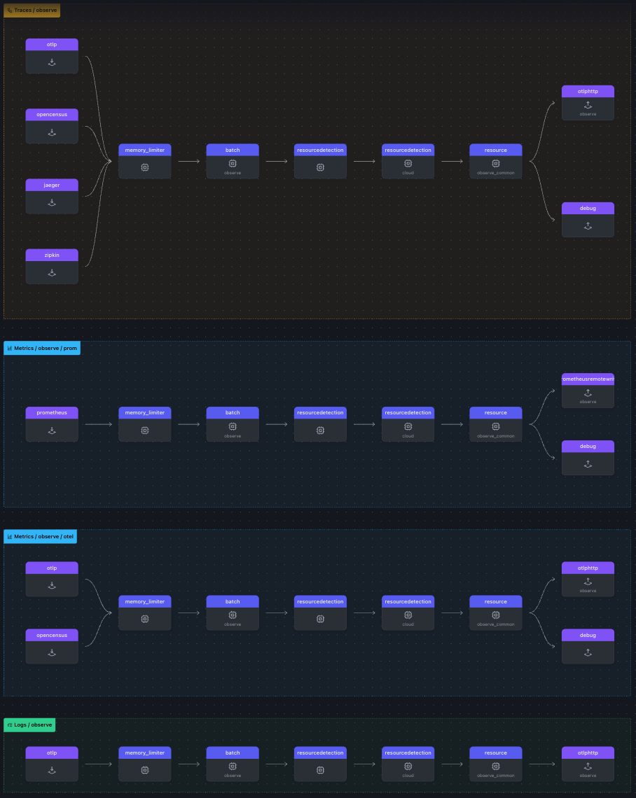

Full host example
This page provides a full example host configuration. Below is a visual representation of the config, followed by the actual config:
