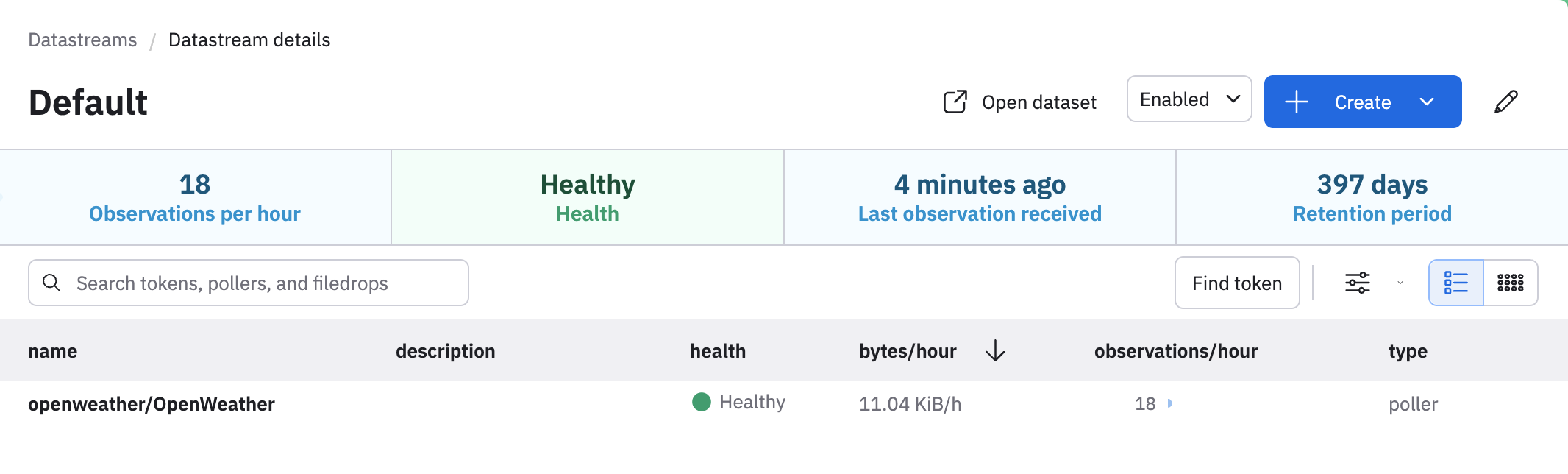

To begin modeling weather data, follow these steps to install the OpenWeather app:
- From the left navigation bar, select Data & integrations > Applications.
- Click the Install new tab.
- Locate the OpenWeather app card, and either click Install or click on the card.

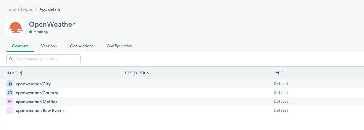

- Click Install and select the "Recommended (Easy)" option. This should take a few seconds to complete.
After the OpenWeather app successfully installs, you will see the app's content, and other information.
The OpenWeather app bundles the following predefined Datasets:
- openweather/City
- openweather/Country
- openweather/Metrics
- openweather/Raw Events

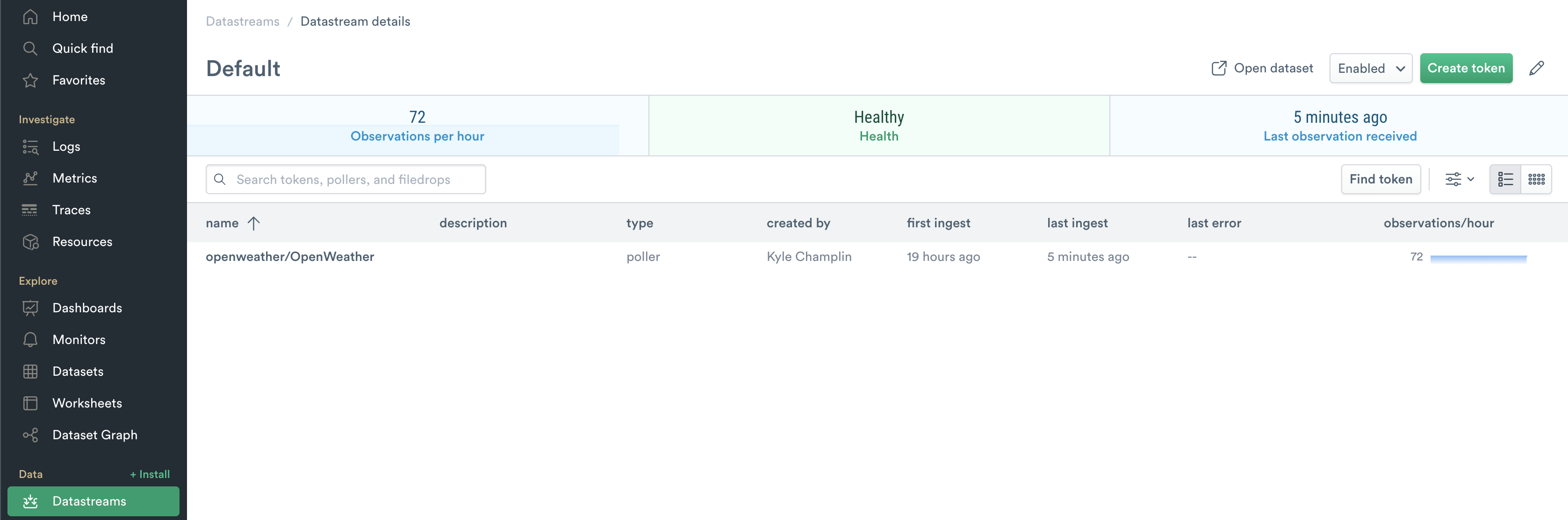

These Datasets are derived from a Datastream. When you ingest OpenWeather data, the data initially goes into the Default Datastream. This Datastream contains all the raw, unshaped data ingested into your workspace by the OpenWeather app. The app also includes a Poller that pulls new observations (events) to the Datastream regularly by polling the OpenWeather API. We will take the raw data from the Datastream and shape it into distinct Datasets.

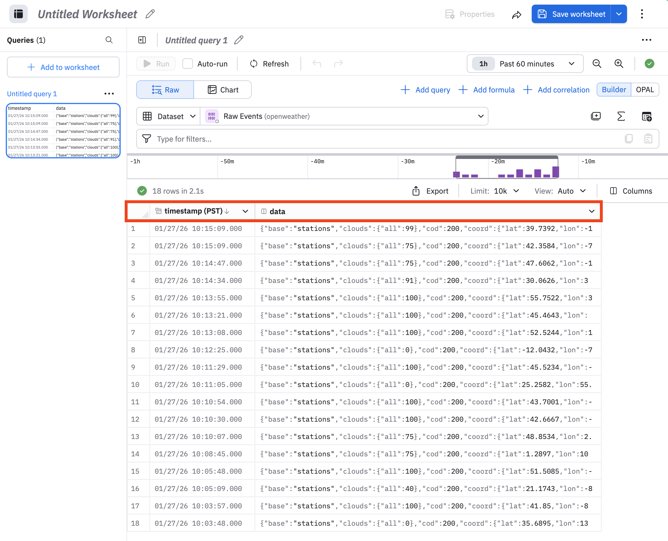

The OpenWeather app presents collected weather information in the Raw Events Dataset. We will use this Dataset to get acquainted with Worksheets.

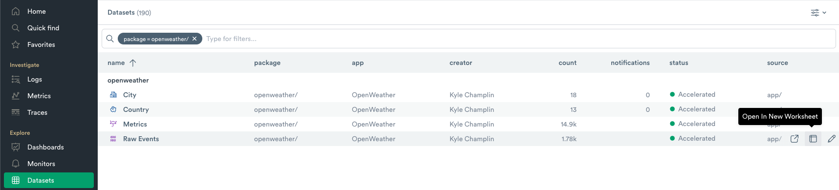

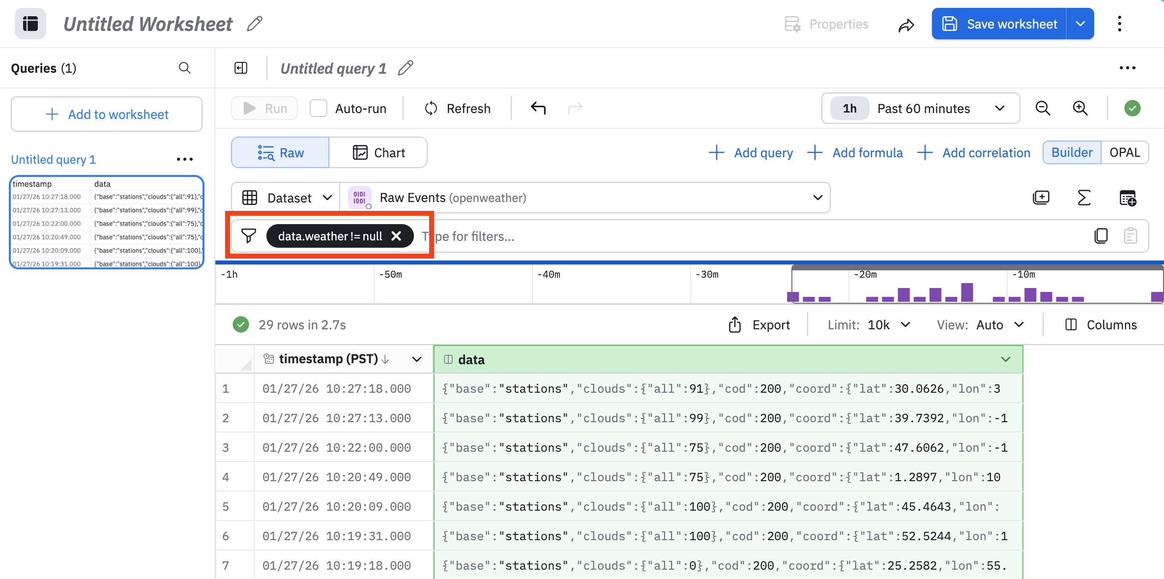

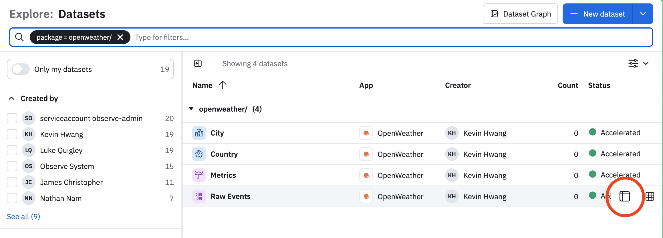

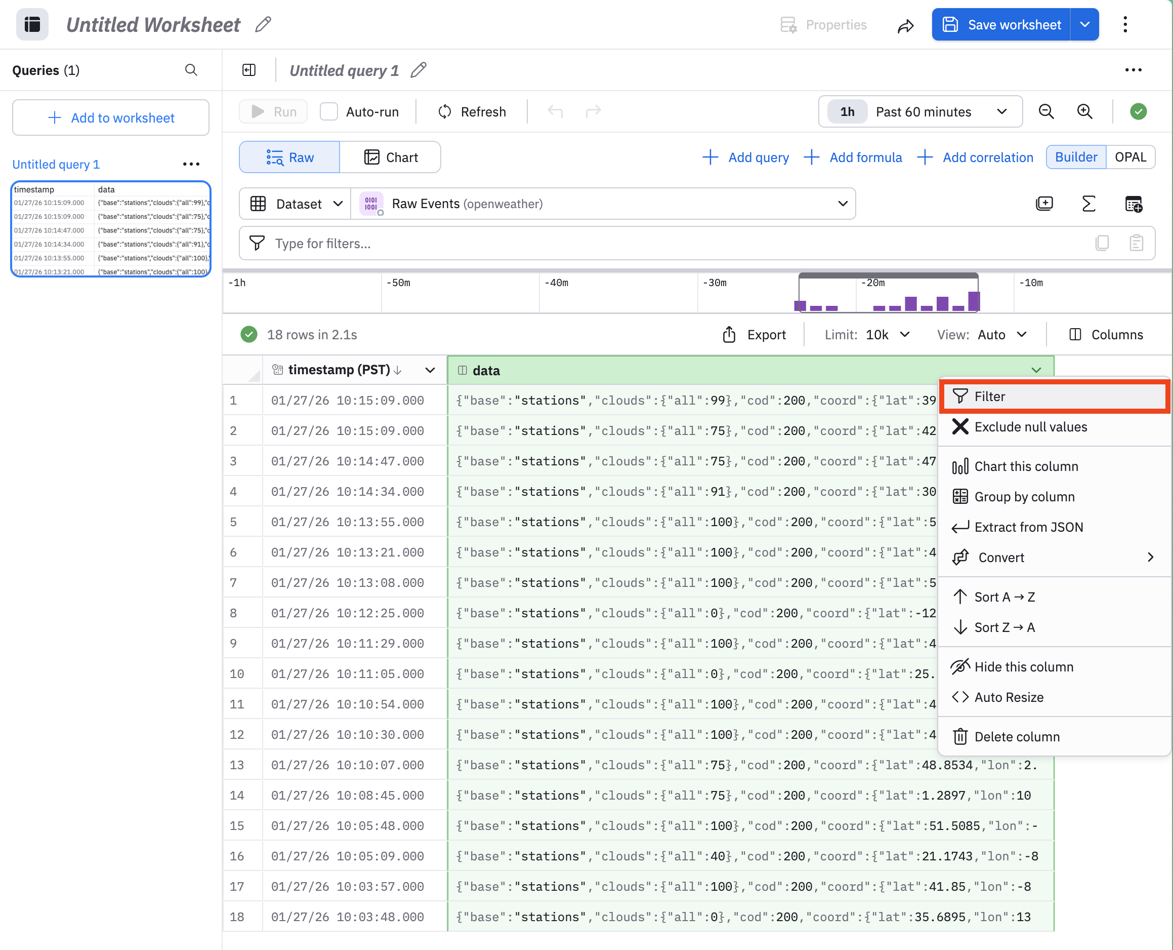

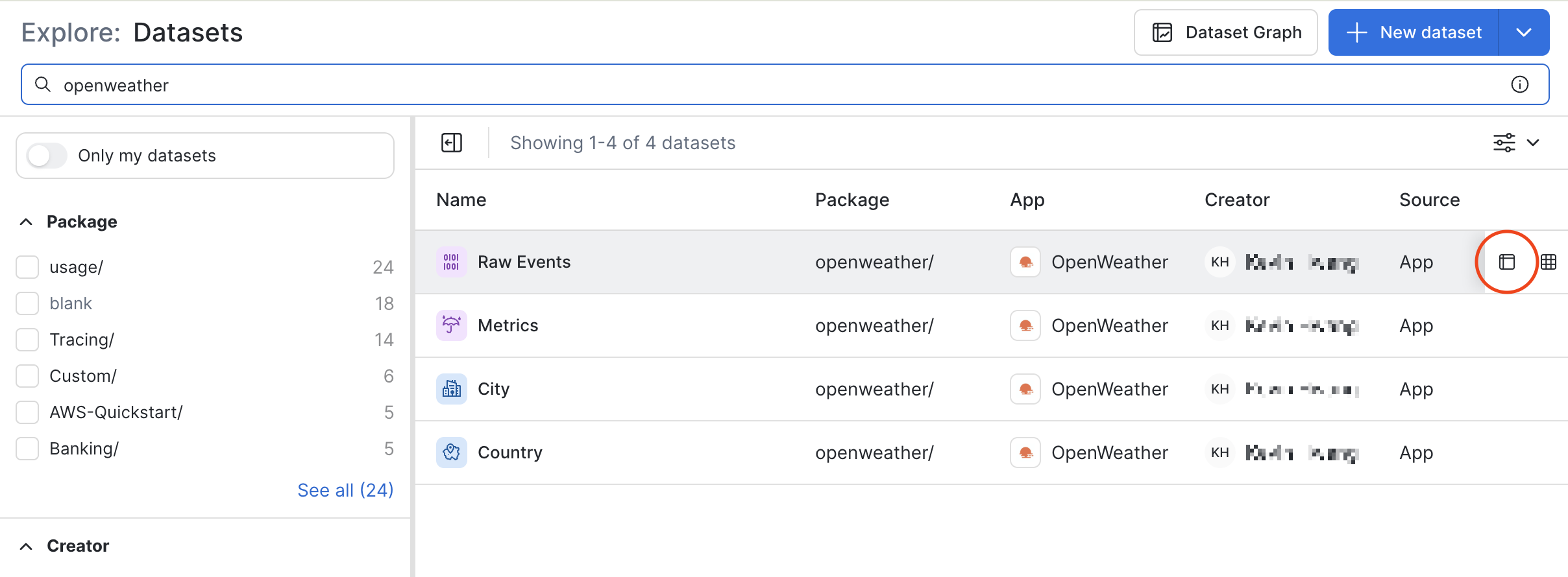

- Click Datasets in the left navigation.
- Search for openweather.

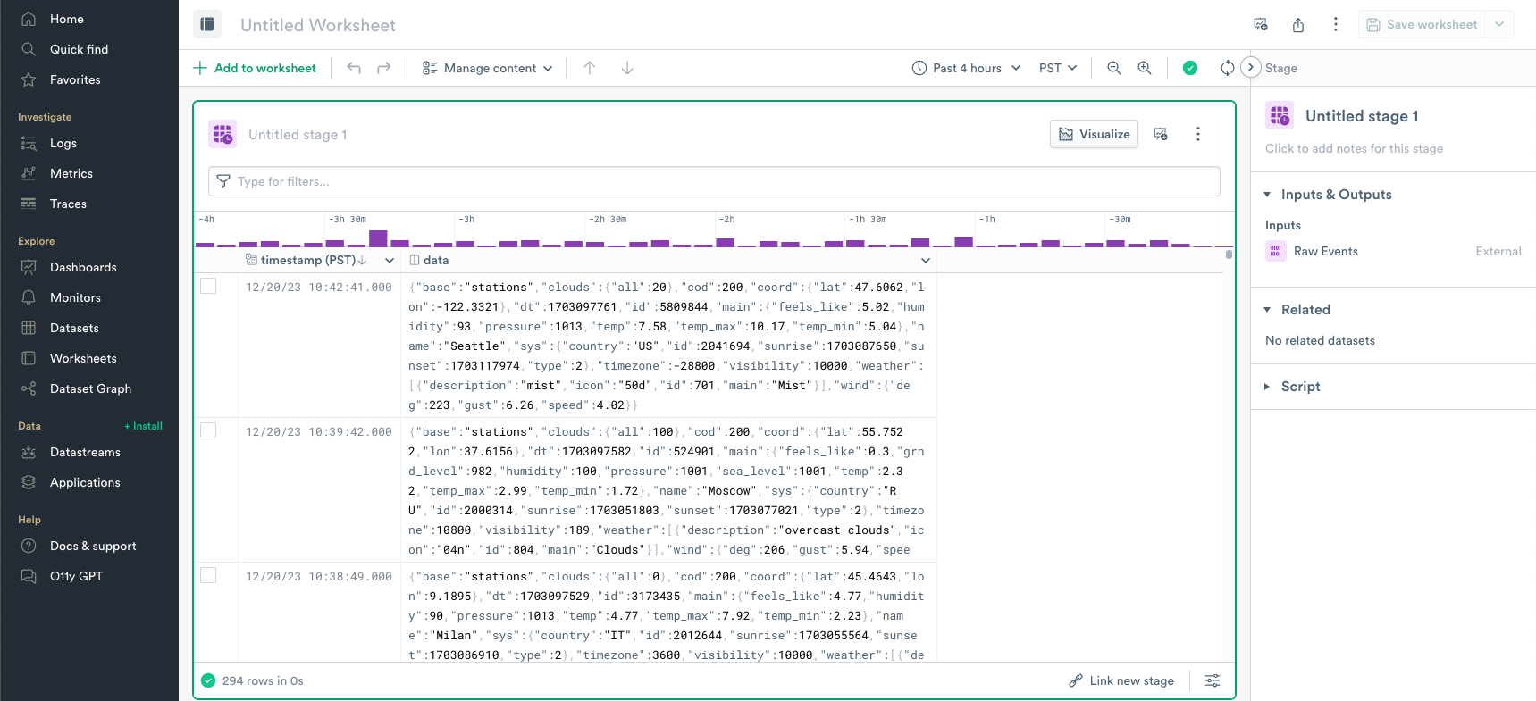

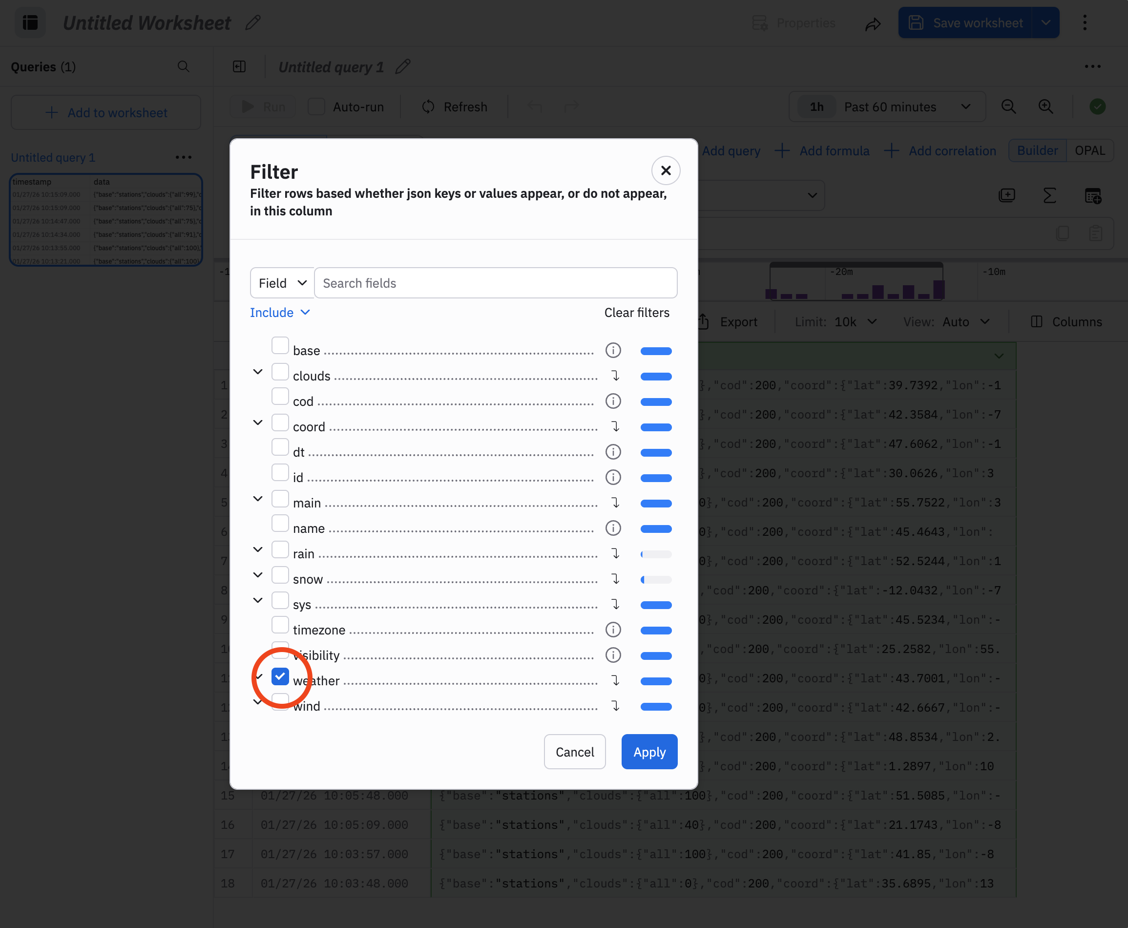

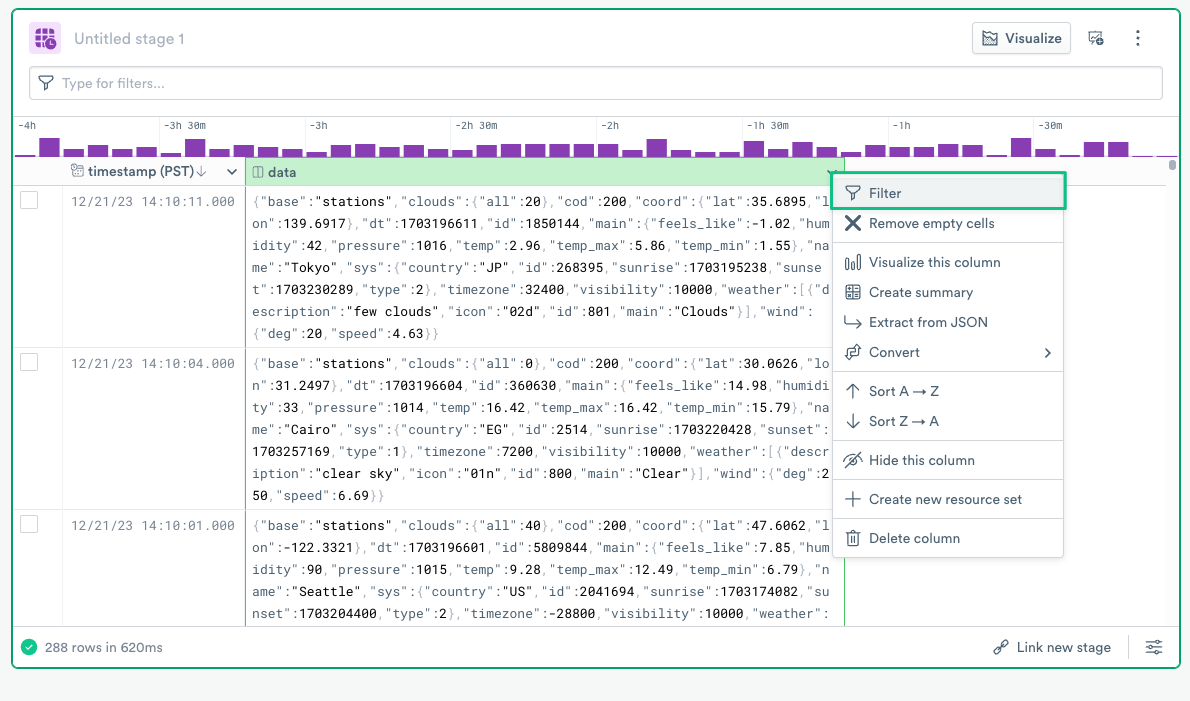

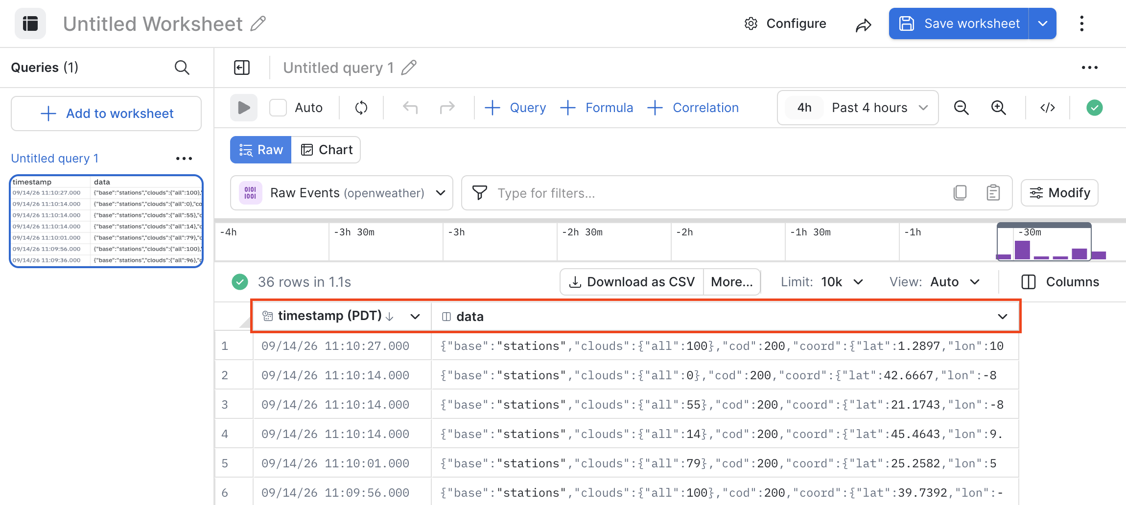

- Hover on the Raw Events Dataset row and select the Open in Worksheet icon (). If you've already opened the Raw Events Dataset, you can also click Create Worksheet.
- Once your new Worksheet is open, you should see a timestamp and data column.

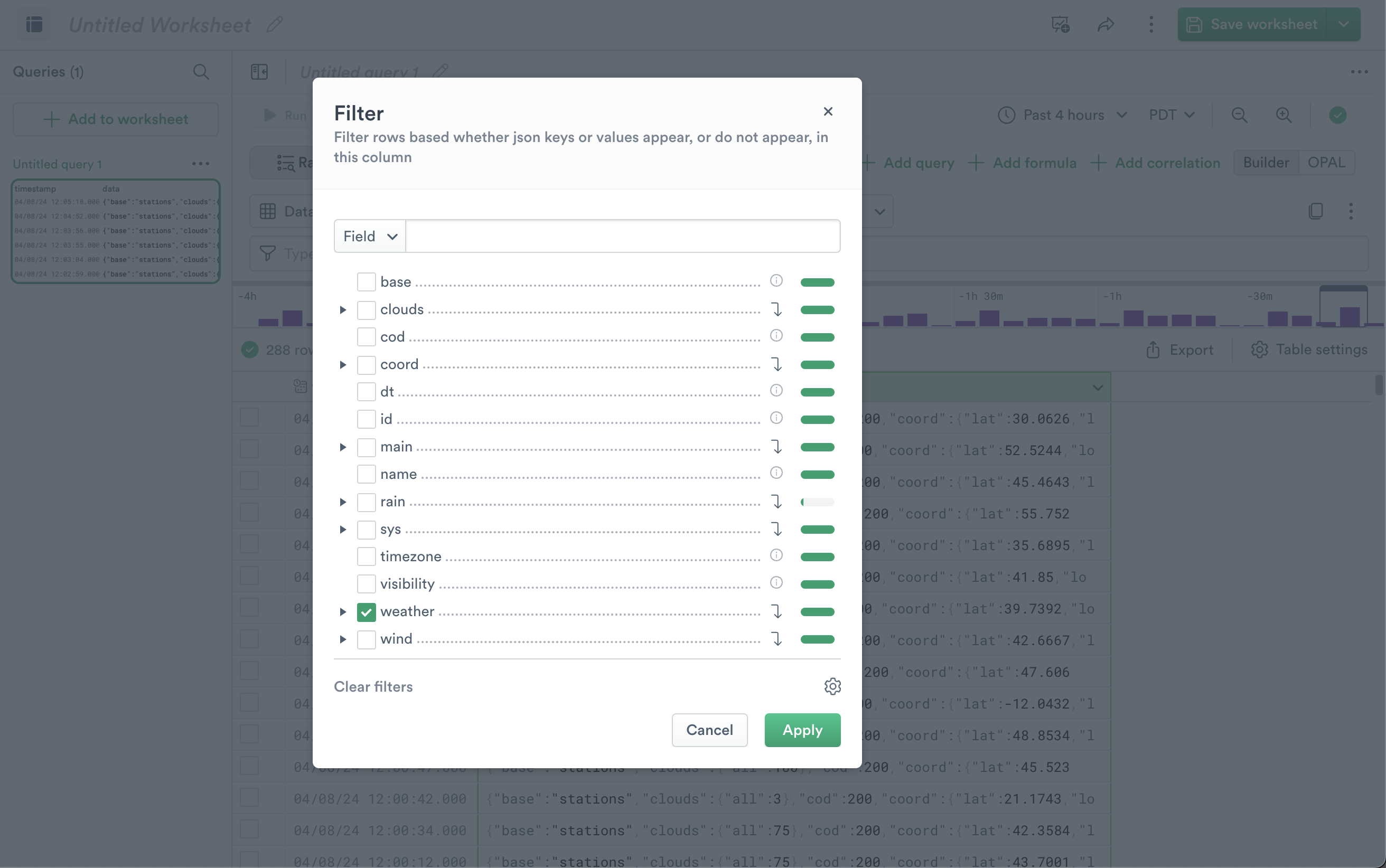

- From the data column header, click the dropdown arrow.
- Select Filter from the dropdown to display the available values.

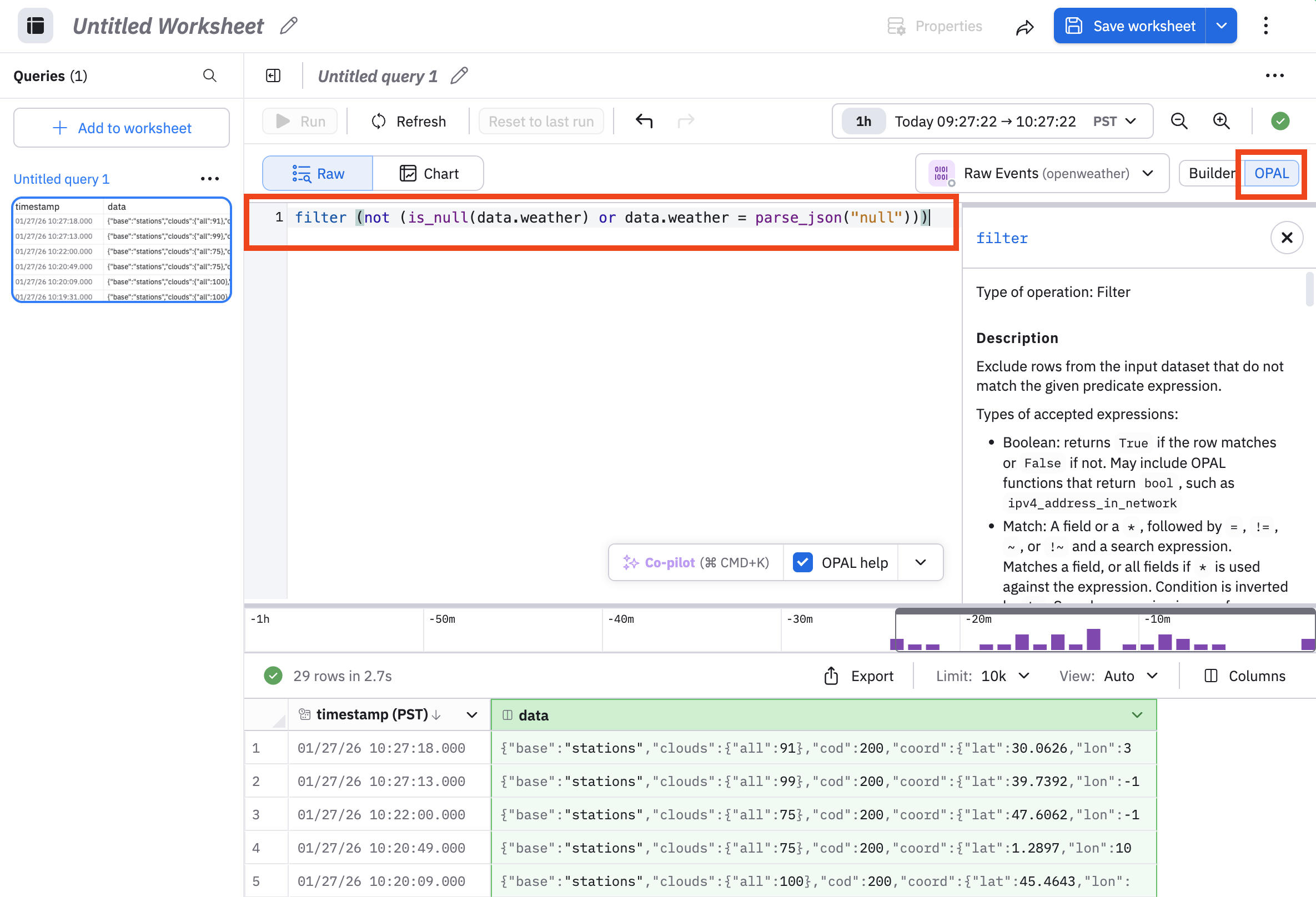

- Select weather from the Filter Rail to filter observations with only weather data and not empty fields.

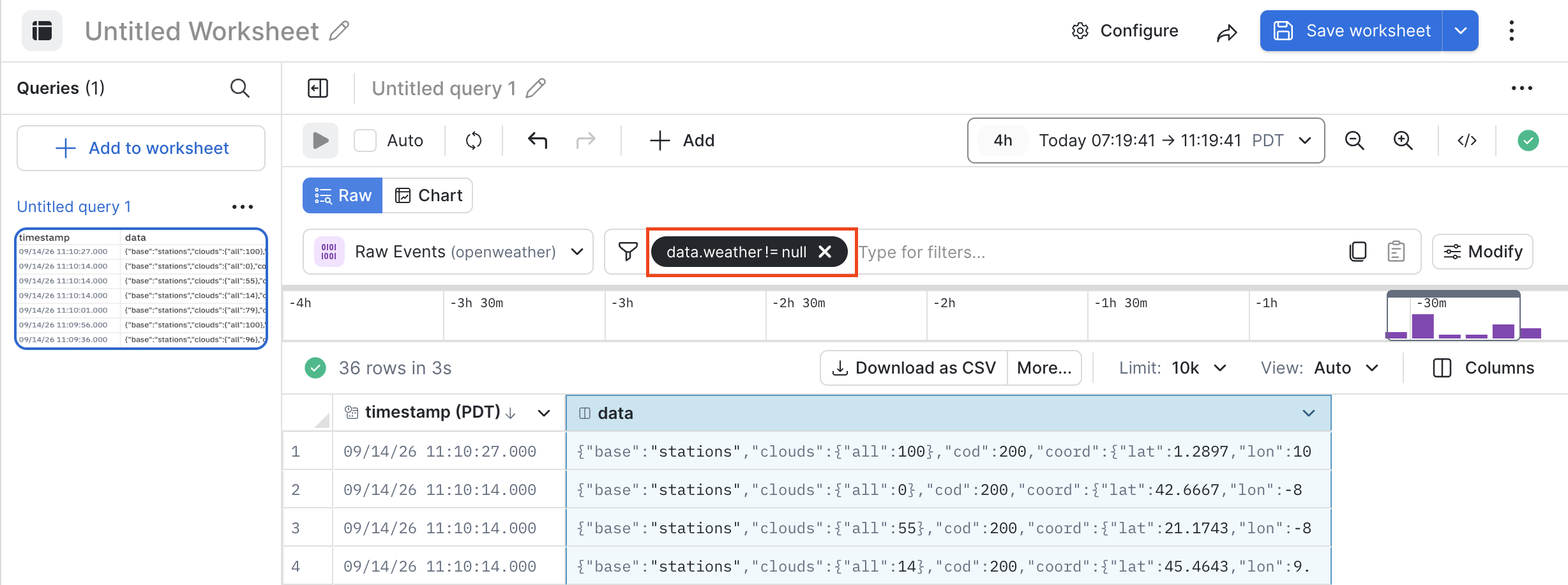

- Click Apply. In the Filter bar, OPAL console, you should now see:
data.weather != null

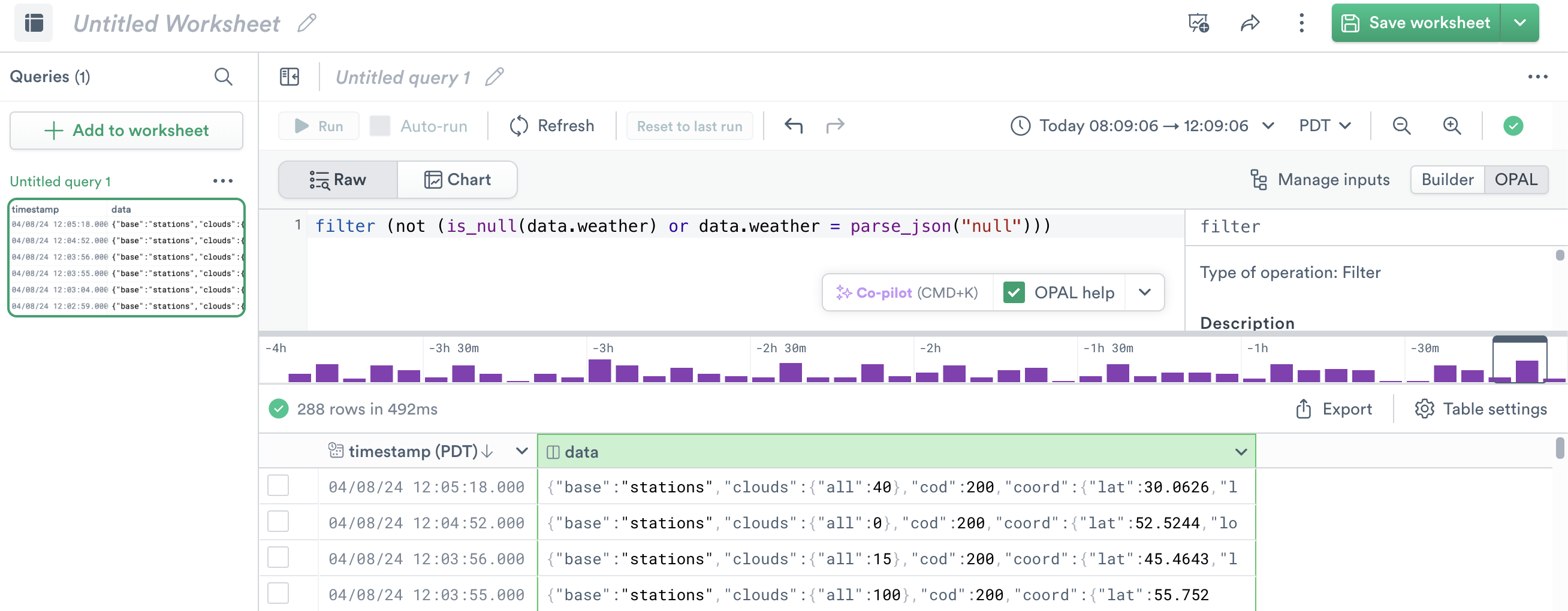

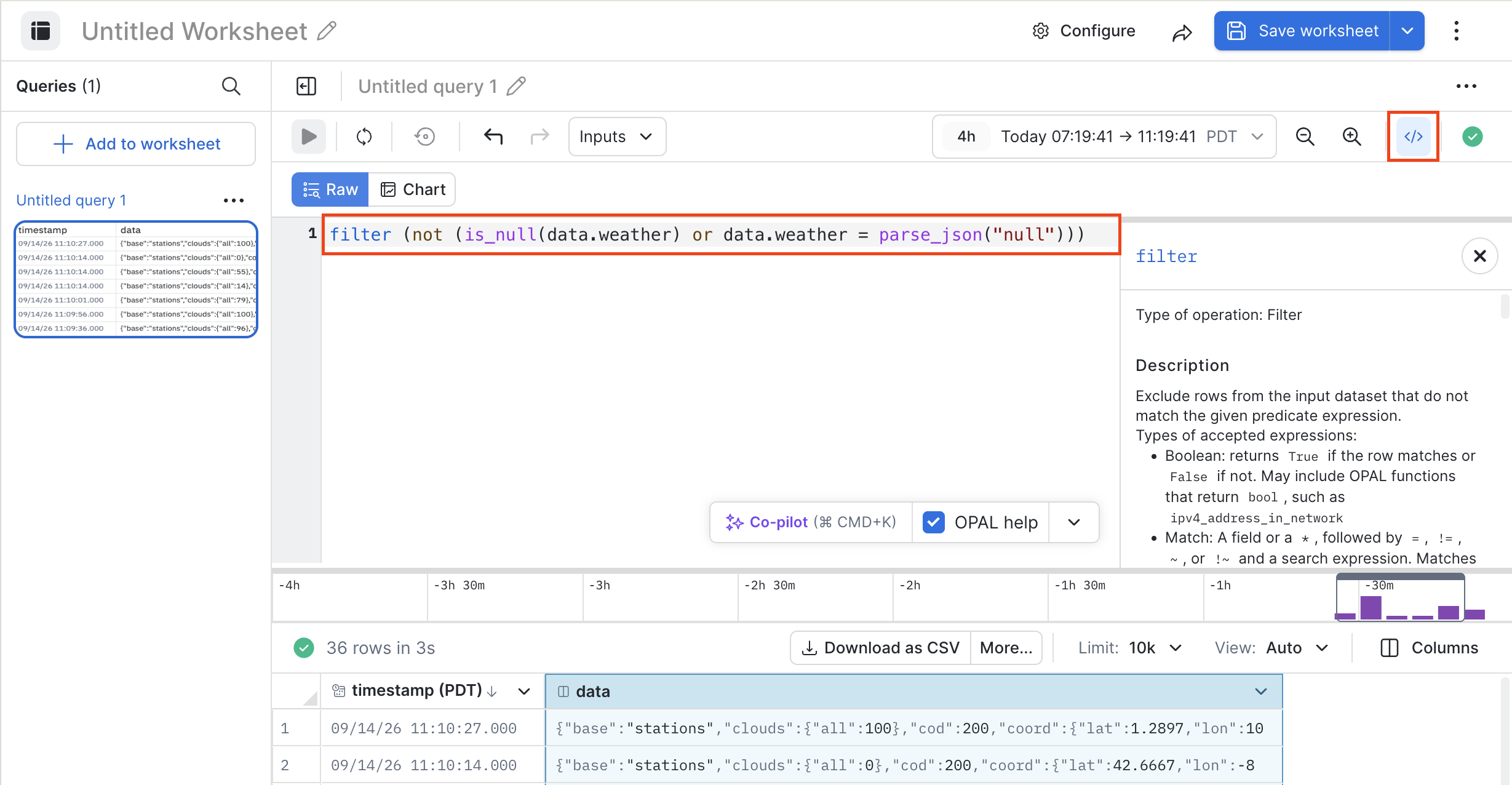

The UI generates this for you. Click the code icon () to open the OPAL Console, you will see that OPAL has also been generated for this filtering task:
filter (not (is_null(data.weather) or data.weather = parse_json("null")))
Click Builder to return to the Builder view.

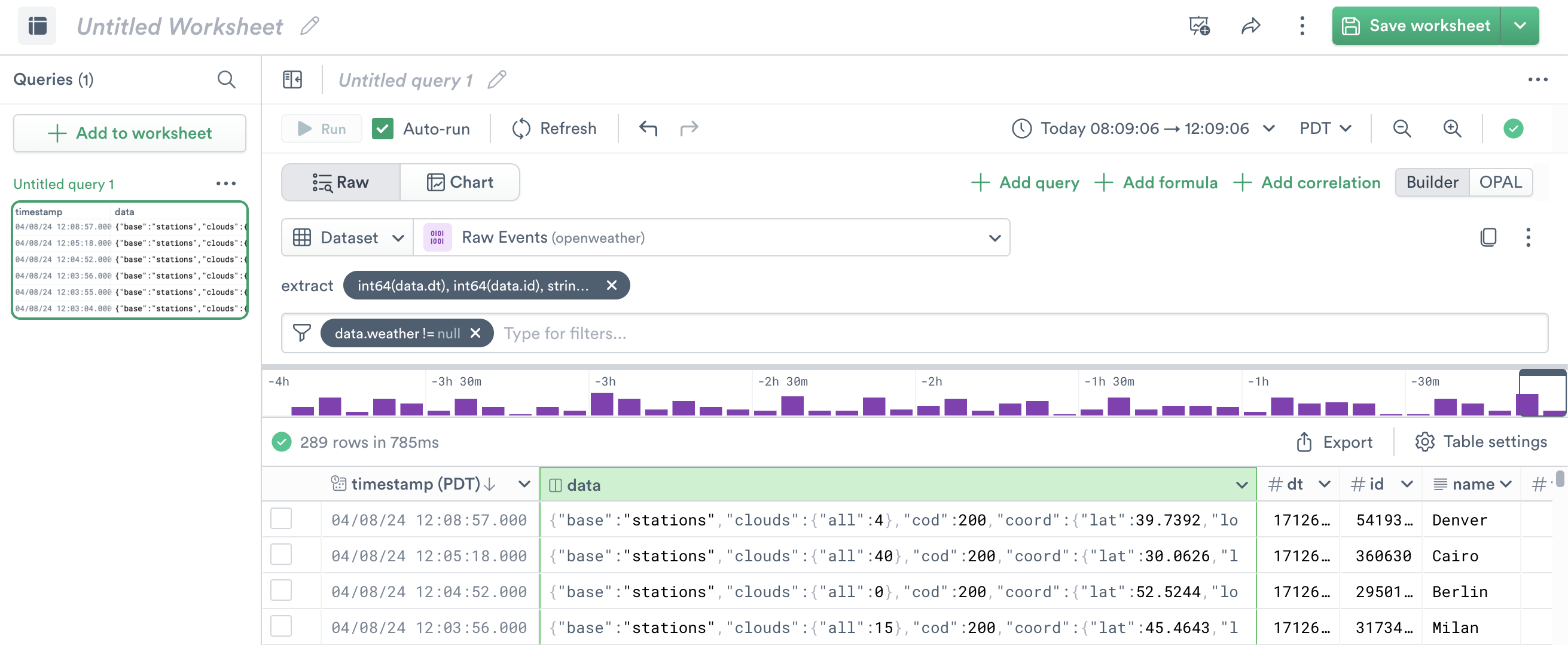

Extract fields from the JSON payload
NoteYou must perform the JSON extraction before running the rest of the OPAL script. The rest of the OPAL script performs actions on the extracted columns.

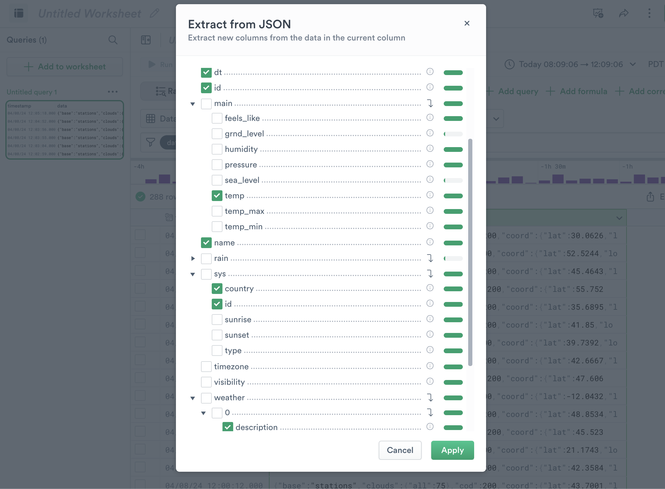

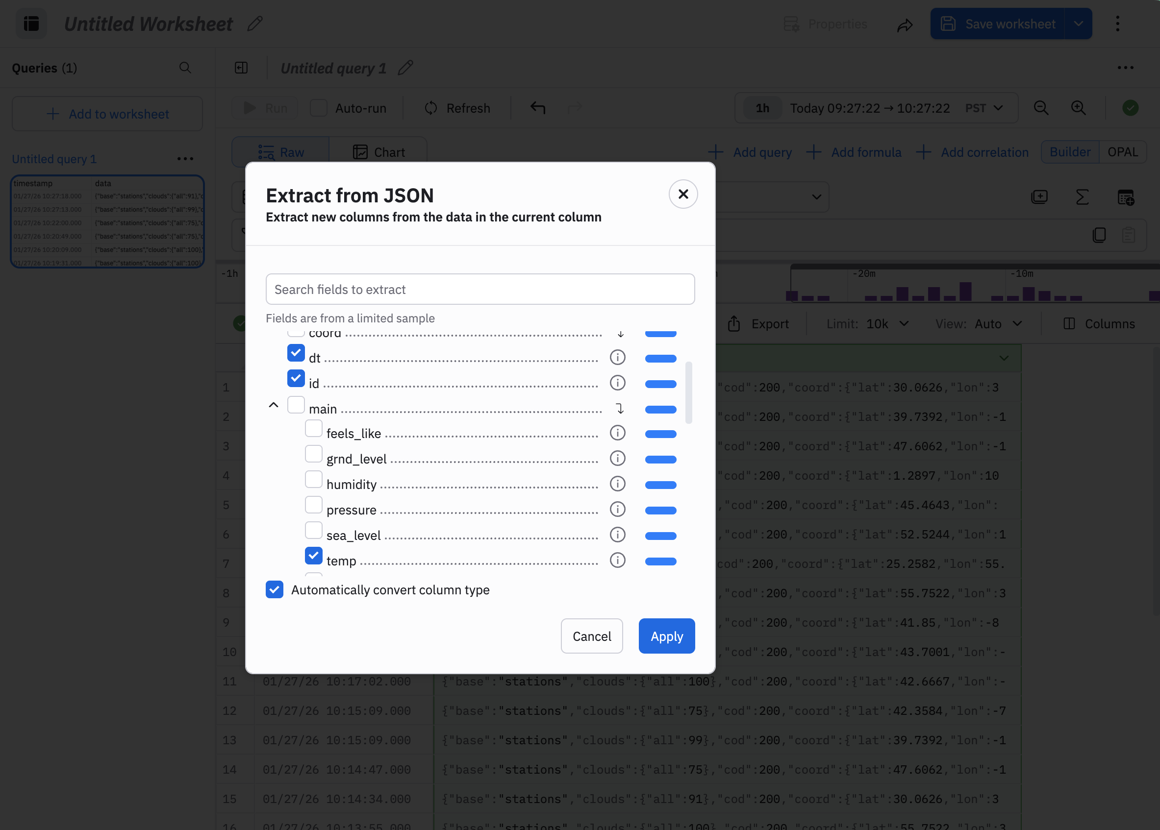

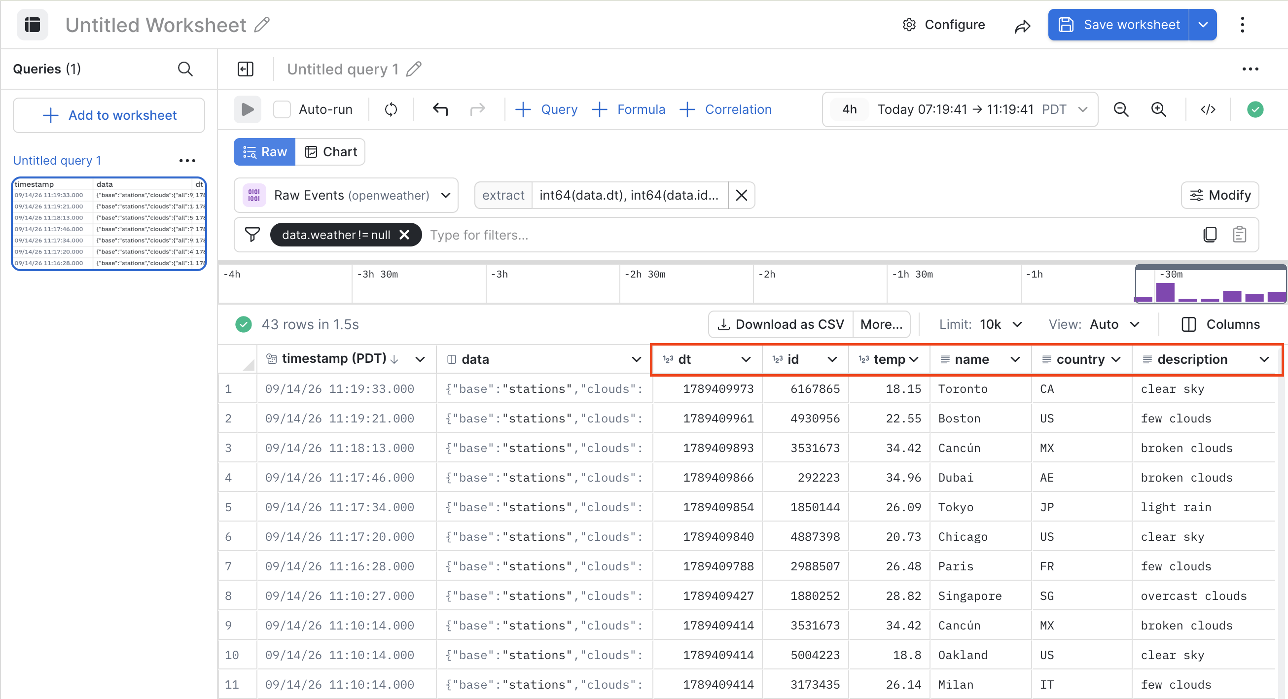

With the table filtered to just observations with the JSON key weather in it, you want to extract fields of interest from data.
Open the menu for the data column and choose Extract from JSON.
In the right menu, select the following fields. Notice that the
sysandweatherobjects must be expanded to reach the nested fields that you want to select:

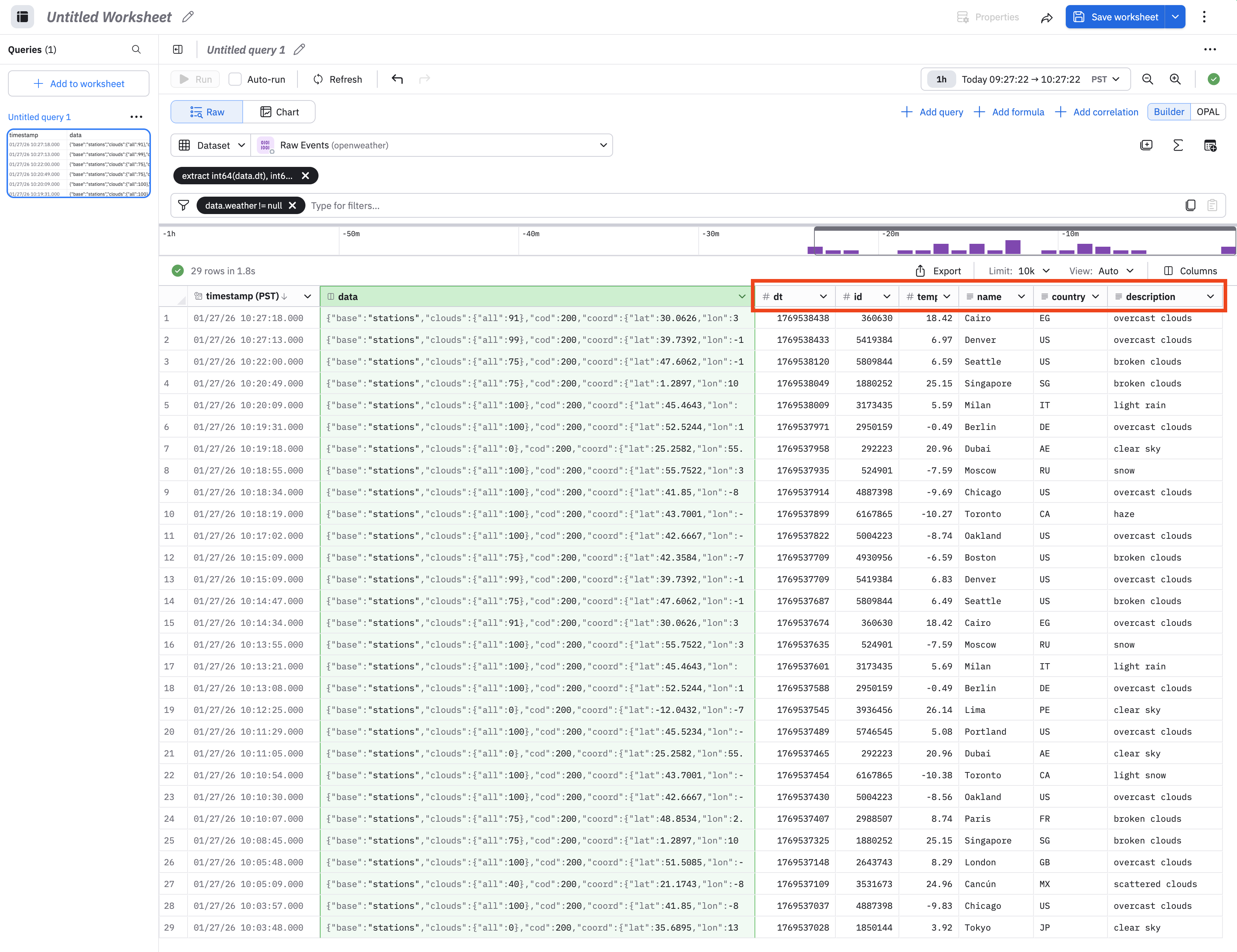

dt: recorded time of the observationid: unique IDmain.temp: current temperature, in Celsiusname: location, in this case, the city namesys.country: country location of the cityweather[0].description: text description of the current conditions
- Keep the Automatically convert column type checkbox selected.
- Click Apply to extract the data. You should now see new columns with the extracted data in your Worksheet.
The applied extraction with the new columns:

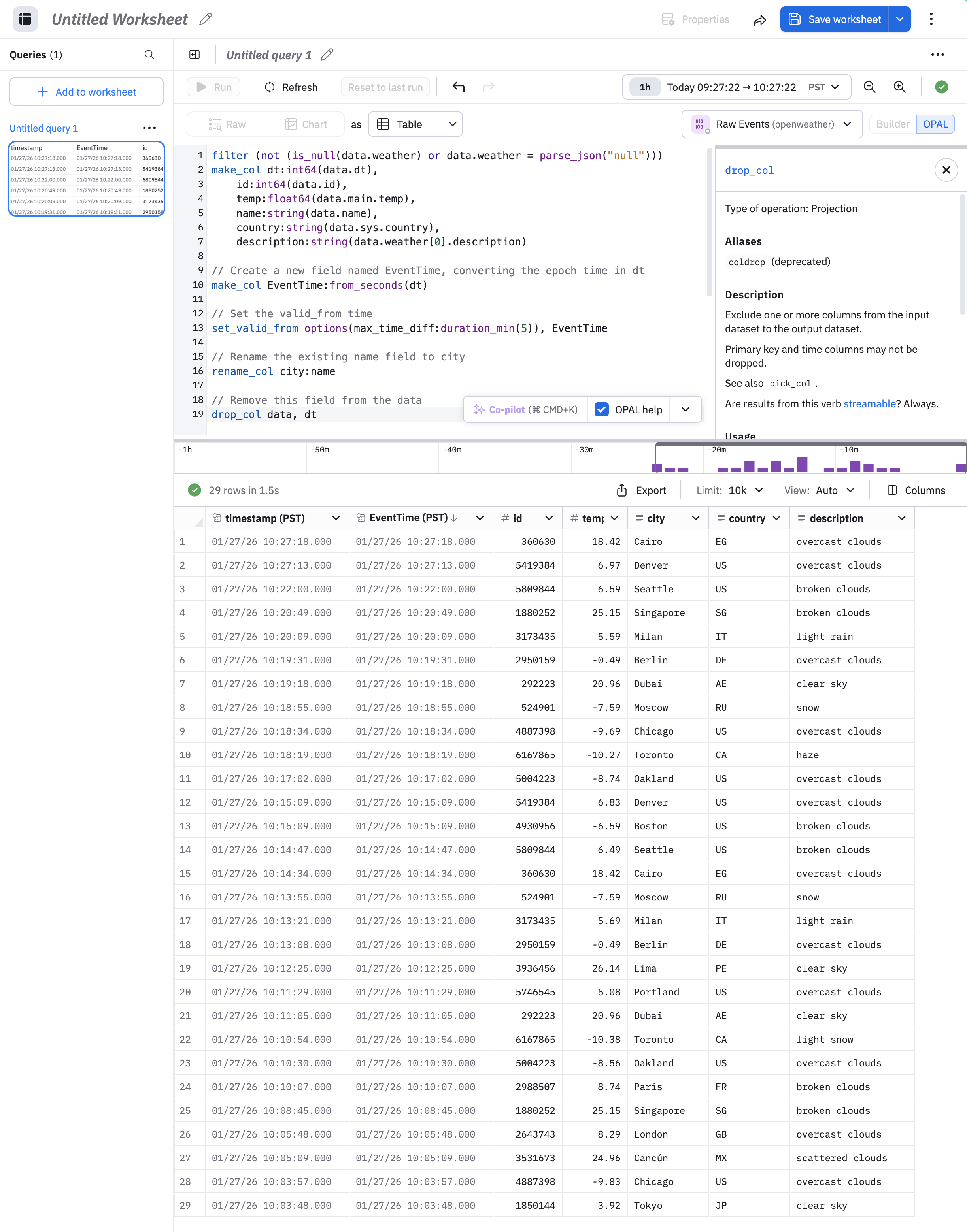

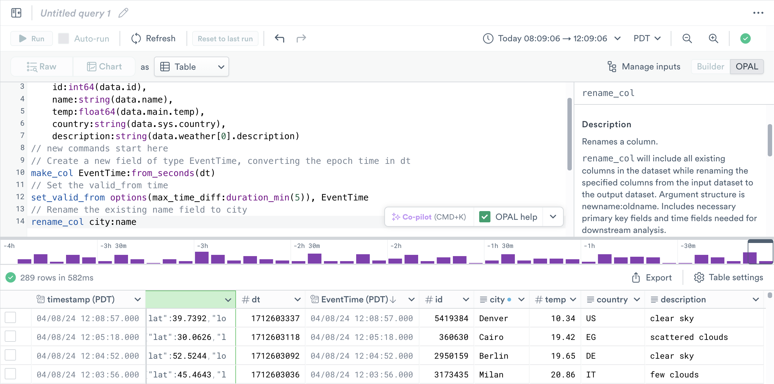

Refine the worksheet
With your fields freshly extracted, you now need to adjust a few additional things before you continue.
These actions must be performed directly via OPAL. Click on the OPAL button to switch from Builder mode to OPAL Console.

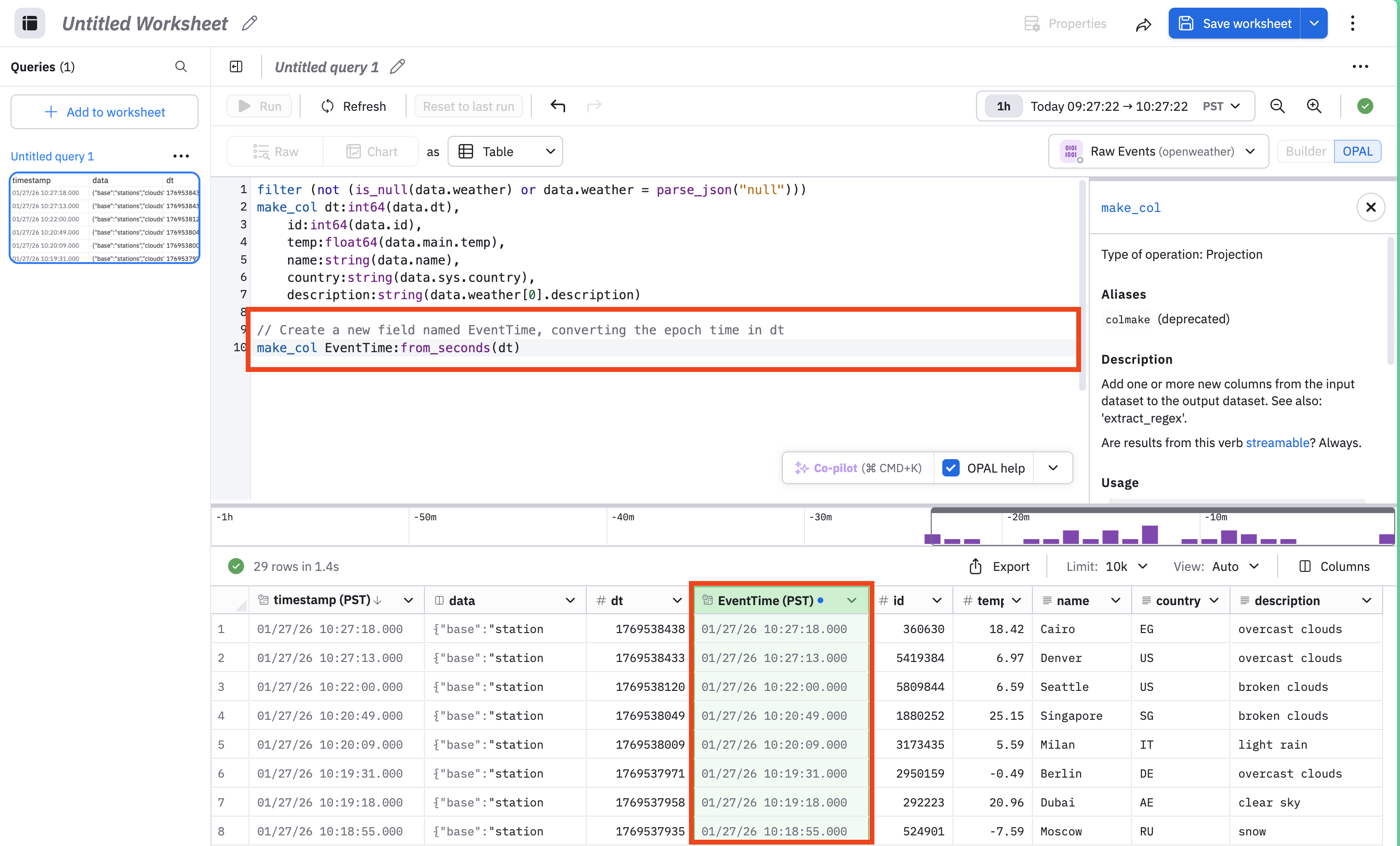

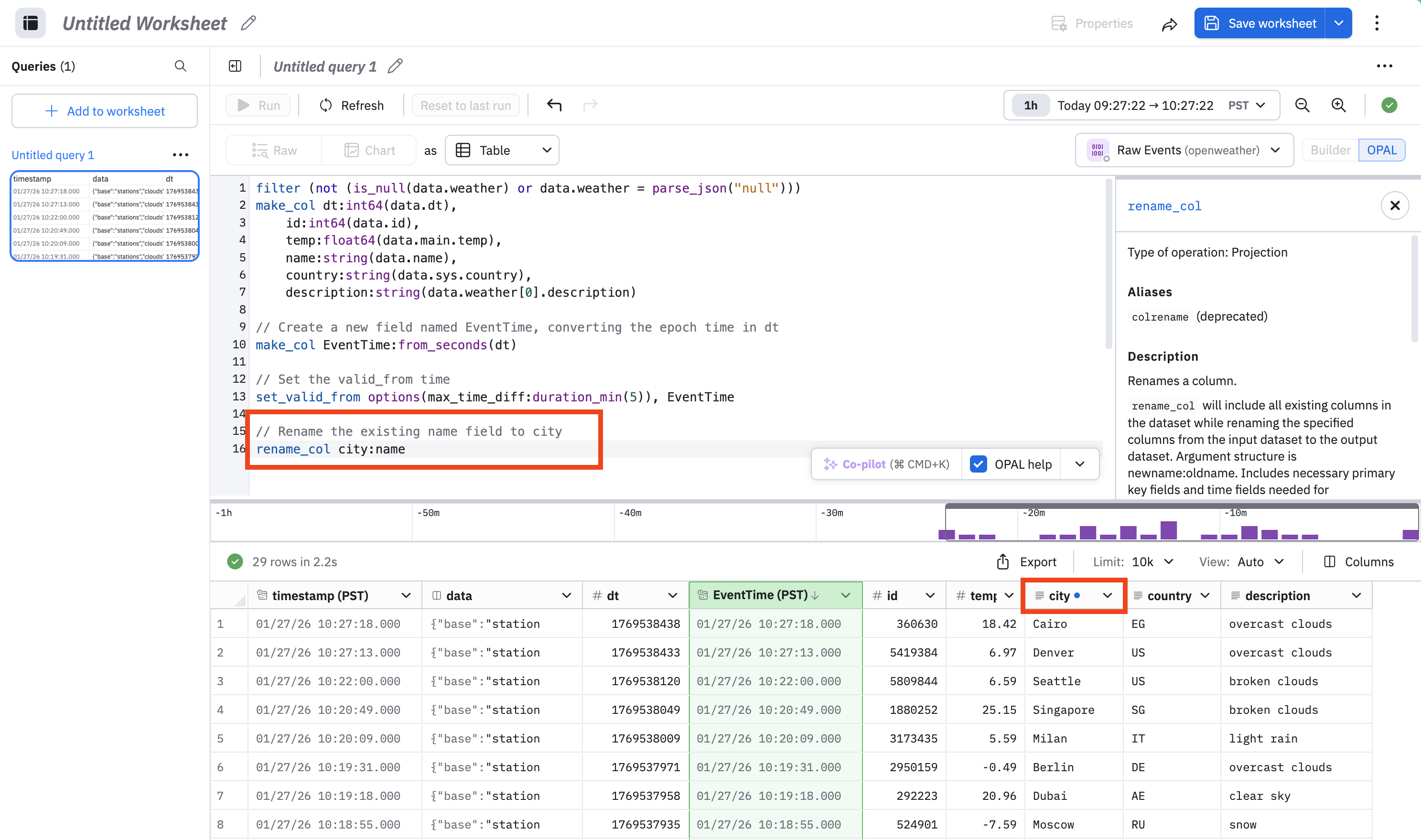

Create a new column
First , you will create a new column called EventTime from the extracted dt column, by using Observe by Snowflake's from_seconds function. This converts the event's Epoch time (seconds since the UNIX epoch) into an Observe by Snowflake event time (nanoseconds since the UNIX epoch). Add the following OPAL to the existing script on the Console and click Run:
// Create a new field named EventTime, converting the epoch time in dt
make_col EventTime:from_seconds(dt)
You should now see a new column called EventTime that has been parsed from its epoch representation in the dt column. Because Observe by Snowflake recognizes this field as a time, it is presented in the browser's locale format and timezone.
Designate the EventTime columns as the new timestamp
Designate our EventTime column as our new timestamp, using the following OPAL:
// Set the valid_from time
set_valid_from options(max_time_diff:duration_min(5)), EventTime
This now sets the newly created field EventTime as your event timestamp, by using the set_valid_from OPAL verb. Note that the OpenWeather Dataset's dt time values are close to the poller ingestion time seen in the raw Dataset. When dealing with your own data, if you need to specify a time value other than the time it was ingested by Observe by Snowflake, don't use a value that deviates too far from the original ingest time, as it can impact performance. See set_valid_from for details.
Rename a field
Rename the field name to city as a more descriptive header. Add the following OPAL to the existing script on the OPAL console and click Run:
// Rename the existing name field to city
rename_col city:name

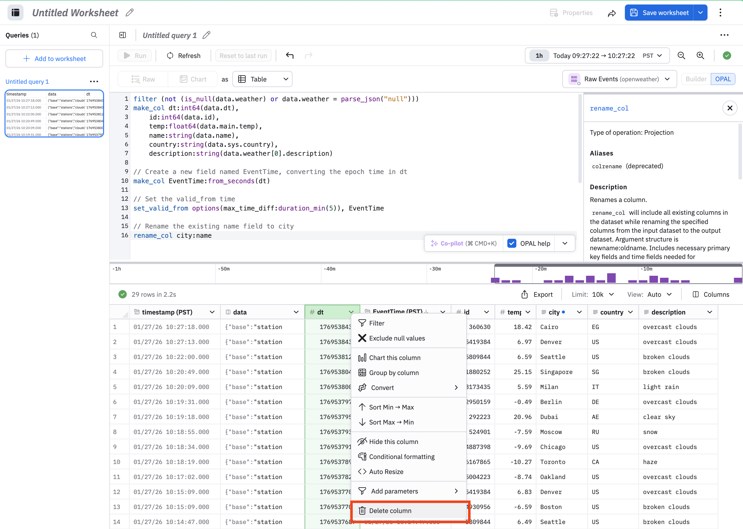

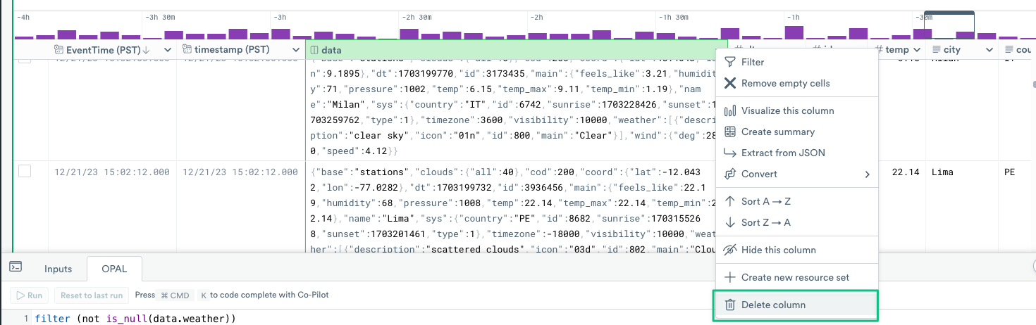

Remove columns using the UI
You don't need the data or dt columns any longer, so you can delete the columns from the Worksheet. For the best performance, consider it a good practice to remove columns you don't need. Remove the columns with one of these methods.
NoteThe Dataset must have a valid timestamp, so don't drop the timestamp field. The UI won't show the Delete column menu item for that field, and the OPAL console displays an error if you try to do it with
drop_colorpick_col.
Select Delete column from the column menu of the data and dt fields to delete them.

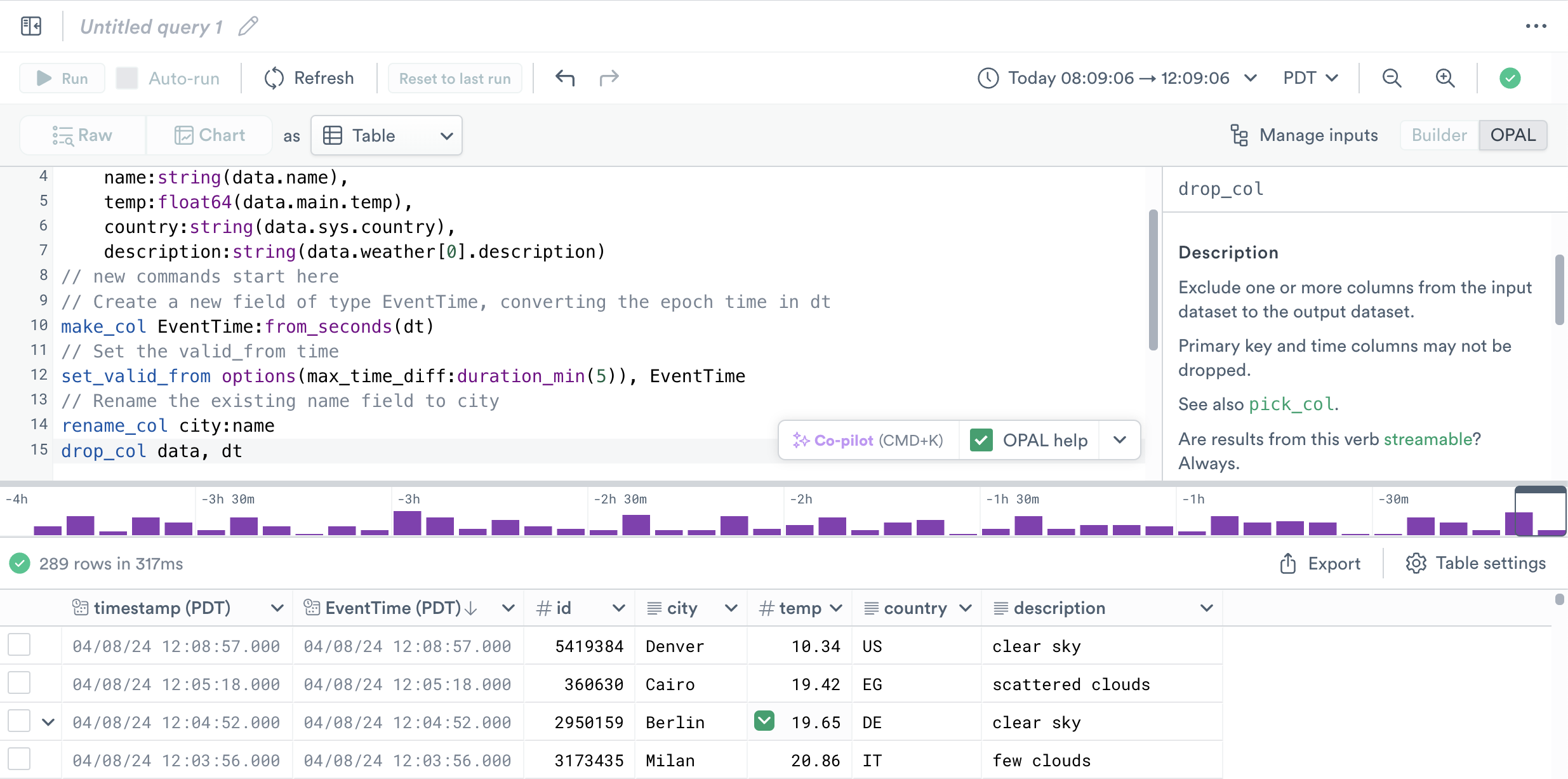

Remove fields using OPAL
There are two ways to remove fields in OPAL. Drop the ones you don't want with drop_col, or choose the ones you do want with pick_col.
Use drop_colto remove the column:
// Remove this field from the data
drop_col data, dt
Use pick_col to select the relevant columns:
// Keep these fields and drop all others
pick_col EventTime, timestamp, id, city, description, temp, country
Congratulations! You have now narrowed down all events in the Raw Event dataset to just the weather observations and shaped them into useful fields!
The resulting Worksheet should look like this. Note that in this case drop_col was used instead of pick_col.
The resulting OPAL script looks like this. Note that there is a commented section if you would like to try pick_col.
// Filter our events down to just those containing the weather key
filter (not is_null(data.weather))
// Extract desired fields from the JSON payload, contained in the data column
make_col dt:int64(data.dt),
temp:float64(data.main.temp),
country:string(data.sys.country),
description:string(data.weather[0].description)
// Create a new field of type EventTime, converting the epoch time in dt
// drop columns we dont want
drop_col data, dt
// alternatively, we can use pick_col to select only the columns we want
// pick_col EventTime, timestamp, id, city, description, temp, country

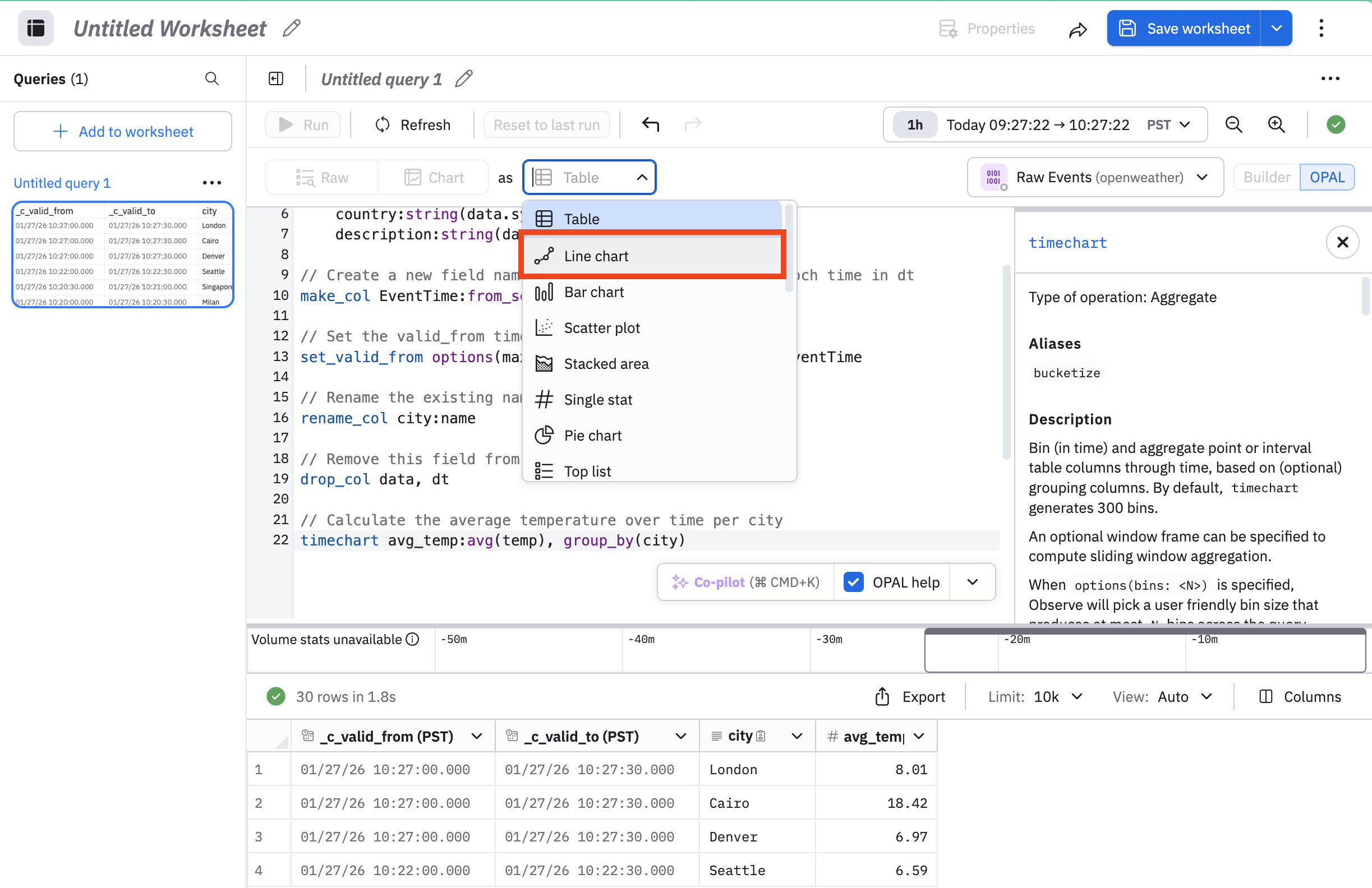

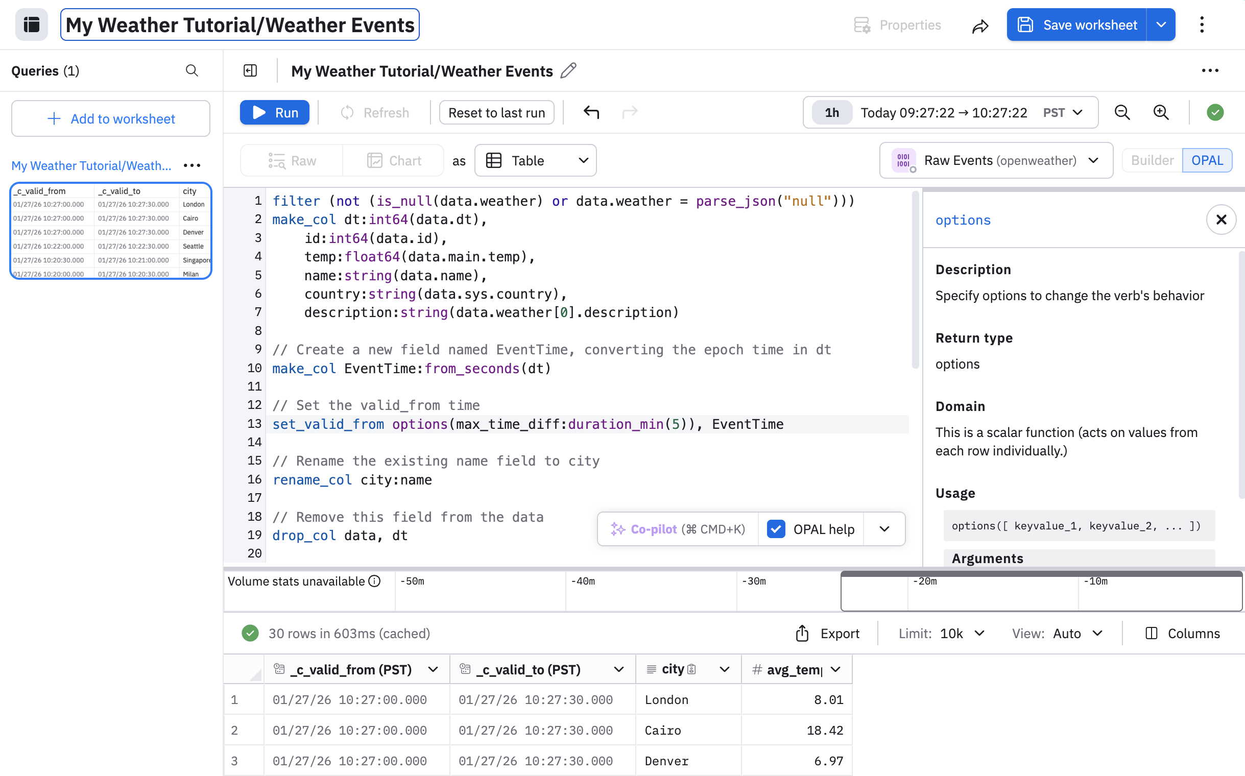

Next, let's prepare to visualize the data. Add the following OPAL to the console and click Run:
// Calculate the average temperature over time per city
timechart avg_temp:avg(temp), group_by(city)

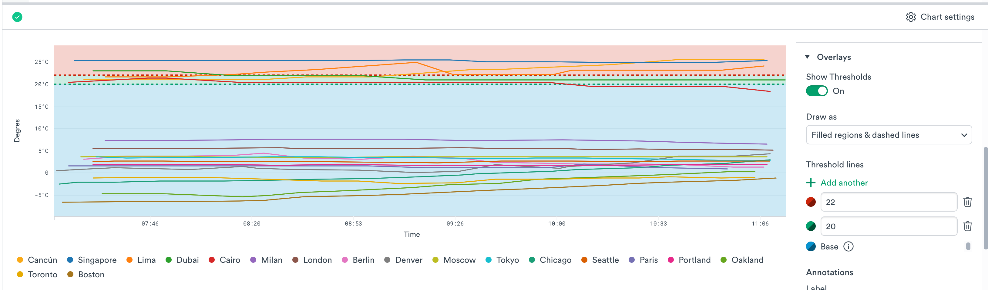

You can now display your data as a graph of temperatures for the cities in your data by changing the visualization type at the top center. It is currently set to Table; change it to Line Chart.
Use the Chart Settings option on the right to customize choices such as unit size, legends, and colors. See Visualization types for more detail. For now:
- In the Encoding section, set X to c_valid_from and set Y to avg_temp.
- In the Axis section, set the X-axis label to Time and set the Y-axis label to Degrees.
- In the Y value formatting section, select celsius (C, ℃, degC) as the Base unit.
- In the Overlays section, and slide the Show Thresholds toggle to the on position. Set Draw as to Filled regions & dashed lines. Put 20 in the first value, add another and set it to 22. Use the color pills on the right to set the top band to red, the bottom band to blue, and the middle band to green.

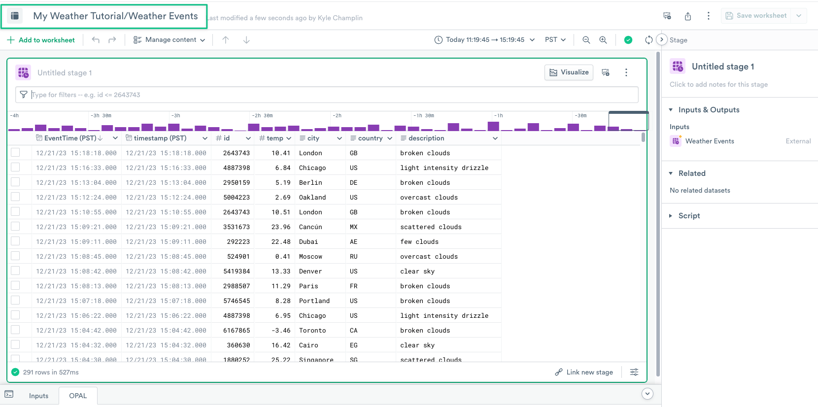

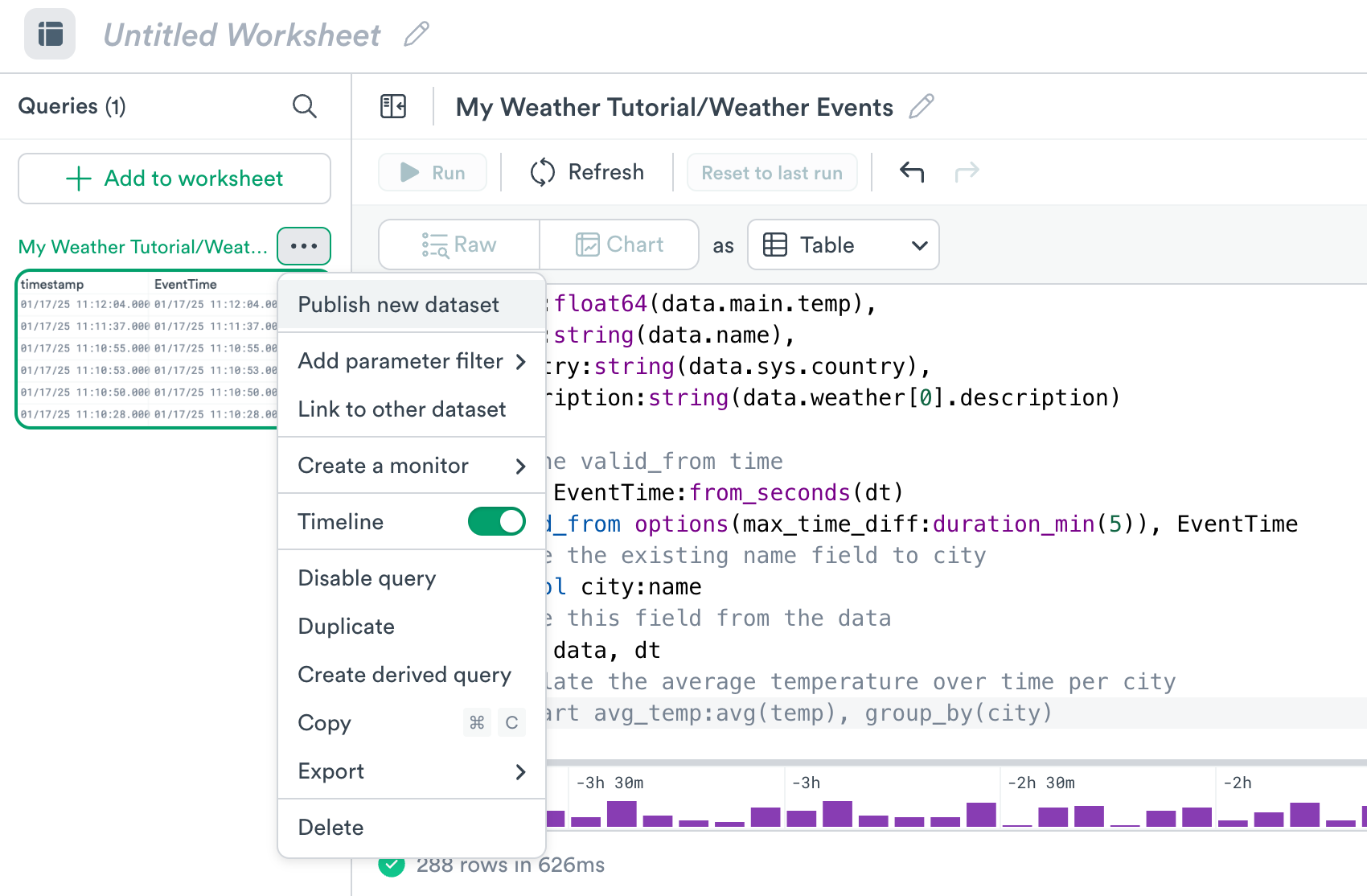

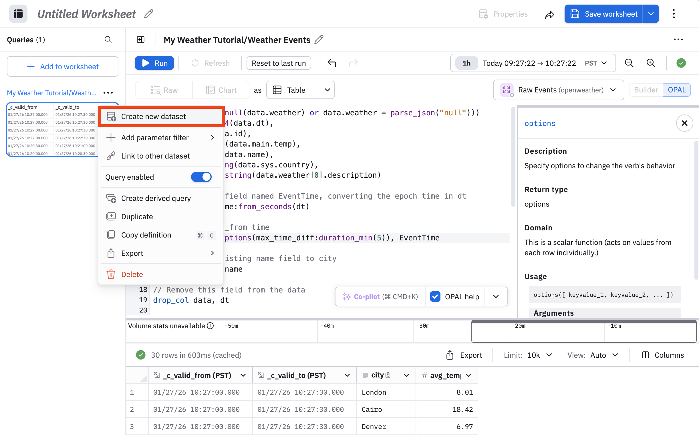

Save your shaping work as a new Dataset
While the table of individual weather details may be useful, the data only exists in this Worksheet at the moment. To use this data in other ways, such as creating metrics, you need to publish it as a new Event Dataset.
- Remove the visualization from your Dataset by changing the visualization type at the top center from Line Chart to Table.
- Comment out the
timechartline:
//timechart avg_temp:avg(temp), group_by(city)
- Name this query My Weather Tutorial/Weather Events.
- Click Create new dataset in the left Rail Query context menu.
By prefixing My Weather Tutorial to the name of the Dataset, it allows a natural namespacing in Observe lister pages. These are colloquially referred to as package names, and allows you to group related Datasets, making it easier to find them later.
You can also save the Worksheet as well, but keep the tab with your Worksheet open, as we will use it later on.
Click on the Worksheet name, Untitled Worksheet, at the top of the page.
Type a new name and click Save worksheet.

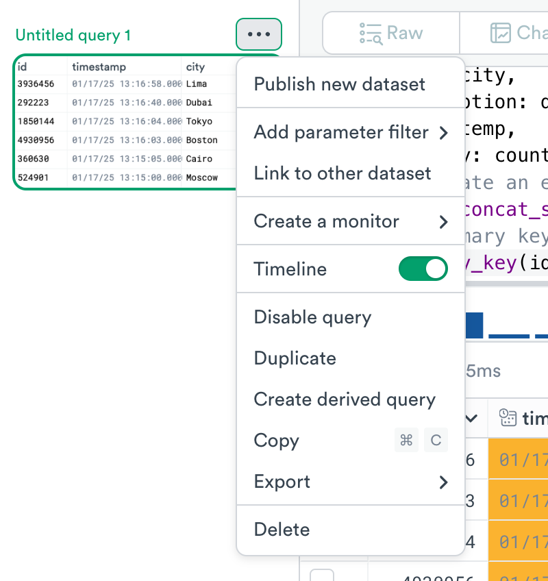

Create Resources for observation locations
Now that you've seen how Observe by Snowflake can shape your raw data, and even turn it into custom Datasets, Worksheets, and visualizations; the real power of Observe by Snowflake is in the concept of Resources. Resources, or Resource Datasets specifically, are best thought of as objects in your environment whose state changes over time, but the object itself is persistent.
To create our Resource and publish them as a Resource Dataset, use the following steps:

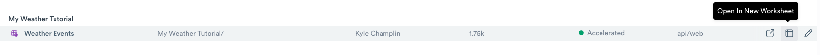

- Select Datasets on the left navigation.
- Search for your Weather Events Dataset you just created.
- Click on the Weather Events Dataset.

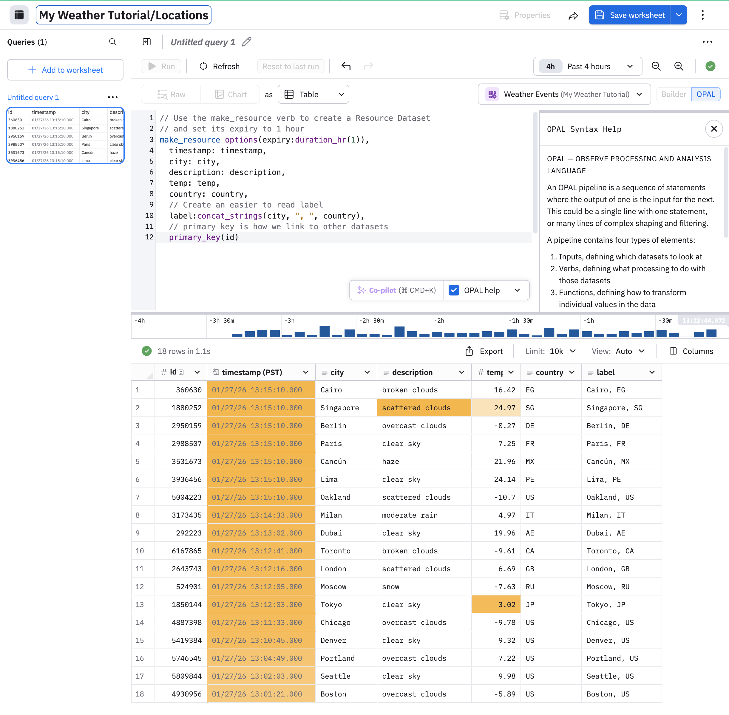

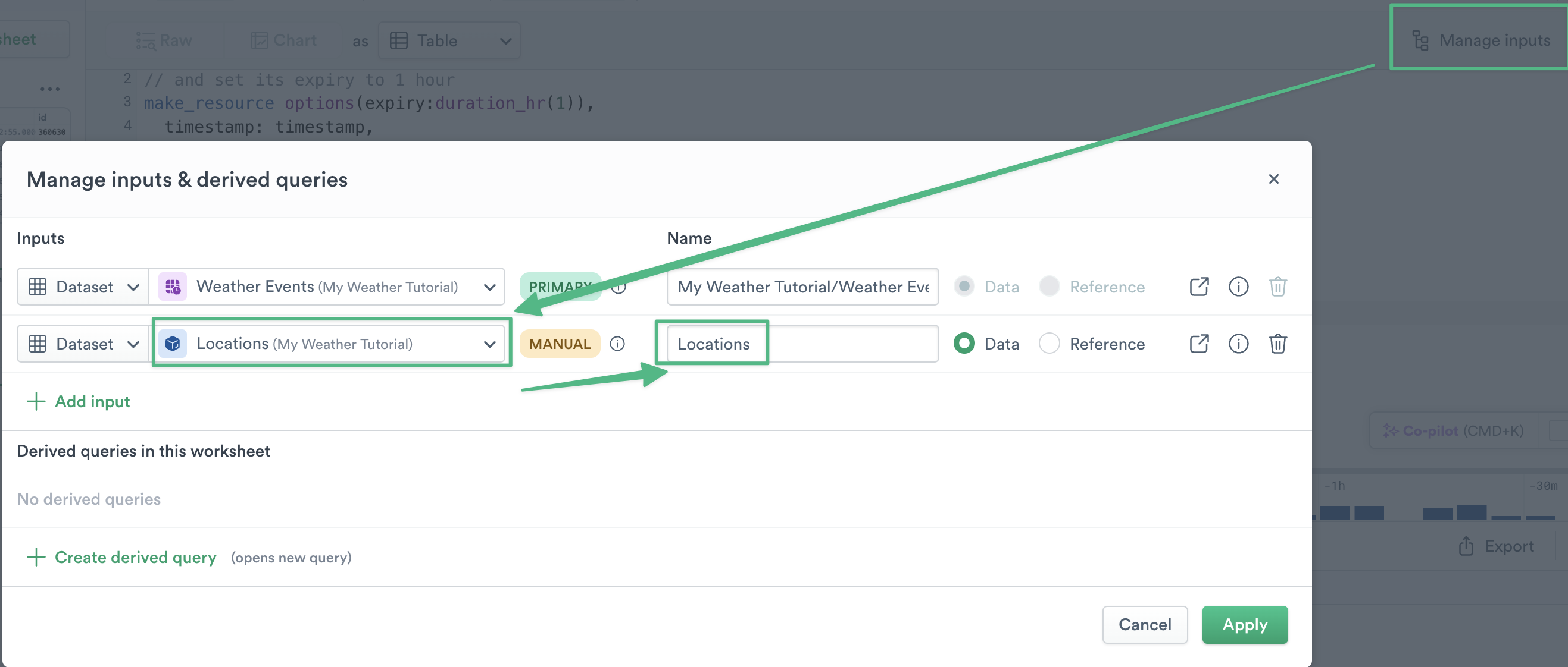

- Choose Create Worksheet at the top of the screen. You can now see that the Worksheet has a starting point reading from your Weather Events Data.

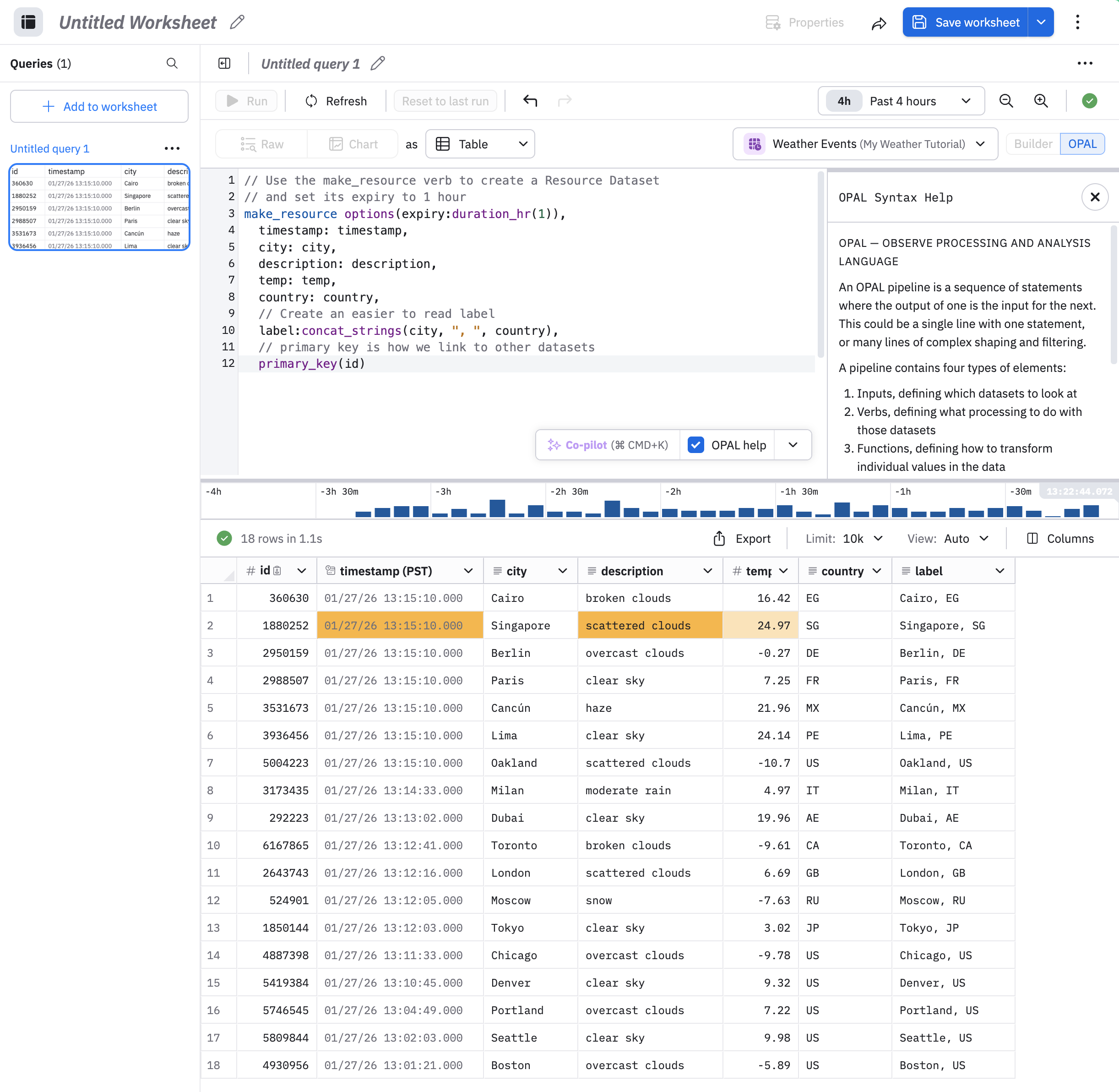

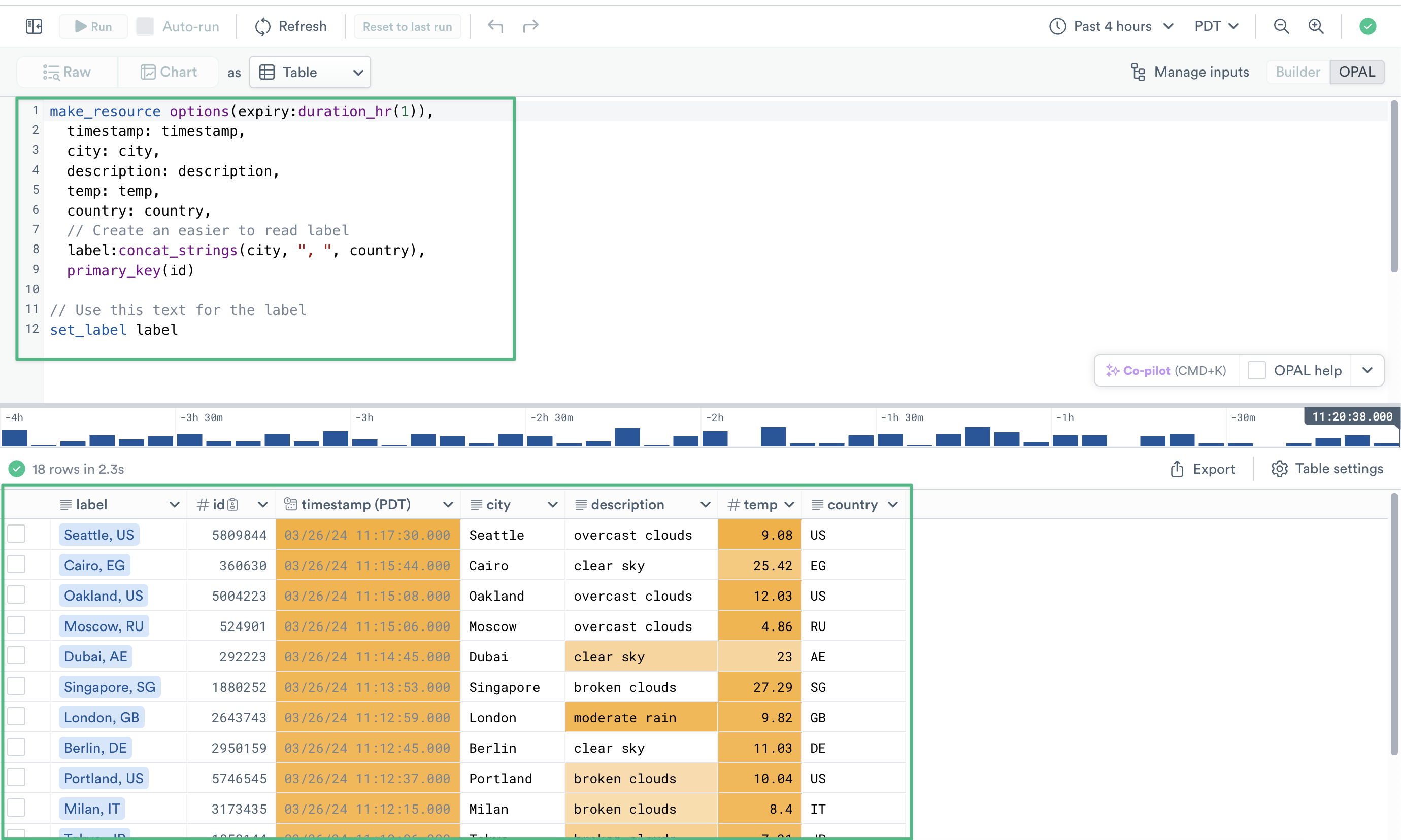

- Paste the following OPAL into the OPAL editor:
// Use the make_resource verb to create a Resource Dataset
// and set its expiry to 1 hour
make_resource options(expiry:duration_hr(1)),
timestamp: timestamp,
city: city,
description: description,
temp: temp,
country: country,
// Create an easier to read label
label:concat_strings(city, ", ", country),
// primary key is how we link to other datasets
primary_key(id)
NoteThe Primary Key defines which field or fields uniquely identify each Resource. In this data, each city has a unique
id. You use this later to link datasets.
- Click Run to run the OPAL. You should see a table similar to the below:
- Click the ellipses icon () next to the worksheet preview pane and select Create new dataset. On the new Dataset page, give your new Resource Dataset the name My Weather Tutorial/Locations.

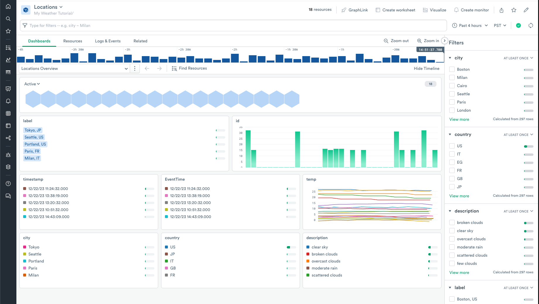

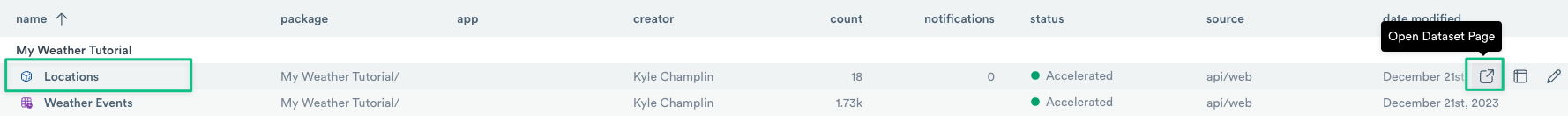

Now you can go back to the Datasets area, and open the My Weather Tutorial/Locations Resource Set.
The default Resource dashboard displays weather details, which may be filtered by city, country, or weather description. This shows basic information and simple visualizations. The following section describes creating temperature metrics for individual cities.

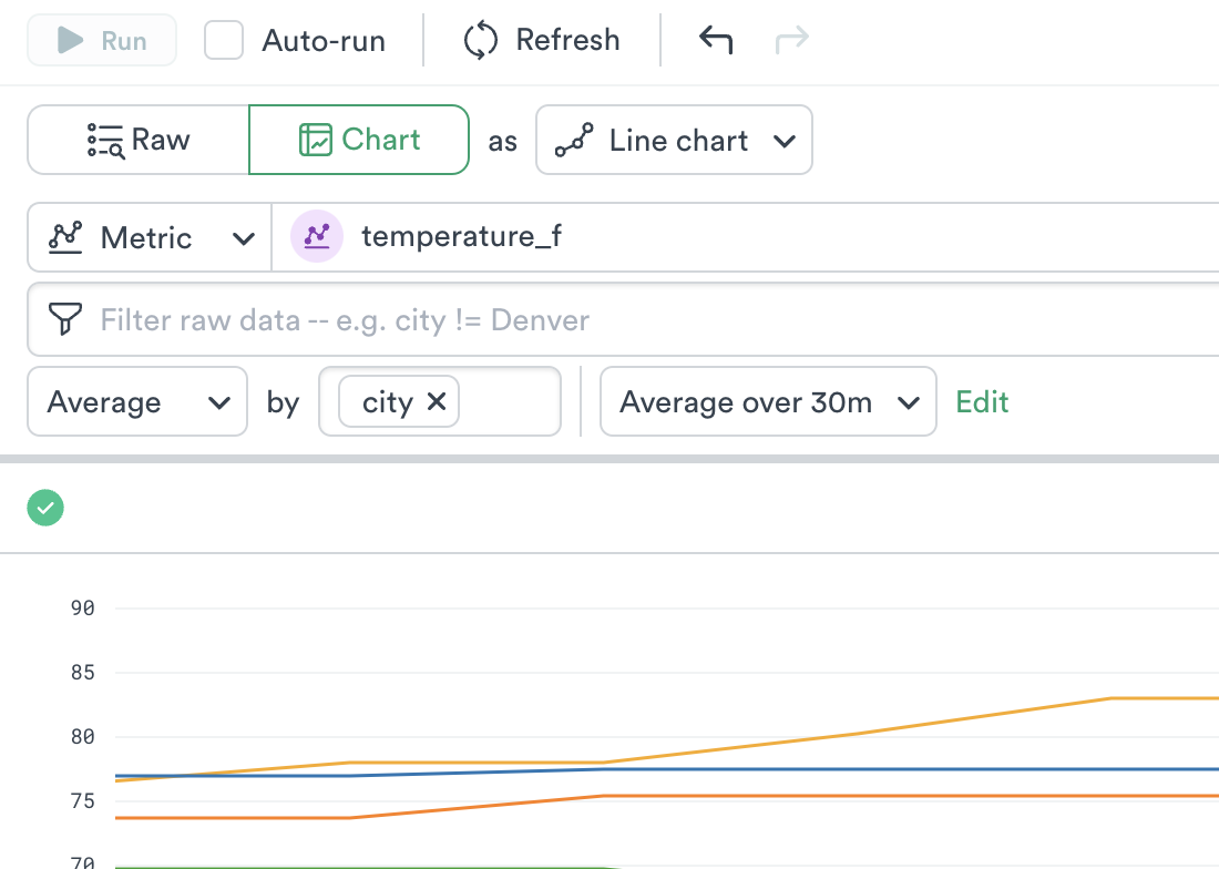

Create weather metrics
A metric is a numeric measurement that changes over time. Our OpenWeather data's temperature readings are ideal examples of metrics. They can be displayed in charts, used to trigger alerts, or calculate other values.
For this example, you will create two temperature metrics:
- Original Celsius reading
- Calculated Fahrenheit equivalent
This builds on the Weather Events dataset you created previously, containing the raw values for each weather observation. Metrics operations useOPAL, so most of this section is done in the OPAL console.
To use the Weather Events data to create metrics, you need to shape the observations into a more appropriate form. See Collect and use metrics for more details.
Summary of the Metrics process
- Review the Weather Events dataset. Recall that it has one row for each set of measurements.
- Using OPAL verbs and functions, shape these events into a series of new events, one for each value of your metric.
- Add an
interfaceto identify this dataset as containing metrics, which enables additional metric operations in Observe by Snowflake.

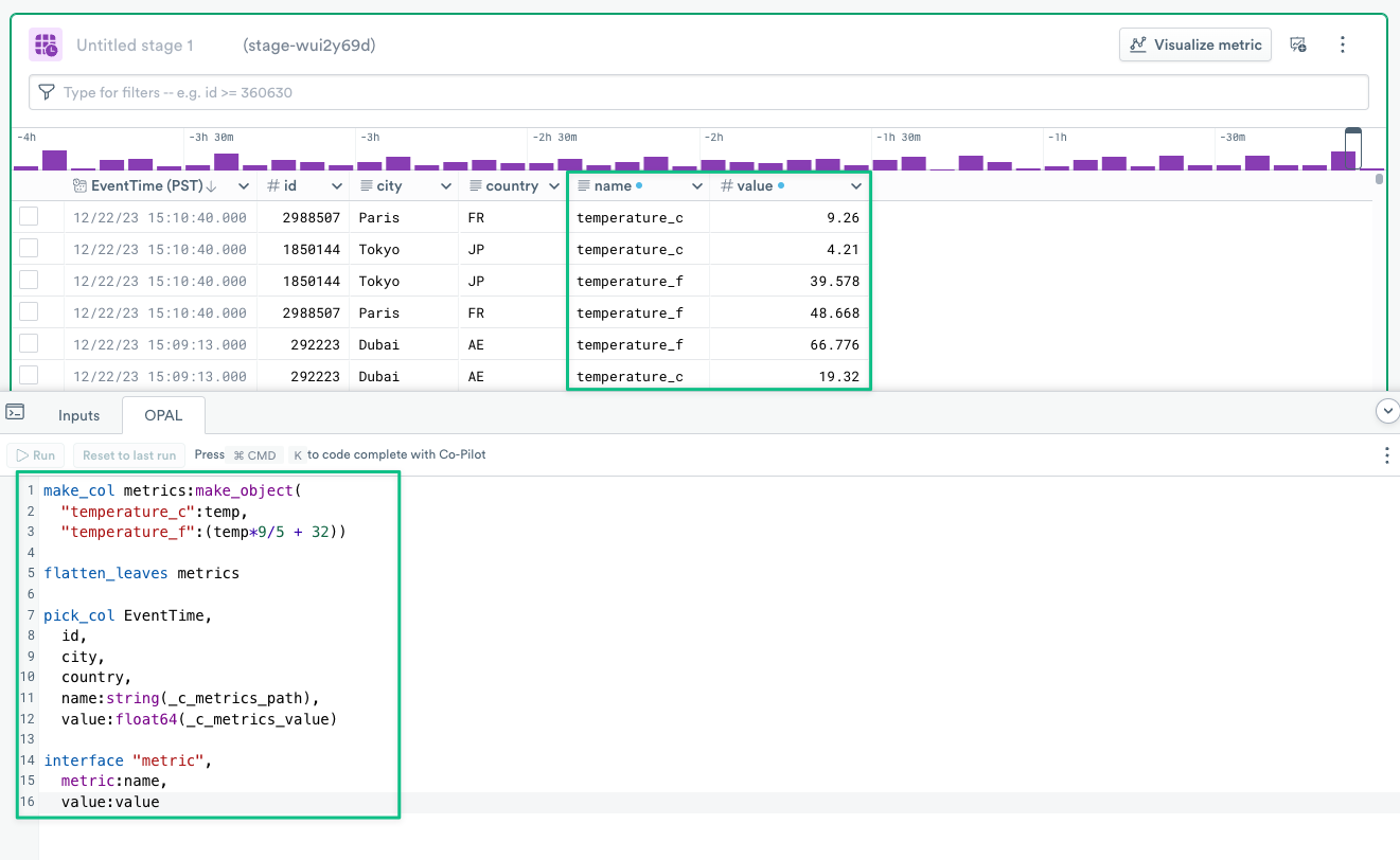

- Use
make_colto create a new field of type object. It contains the two metric values from each observation: the original temperature reading in Celsius, and the value converted to Fahrenheit:
make_col metrics:make_object(
"temperature_c":temp,
"temperature_f":(temp*9/5 + 32)
- Use
flatten_leavesto create two events, one for each temperature value.
flatten_leaves metrics
- Use
pick_colto select the columns, and rename the generated c fields to something more useful.
pick_col EventTime,
id,
city,
country,
value:float64(_c_metrics_value)

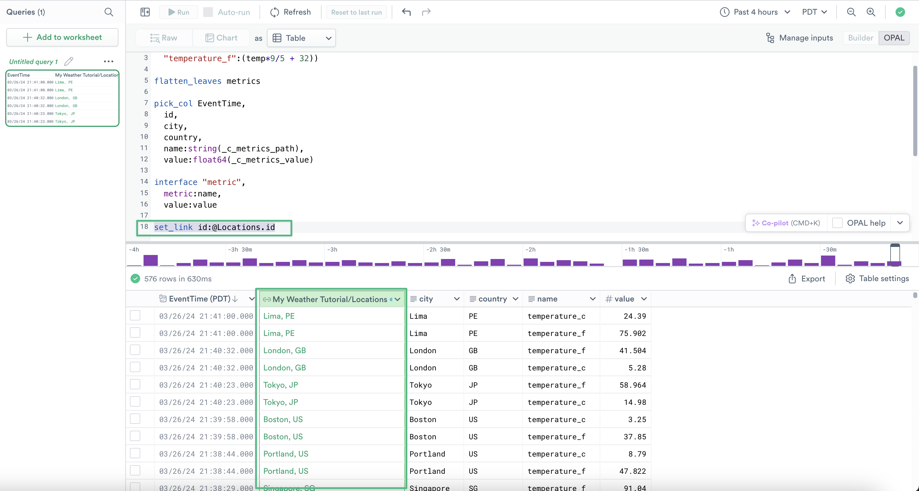

- Define an
interfaceto identify this dataset as containing metrics. This also specifies which columns contain the names and the values.
interface "metric",
metric:name,
value:value
- Click Run to confirm everything works. When you finish, your OPAL should look like this:

country,
interface "metric",
metric:name,
value:value
The resulting table contains two rows for each temperature reading:
Link Datasets together
Observe by Snowflake provides the ability to link different Datasets together, enabling you to create rich correlations. In this section you will link the id column of our metrics data, to the primary key id in the corresponding Locations Resource Dataset you created earlier. You will do this again using OPAL. However, first you will add a new Data Input by selecting Manage Inputs in the top right. Locate your Location Resource dataset we just crated and make the name Locations.
NoteAdding the input via the UI allows you to address the dataset by its human readable name, rather than it's dataset ID value.
The OPAL for creating a link is very simple, you provide a dataset and associated column that you wish to join together. Values that match between the specified keys will be joined or "linked" together.
// set_link uses a column in the current dataset
// and the @ operatator to address the dataset name and column you with
// to join on
set_link id:@Locations.id
Publish this Worksheet as a new Event Dataset. Give this dataset the name My Weather Tutorial/Weather Metrics.

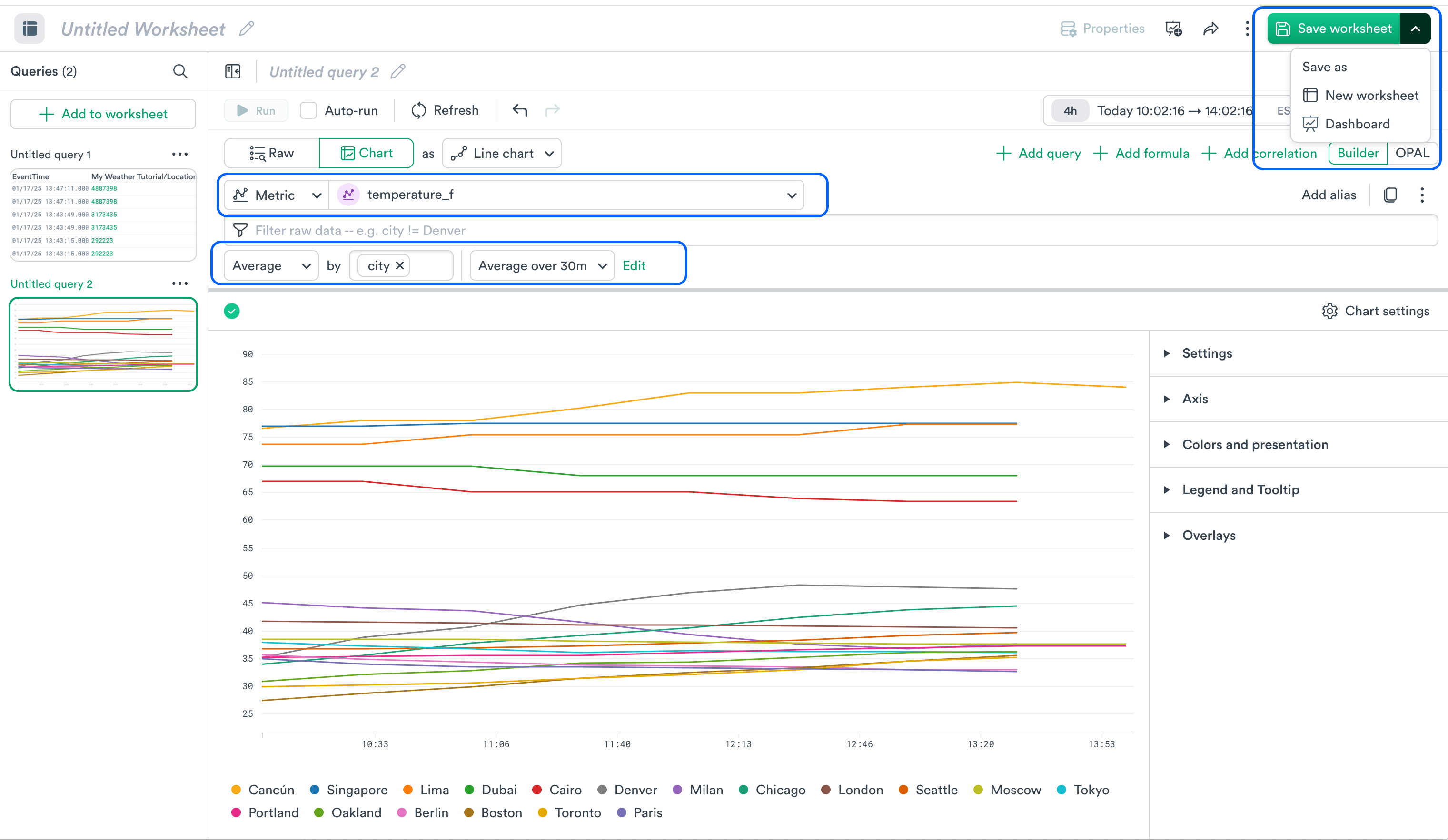

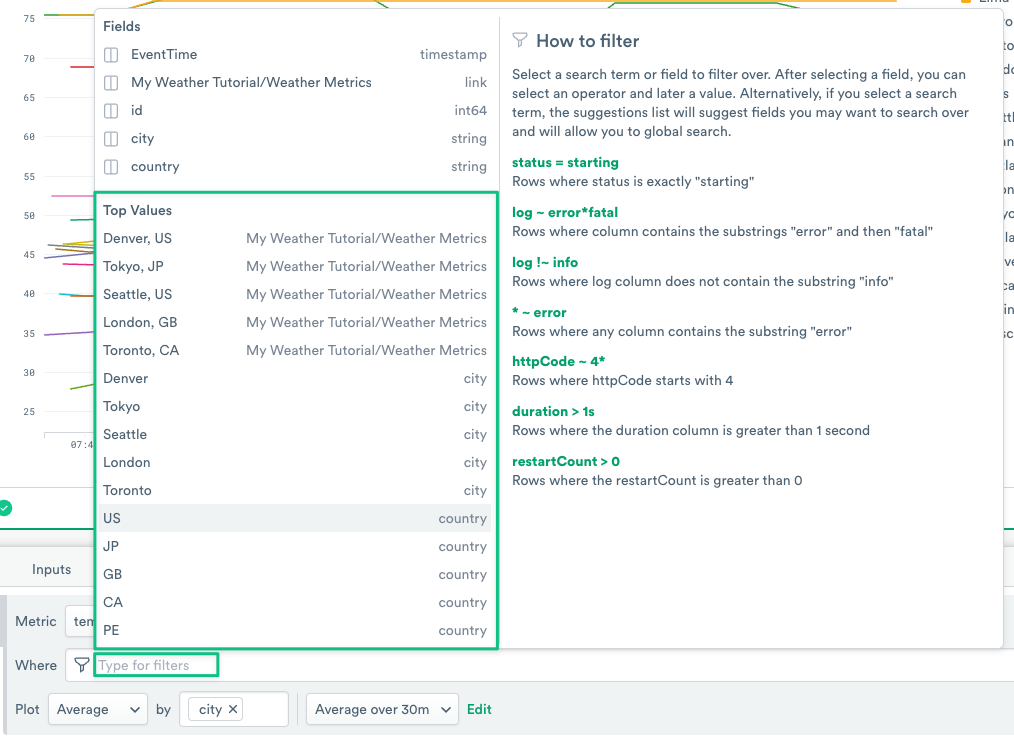

Dashboard your weather metrics
Starting with our new Weather Metrics Dataset, let's open it as a Worksheet. You can do this by selecting the "Open In New Worksheet" in the Datasets lister page.
- Click the Add to worksheet button in the top left.
- Choose Metric under Visualizations section
- In the center of the screen you will see a Metric dropdown and Select a metric to the right. Select the metric and choose Browse all
- Select
temperature_ffrom the Metrics list.
In the section beneath the Filter, add the following parameters:
- Plot =
Average - By =
city
You can use the Where option to also filter down to specific Metric values or names as well. Observe even provides summary values from your data to select from.
- To create a different type of visualization, click the Visualize tab and select a different type from the Type list. Experiment with different types to see how the display changes with each type of graph.
- Click the Presentation tab to change the presentation layout. You can add legends, flip your x- and y-axes, change colors, and customize the appearance.
- To create a dashboard from the worksheet, click Save as Dashboard in the green dropdown with Save worksheet.
For more information on using Dashboards, see Create and share dashboards.
