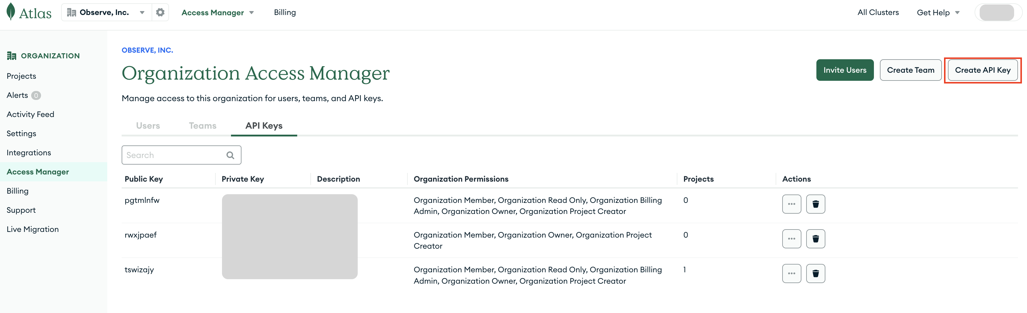

- Log into MongoDB as the user you want to generate the API keys.
- Go to the Organization Access Manager page for your organization and click Create API Key.

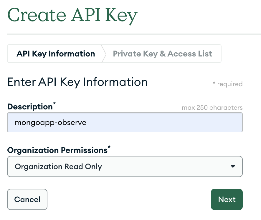

- Enter the API Key Information.
- Enter a Description
- In the Organization Permissions, check Organization Read Only:
- Click Next and record both the Public Key and the Private Key
- Click Done and ensure the keys are present in the Organization Access Manager home page.

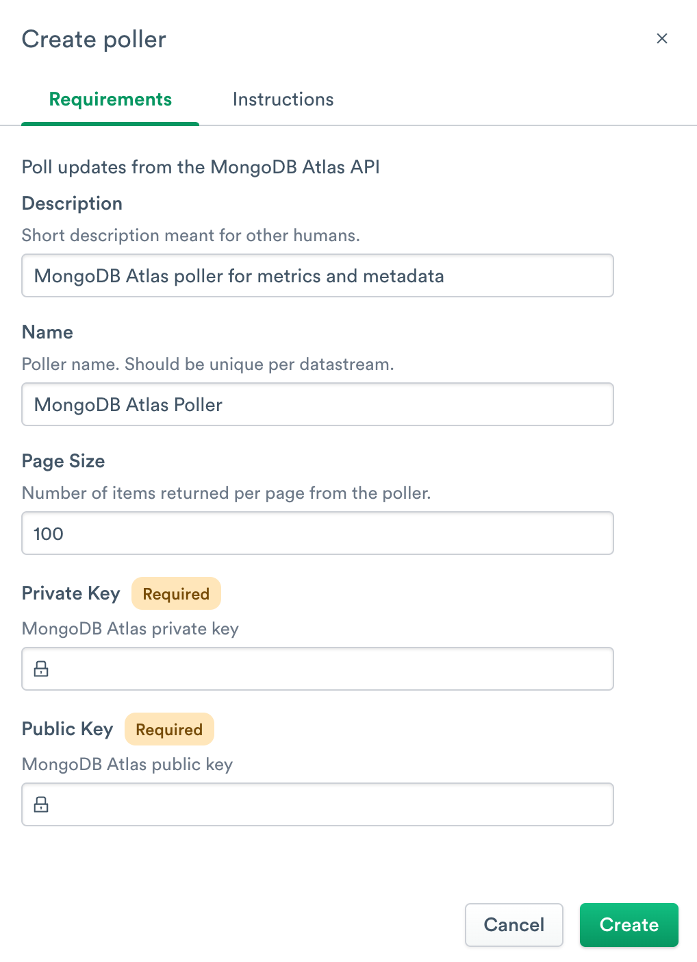

In the MongoDB Atlas app, go to the Connections tab.
Under Data connection requirements, in the Poll updates from the MongoDB Atlas API section, click Get Started.
In the Create poller dialog, configure the following settings:
- For Public Key, enter the public key obtained from Organization Access Manager.
- For Private Key, enter the private key obtained from Organization Access Manager.
