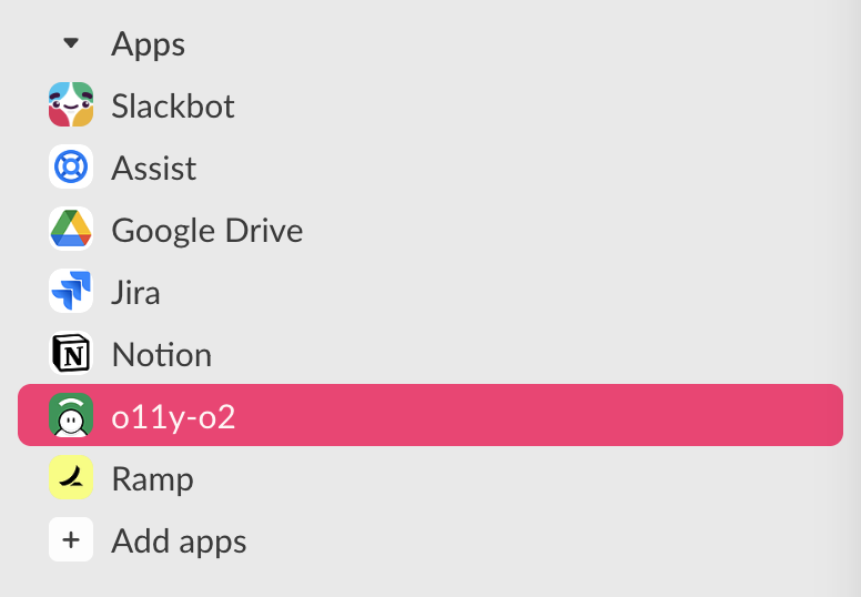

To enable o11y in Slack, you must add the Observe o11y app to your Slack workspace. Observe admin rights are needed. See Configure connections for instructions.
After you configure this connection, the o11y bot appears in your Slack Workspace Apps list.

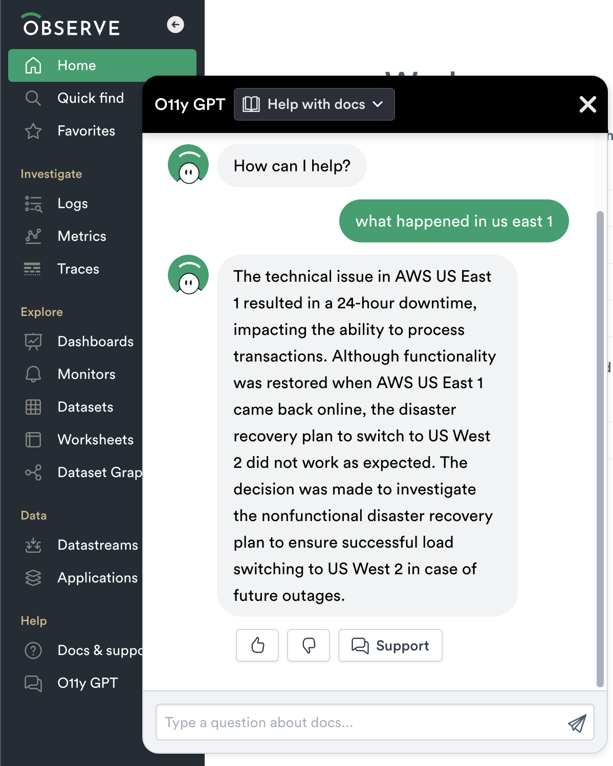

  3. Use /o11y summarize --since 7d --save to record the incident as a runbook to your Observe instance.
  4. In Observe, go to Workplace Settings > Uploaded Documents to review the runbooks that are used.
  5. Use o11y AI in Observe to ask questions about your incident.
