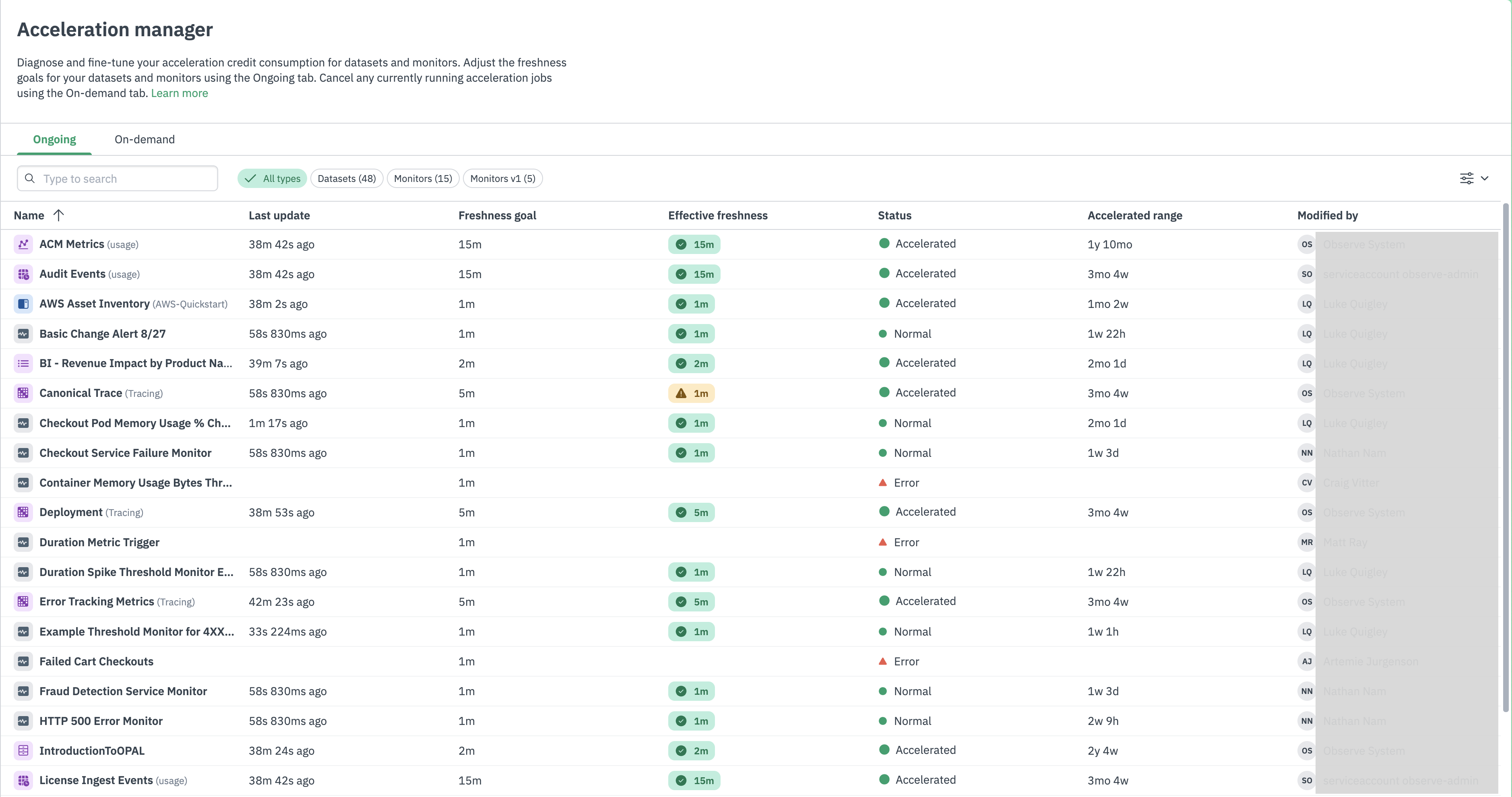

Ongoing acceleration jobs
The Acceleration Manager page displays the following information about your Datasets and Monitors:
| Column | Description |
| Name | The name of the Dataset with an icon to indicate the Dataset type as Event Stream or Resource. |
| Last Update | The last time the Dataset was updated. |
| Freshness Goal | How often you want Observe by Snowflake to update the Dataset. Observe by Snowflake schedules Dataset acceleration jobs to satisfy the freshness goals of all Datasets. Longer freshness goals allow Observe by Snowflake to include more data in an acceleration job, providing more efficiency and less credit usage overall. |
| Effective Freshness | The current freshness of the Dataset. |
| Status | The current status of the Dataset such as Accelerated, Cannot Be Accelerated, or Backfill in progress. |
| Acceleration Range | The length of time to apply acceleration to the Dataset. This is the range of data currently accelerated. |
| Modified By | The name of the member who last modified the Dataset definition. |
Effective freshness
Effective Freshness shows the rate at which a dataset or monitor is actually being refreshed, after adjustments for the freshness goals of upstream and downstream datasets. For instance, in a dataset chain of foo (5 minute goal), bar (10 minute goal), and baz (1 minute goal), all three datasets have an effective freshness of 1 minute. Note that automatic freshness decay is not reflected in this column, but its effect can be seen in the Last update column.
You may see one of two icons displayed next to the Effective Freshness value:
- Yellow triangle - There is a downstream or upstream dataset or monitor that has a tighter freshness goal than this object, preventing the set goal from matching the effective goal. Alternatively, the freshness goal of this Dataset may be suppressed due to an Acceleration Credits limit in Credit Manager. In either case, data may be less fresh than you desire. See Credit Manager for more information on Acceleration Credits.
- Red triangle - There is a downstream Dataset or Monitor with a tighter freshness goal than this object, preventing the set goal from matching the effective goal.
Use these steps to change the freshness goal for a selected Dataset:
- Hover over a Dataset row to get the context menu on the right side, and click the Edit dataset freshness lightning icon to open the Freshness Goal modal.
- Set the Desired Freshness value. The Effective Freshness message displayed on the modal changes to let you know if this goal can be met. Click Apply to commit the change, or Cancel to abort.
If Desired Freshness of this dataset is affected by other upstream or downstream datasets or downstream monitors, they will be listed on the modal. Click the pencil icon on the affected object’s row to adjust the freshness goals of that datastream or monitor. Note that a back arrow icon is placed at the top left of the modal during this step, so you can return to your original position.
NoteIf you use Acceleration Credits limits in the Credit Manager feature to budget your accelerations, Observe by Snowflake will warn of accelerations breaching that limit in Effective Freshness.

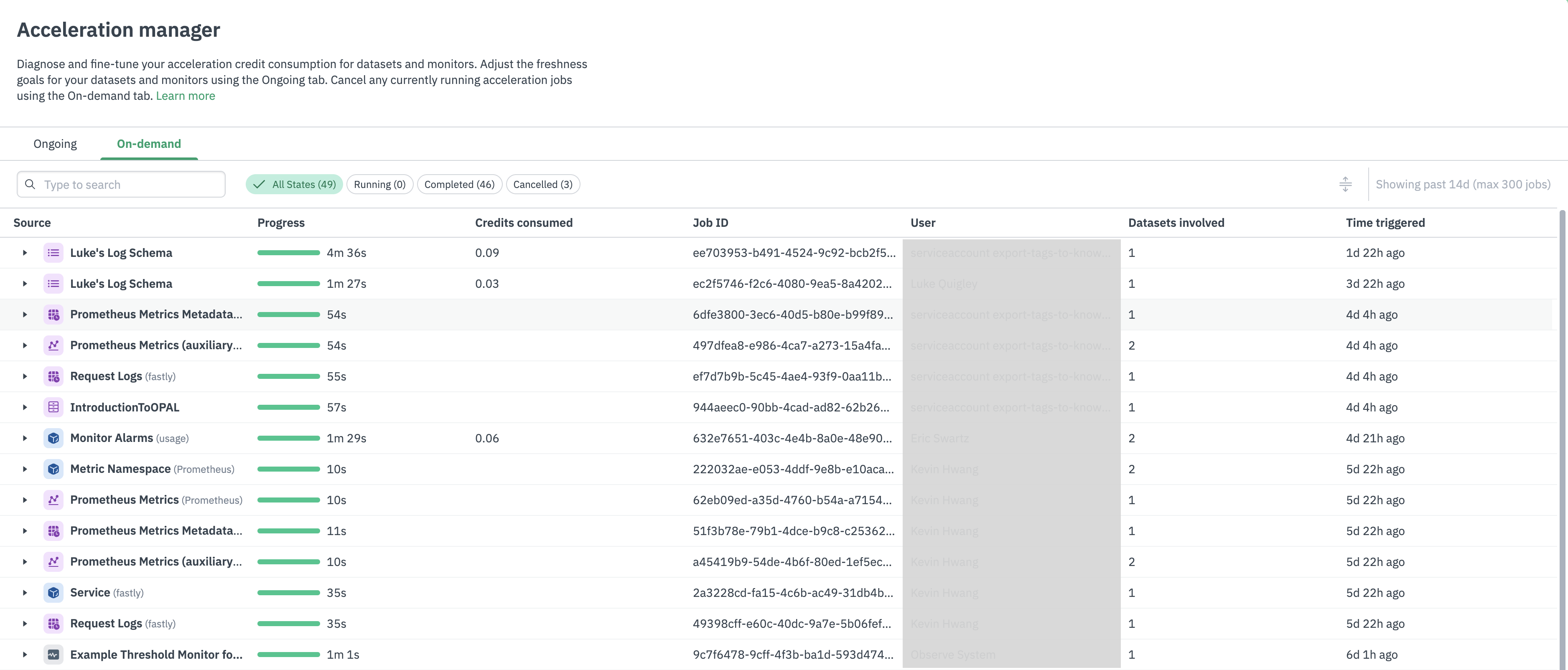

On-demand acceleration jobs
The On-Demand tab displays the status of Datasets currently undergoing acceleration from natural on-demand usage or the Accelerate Full Range button.
You can select to display them by the following types:
- All states - displays Acceleration Jobs in any state.
- Running - displays Acceleration Jobs currently undergoing the acceleration process.
- Completed - displays Acceleration Jobs that finished the acceleration process.
- Canceled - displays Acceleration Jobs canceled during the acceleration process.
On-Demand Acceleration Jobs also displays the following information:
| Source | The Dataset group. Click the Expand icon () to expand any group and view the underlying Datasets. |
| Progress | The status of each acceleration job. |
| Credits Consumed | The amount of acceleration credits used by each acceleration job. |
| Job ID | The unique system ID of each accleration job. |
| User | The user who requested the acceleration job for the Dataset. |
| Datasets Involved | The number of Datasets accelerated. |
| Time Triggered | The time when the Acceleration Jobs was requested. |
