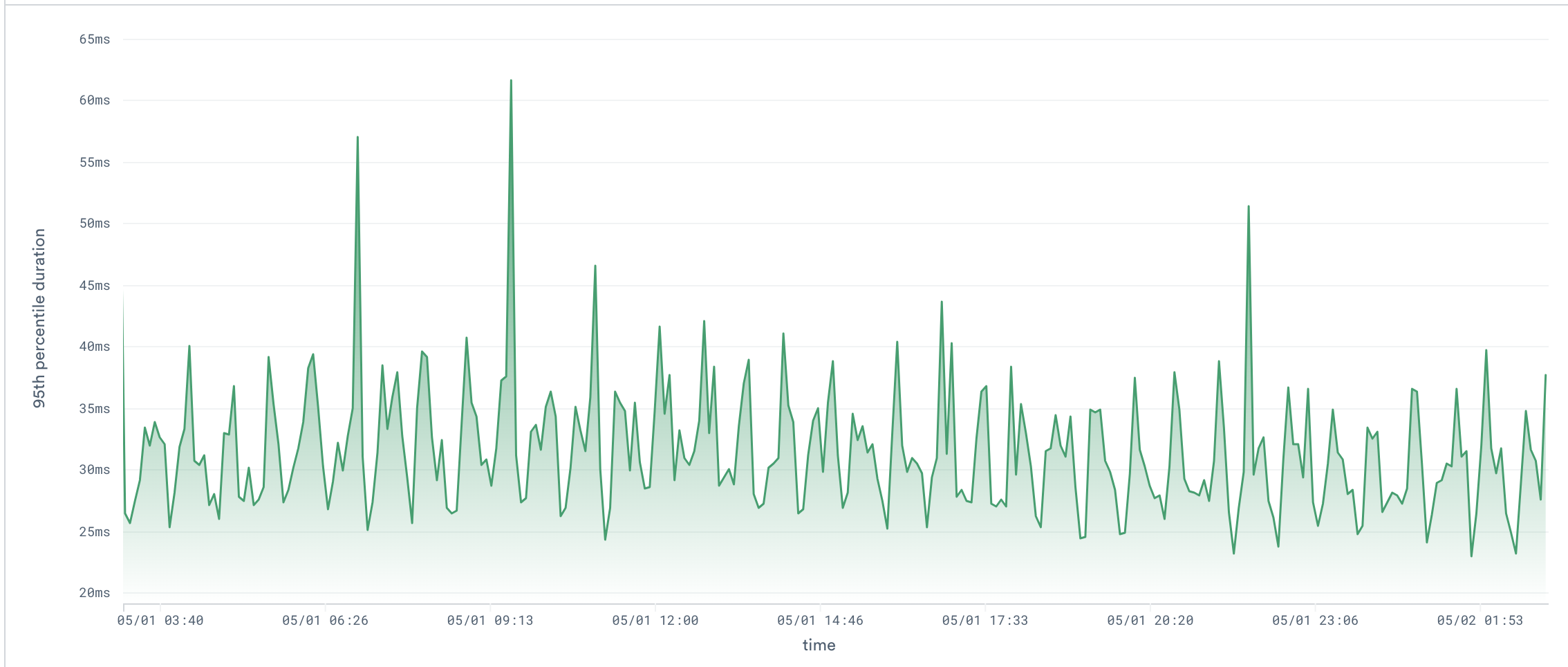

Suppose you have a Dataset containing all spans of your amazing online shop, and you want to visualize the 95th percentile duration of an operation called "PlaceOrder", which will help you figure out when placing orders has been slower than usual, and recognize trends/patterns or simply investigate an issue that happened in the system.
You would like to see something like this:

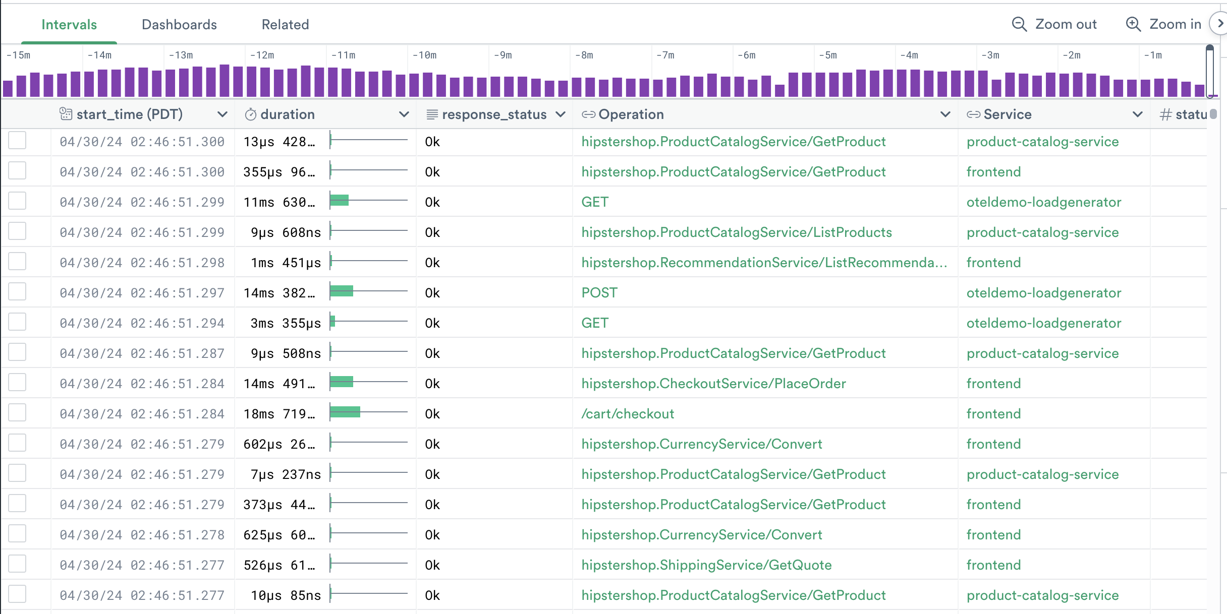

Our starting Dataset looks like this:

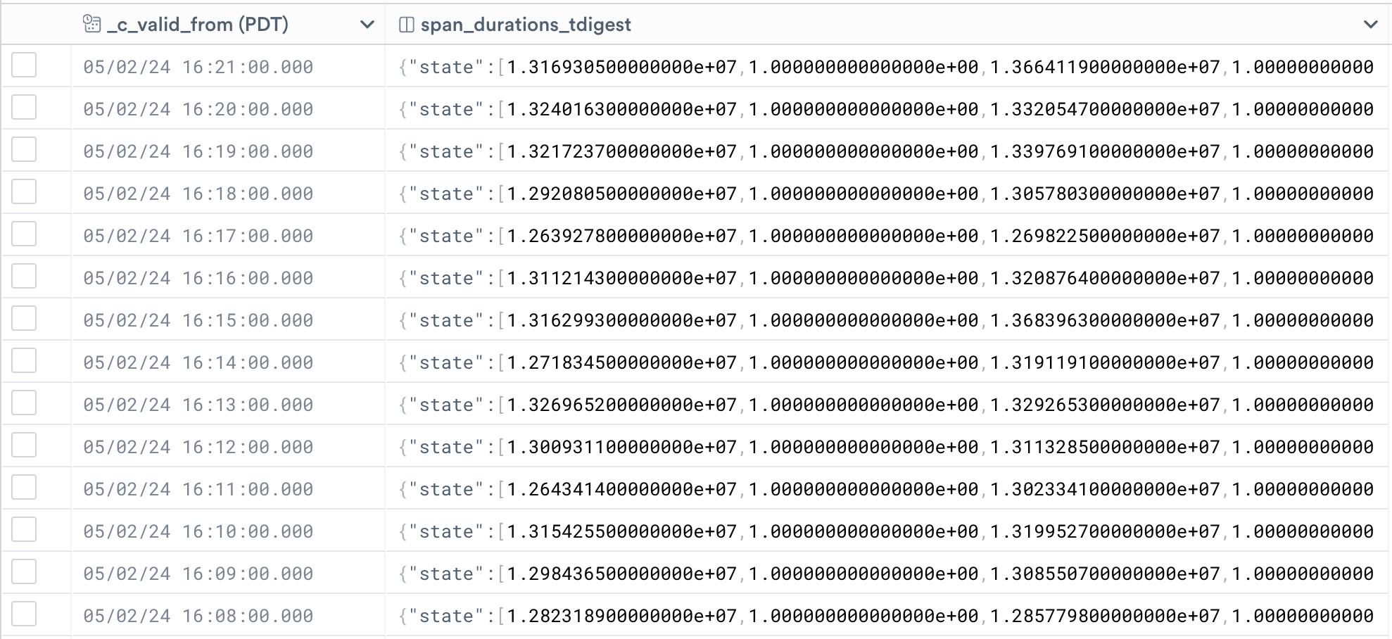

Let's then create a time series with a tdigest value each second:
timechart 1s, span_durations_tdigest:tdigest_agg(duration), group_by()
timechartwithout group_by() uses the keys as default grouping. Without group_by(), we would have a different time bin per span ID. This is not what we want, as the goal of this step is to combine durations of all spans within a time bin. To override grouping by the default grouping keys, we add group_by() without arguments.In real use cases, you could group_by() production environments, cluster, or any other differentiator you might be interested in.
Our dataset now contains time buckets of 1s each, with a tdigest state summarizing all durations of the selected span that happened within the time bucket.

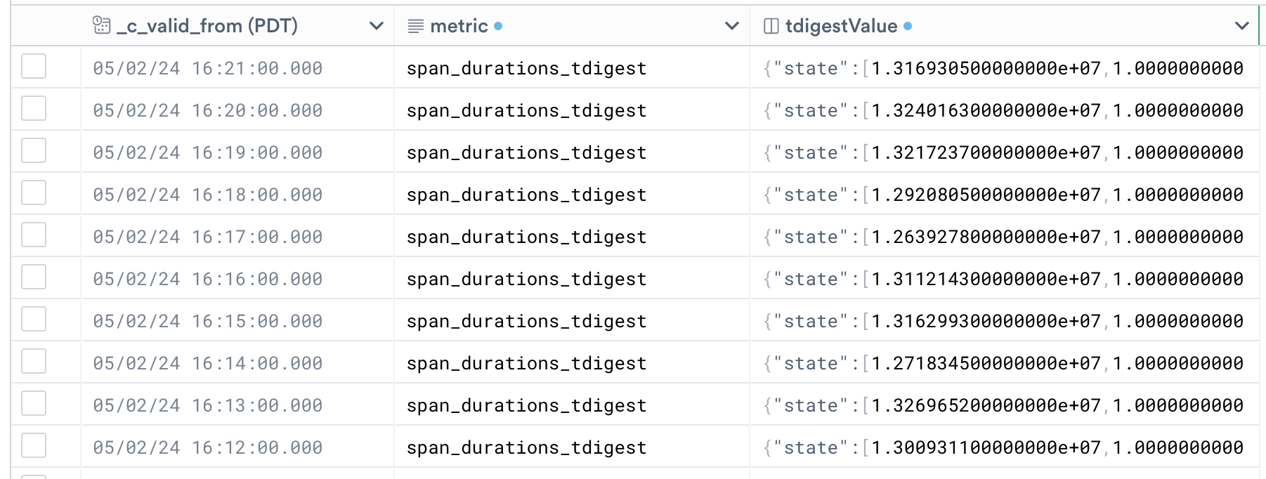

Now we need to give this time series a name and turn the dataset into a metric dataset, to unlock the full power of metrics. There are various ways to do this, the most intuitive way is the following:
unpivot "metric", "tdigestValue", span_durations_tdigest

Noteunpivot turns a wide format dataset into a narrow-format one. In particular, it puts all values of one or more columns into a single column called tdigestValue (in this case, only values from the span_durations_tdigest column), and maintains the information about "which column this value belonged to" into a column called metric. The outcome is that the name of the column used in timechart will become the metric name!
make_event is once again necessary, since the output of unpivot is of type "interval", whereas metrics must be events.

You can now visualize the order placement latency at any point in time, without having to re-aggregate all the spans!

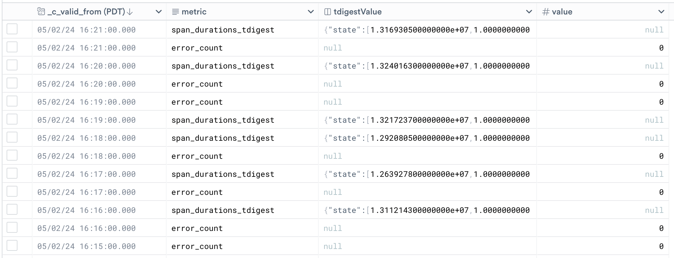

Let's then add it to the unpivot statement:
unpivot "metric", "value_variant", span_durations_tdigest, error_count
The "value_variant" column is a variant, and it contains both tdigest and float64 values.
Since we want to adhere to the "metric" interface, and given that we have both tdigest and float64 metrics in this dataset, we must have a float64 "value" column and a tdigest "tdigestValue" column.
To do so, we can use the following conditional OPAL:
make_col value:if(metric = "error_count", float64(value_variant), float64_null())
make_col tdigestValue:if(metric = "span_durations_tdigest", tdigest(value_variant), tdigest_null())
make_event
This will create a "value" column, which is populated with the (float64) value contained in the "value_variant" column only when the metric is a float64 metric. Otherwise it will contain null. The same applies for the "tdigestValue" column, which will contain the (tdigest) value contained in the "value_variant" column only when the metric is "span_durations_tdigest" (which we know is of type tdigest), otherwise null.
