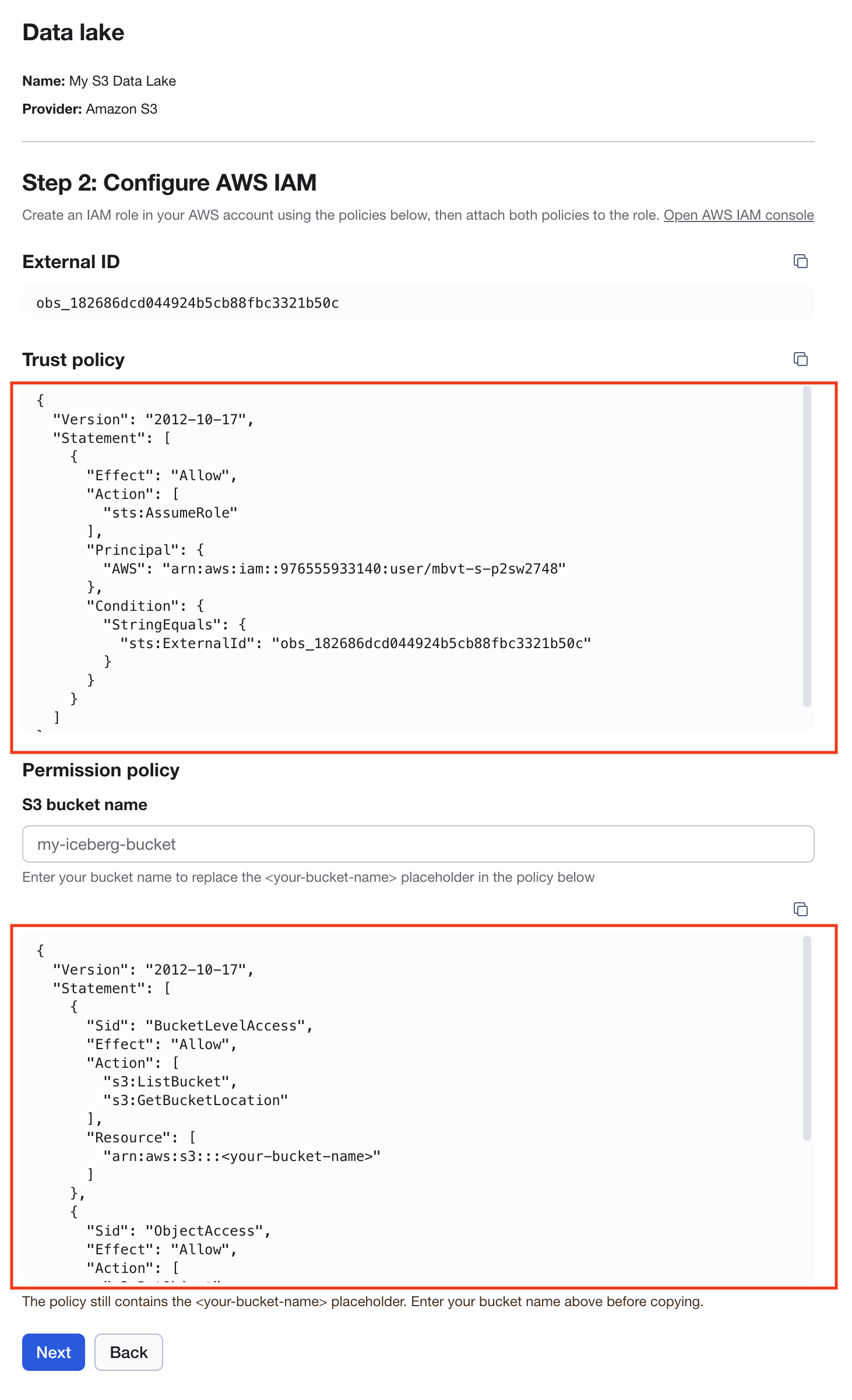

- Click Next. You will see the trust and permission policies provided here to create an IAM role.

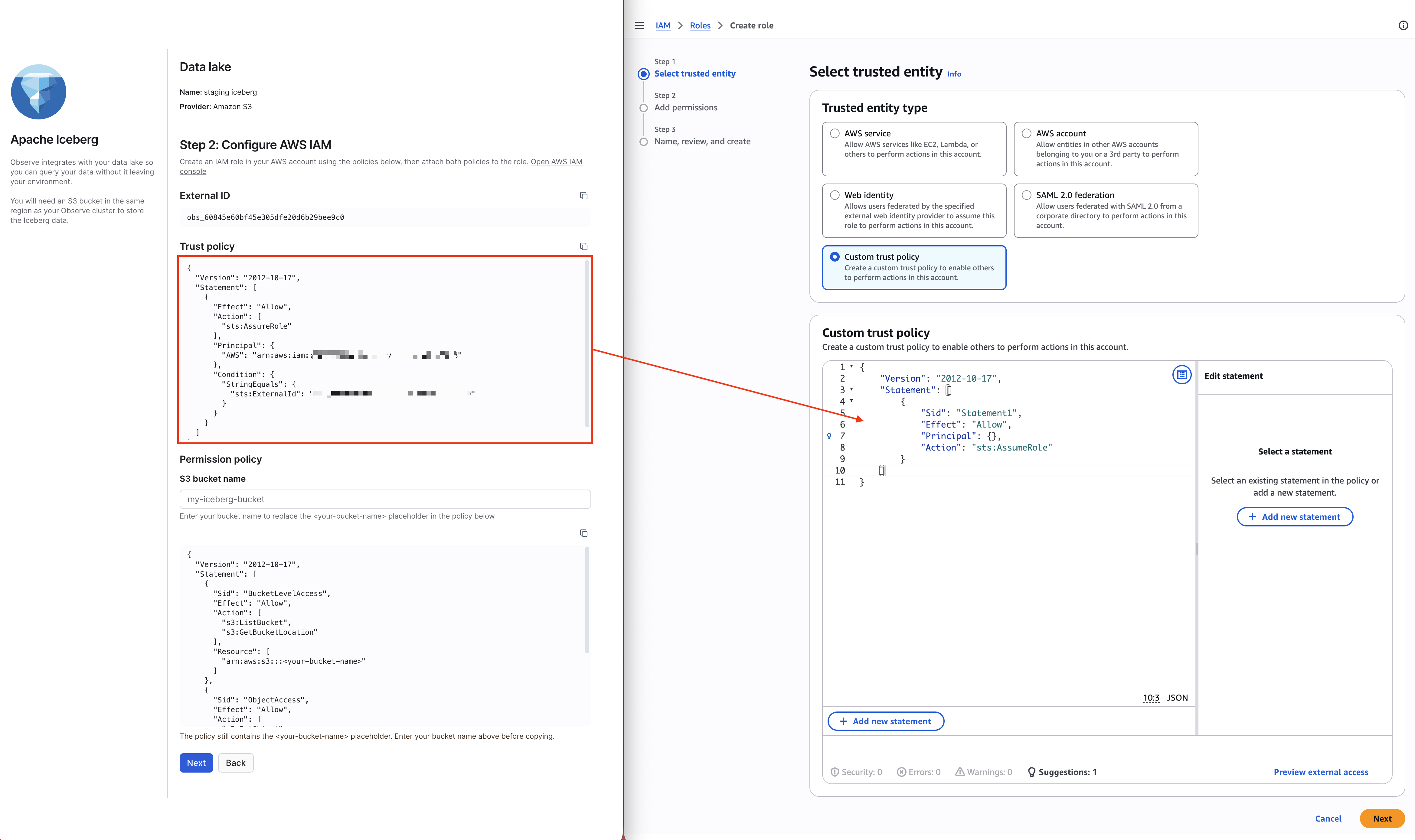

NoteMake a note of the external ID provided. Creating an IAM role in this manner can take some time. If you need to leave and return to the Observe by Snowflake UI later, you will need to provide the external ID in order to return to the same session.
- Click the Open AWS IAM console link.
- Choose the Custom trust policy card.
- Paste the trust policy from Observe by Snowflake into AWS as the new custom trust policy.
- In AWS, click Next.

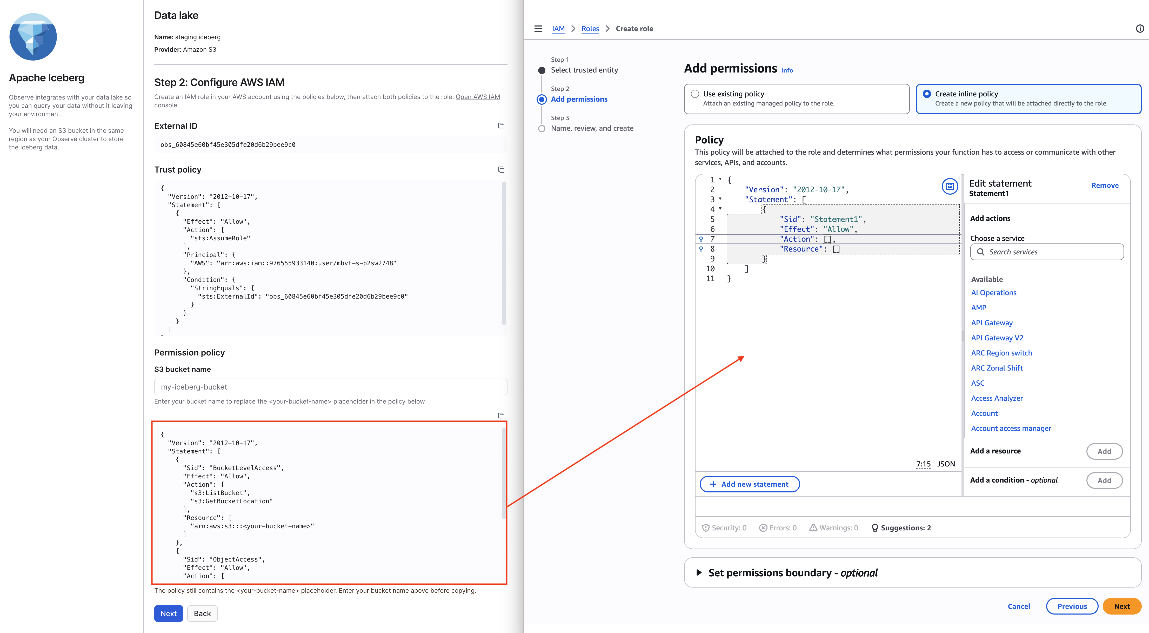

- Click Create inline policy.
- Copy the permission policy from Observe by Snowflake and paste it into the Policy Editor. The
<your-bucket-name>placeholder appears twice in the policy, be sure to replace both placeholders with the actual name of your S3 bucket.
- Give your permission policy a name, then click Create policy.

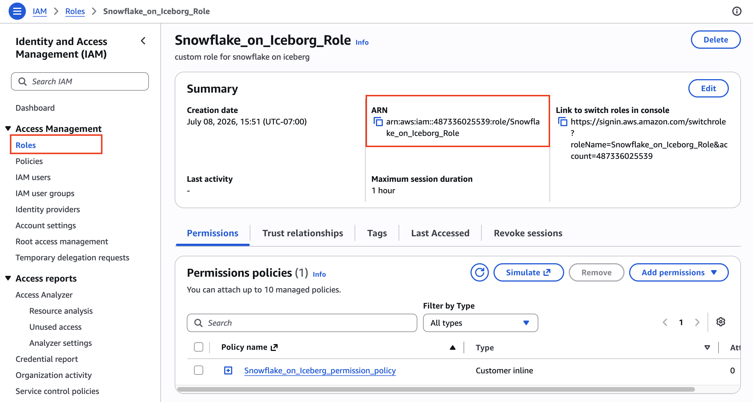

The ARN of the IAM role you just created. To find this, click on IAM in your AWS Console, then click Roles, then click on your role name.
