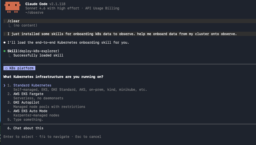

deploy-k8s-explorer
The example shown here is with Claude Code, but this works for any AI agent. The skill parallels the information collected in the Add Data portal, just collected from your command line/agent.

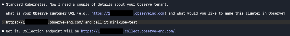

Information gathering

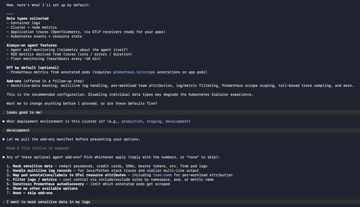

The skill will first ask a series of questions to understand what you're looking to set up.
You'll get the chance to set up any extra add-ons you desire. For example, you may choose to mask sensitive data.

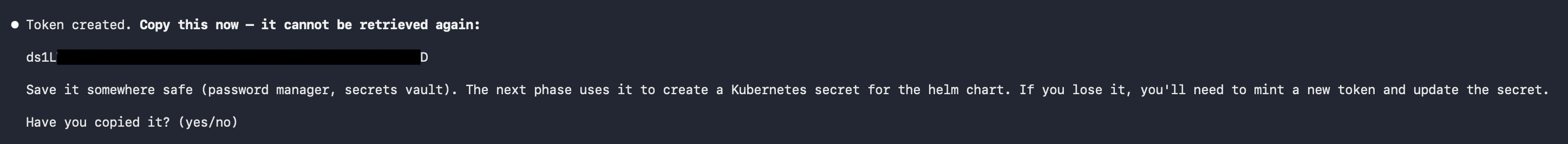

Observe by Snowflake backend setup
After your configuration has been decided, the skill will set up the Observe by Snowflake backend objects needed to collect your data. It will create a token for you to save for future use.

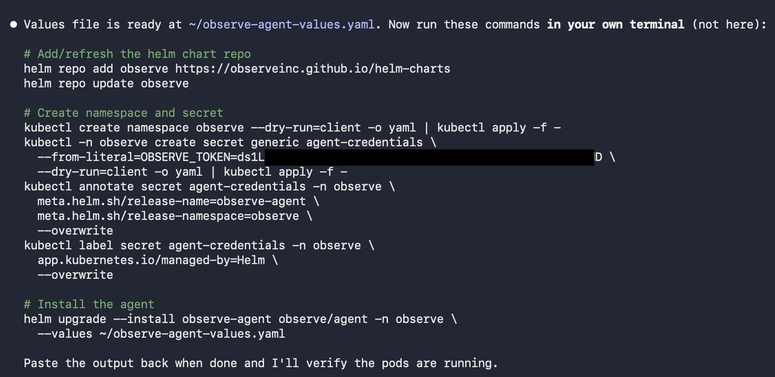

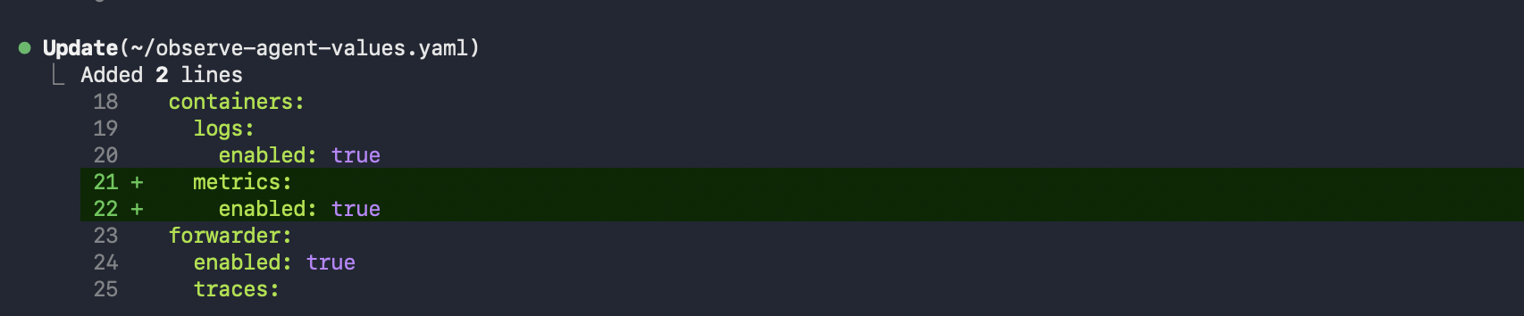

Kubernetes setup
We use a helm chart to configure the Kubernetes Agent. The skill will write a values.yaml file to match how you've configured the agent.
The skill will then prompt you to run some helm instructions to set up collection. Note that the skill is programmed to not run these instructions itself, to prevent unintended infrastructure changes.

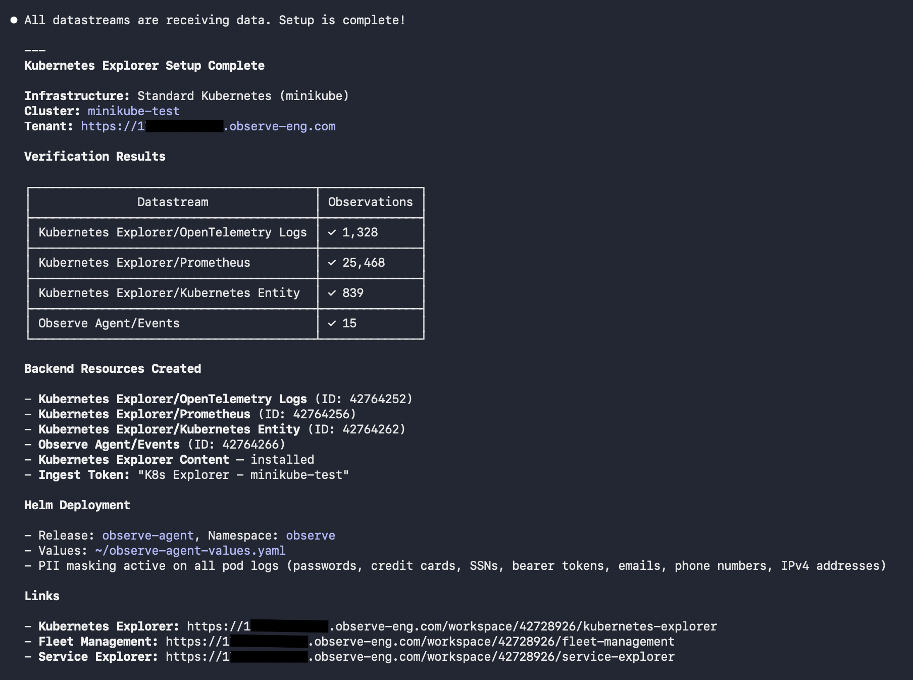

Verification
After all resources have been installed, the skill will check that data is flowing, and provide links to view your data.
